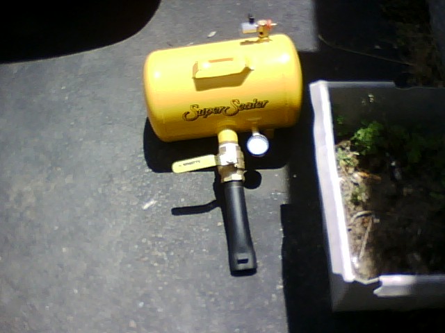

I bought myself one of these.. for when the tire doesn't want to seat. ;)
A big Attaboy for the DIY tire repair montelatici. :thumbsup:
What is it. I might want one.
/ 2 day old tractor front tire flat. #6
Get an old propane tank and a ball valve. Make your own.
