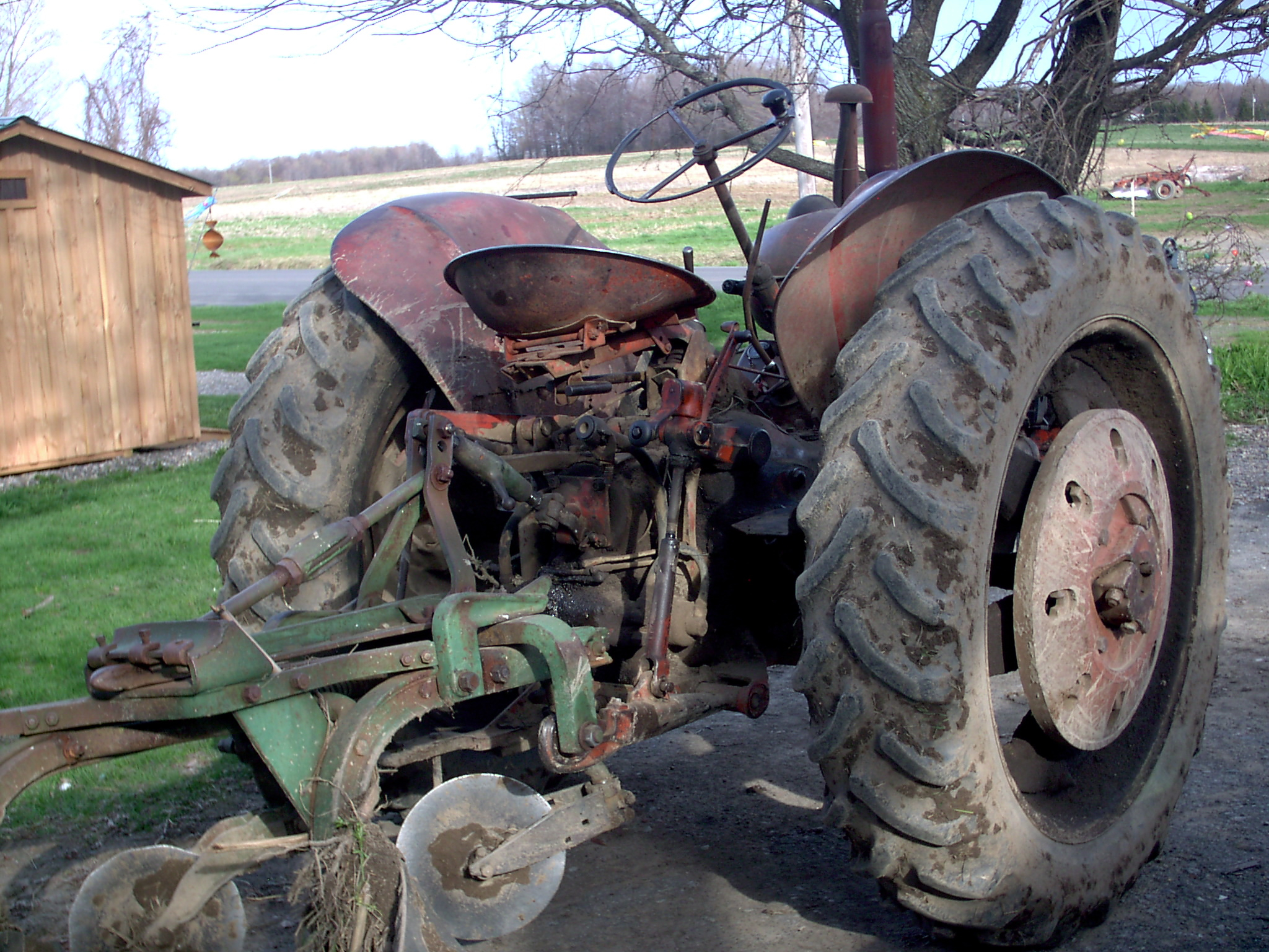

31.2 Horsepower
No, not in unbroken soil
In broken soil yah, but you need more Ooomph than that in virgin land.
I dropped a 16" two bottom in my unbroken soil last fall. It was a lot of effort for my 47 HP DK4710 to pull it. There were times it stopped my forward motion entirely, necessitating that I lift it.
As others have said, it depends on the soil type and condition as much as anything. Also, correct setup of plow and tractor is vital. I've been plowing with the outfit below for more than 50 years. It's a 1952 Case SC with a model BER 2-14 plow. 2WD, tires not loaded but steel weights on the wheels. Reports of the HP vary with the reporter, but I haven't seen any that claim more than 28.
I've plowed many acres of stubble and sod, which is what I think you mean by "virgin" land. About 30 acres of corn, oat, and sunflower stubble this year so far. I plow at 6-8 inches deep. Deeper or shallower and it doesn't turn over correctly, especially on sod ground. (that is why that depth is reccommended for a 14" bottom) Very dry and very wet soils are both harder to plow than moist. Row crop stubble is usually harder to plow than small grain. Weedy ground is more difficult than weed-free.
/ 2 bottom plow #28
Your rig is a refreshing breath of air!
