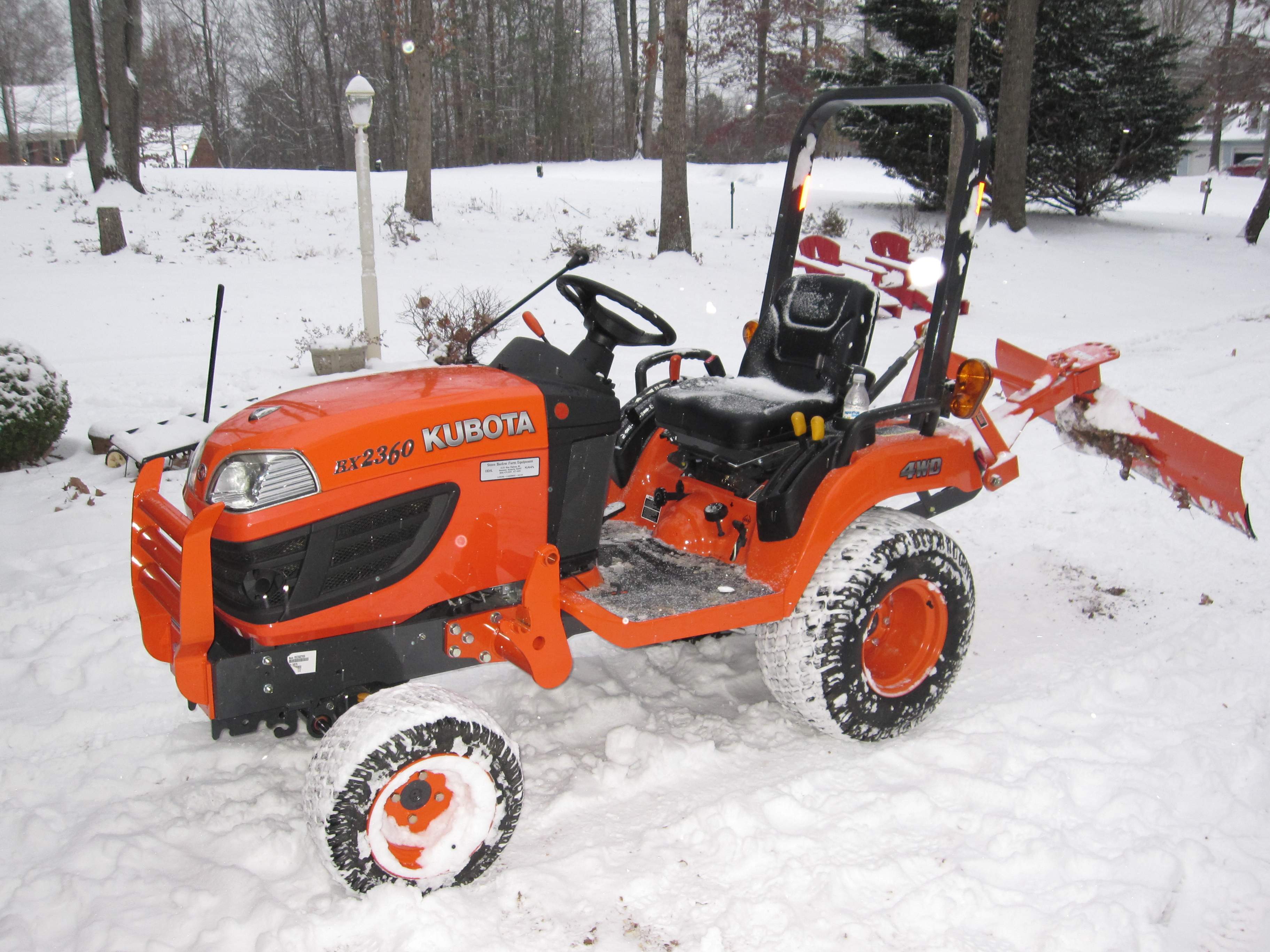

...and I plowed a bunch of driveways with my new BX2360 and a 4' TW rear blade. Never done anything like this before. It seemed to work pretty well if I pulled the snow forward, then reversed the blade and pushed the piles out the way as a cleanup.
What a machine!
PS I need some snow chains ASAP.
PPS I hesitated to label this weather event a 'storm' :)

I don't think you get a long enough duration of snow to justify chains.. That might be it for the rest of the winter in your location. Buy another implement with the money instead of the chains. :)

I'm with JohnK
you have marginal use for tire chains...
Turf tires are the best design for snow, ...
Try adding more weight to your blade or anywhere on the rear of the tractor... You should be able to get along great without chains even in deep snow... Now ice, thats where chains work best...
Just add weight. KennyV

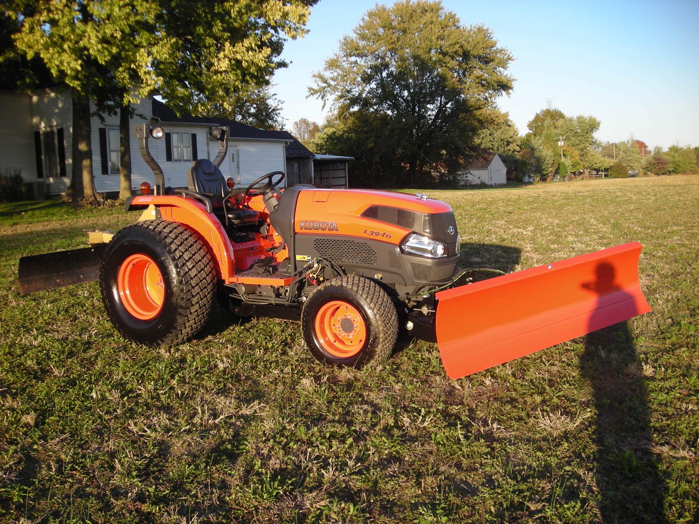

I have found that turfs work extrremely good in snow. Try pushing all your snow instead of pulling and see if that makes a difference. I know, it is a pain, but I did it for many years before I got my front blade. Philip.
