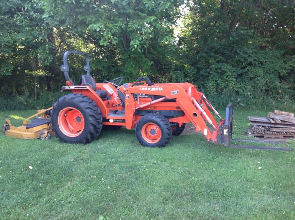

My wife and I purchased a 12 acre field about a year and a half ago that we look to eventually build on. Because I don't want to mow or farm 12 acres and love to deer hunt, my goal is to create as much deer habitat as possible complete with switchgrass, oak trees, orchard area and food plots. We'll have 2-3 acre home site when we eventually build. I freeze planted switchgrass last winter and while some is coming up, weed control is tough, so I decided to purchase my first tractor. Probably should've asked this before I bought, but I'm hoping I got a fair deal, as I had to make a quick decision. A local neighbor was getting rid of his Kubota and I just happened to come across it on Craigslist. He invited me out Monday night at 9:30 because he had a buyer coming from 3 hours away the next day and keeping it local was appealing. Plus he lived directly across from my in-laws for several years. I feel like he really did me a favor and gave me a great price but wanted to confirm. I got the following for $12,500. Is this a fair deal for the following?
2002 Kubota L4310HST 43HP Diesel 4WD
ONLY 643 hrs
FRONT LOADER Kubota LA 682 w/ Bucket and tooth bar
Woods 42" Pallet Forks model 20A
Woods 6' Rear Blade
Woods Rear Mount RD 7200 finish mower 6'
Woods BB72 Rotary Cutter BrushHog 6' (needs new gasket on crankcase)
I have limited experience with tractors. Just borrowed one when I tilled and freeze seeded the switchgrass, but am very excited about being a tractor owner and managing my piece of land. Any advice is appreciated.

G'day Mate and welcome to TBN from Downunder.
Enjoy the site.
I reckon you've got a fair deal on your rig and it's the perfect size/HP for your property & what you'll want to do with it. Have fun and go slow as you get familiar with it. And read your owner's manual back-to-front.

tractordata.com: TractorData.com Kubota L4310 tractor information
The L4310 is one of Kubota's 'Grand L' series. A heavy, robust, completely equipped tractor.
I have the smallest current Kubota 'Grand L', an L3560.
Surveys indicate that residential tractors are used an average of 80 engine hours per year.
The tractor you purchased has averaged just 46 hours per year.
Usually, residential tractor are lighter weight and do not have a suite of implements. Wood's implements are top quality, fully complementing your top quality Kubota.
GOOD BUY, especially from someone you know, who has cared for the machine. Still, I would change all the tractor fluids and filters soon, if it were newly mine. I would use up almost all the current diesel before filling, to be sure fuel is fresh. (Do not run all the fuel out, or it will not start.)

To the TBN forum Jsagraves. Sounds like you got a very good deal. Did he keep it in a shed or barn? Check all your hydro lines for wear and leaks.
Sounds like you have a great plan and a great start. Have fun and give us plenty of pictures as you go.

Good buy on a very nice tractor;more than capable for your work.Just follow all maintenance per the manual.
Use Kubota oils and filters.

A very nice price. Grats to you on your purchase.
/ 1st Tractor Purchase #8
I happen to think that you got a smoking deal on that setup. I would have bought that for that price, and I don't even need another tractor. Congrats!

Yup- if tractor works as intended, you are off to a running start. Nice machine, lots of useful attachments- you got lucky!
/ 1st Tractor Purchase #11
Welcome, you got a great deal with all those attachments and a 40 hp tractor with low hours! Perfect for your property and future plans. Good luck in the future.

I'm certainly no authority on the subject but I think you got a fantastic deal. For comparison I just bought a B2320 from a friend with a 4 ft brush hog, wheeled landscaping "York" rake, back blade, 60" belly mower, trailer mover, and ratchet rake for 13K. Mine is a 2013 with now 210 hours. I have a couple minor dents and dings and fading as it was not garage kept (it is now) but it is a machine, not a show piece.
You have a much bigger tractor with more expensive implements. To me, the hours are a wash as with care, your Grandkids will use it after you're gone. Another plus for both of us is knowing the previous owner. Don't think twice about whether you made a sound investment - you did great!
Keep the ROPS up and burn lots of diesel!
Congratulations!!
