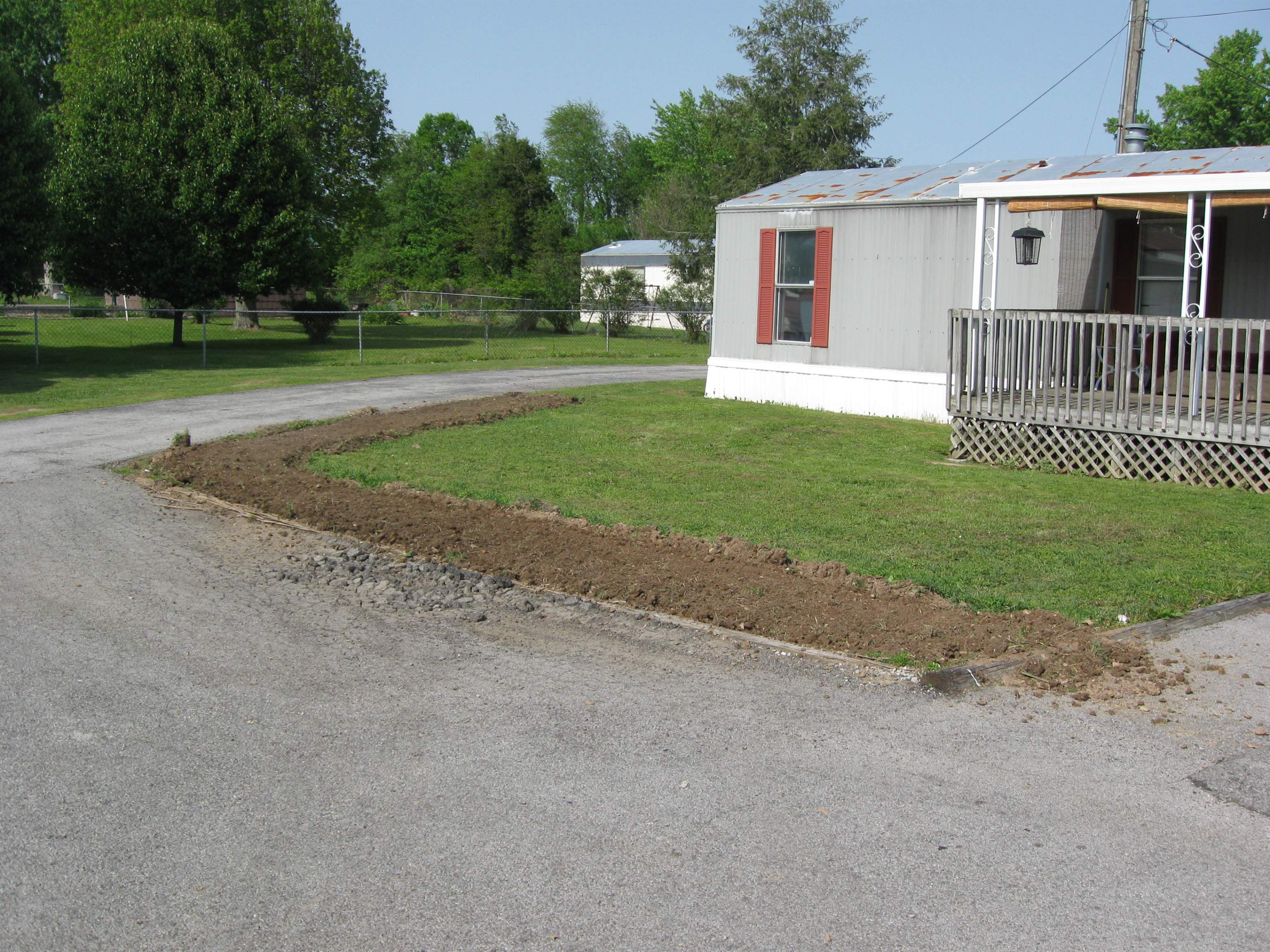

Finally got almost dry enough today to till my plowed area. I said almost. Another day or two would have been better/dryer but supposed to start raining again tomorrow for ever.:) To be able to plant by Mothers Day I figured it's now or maybe next year. Lots of rain.
I plowed in front of one rental unit and down the side for planting grasses and flowers and then the garden for some of the renters that wanted to garden. So, here's pictures of the plowed areas now tilled.

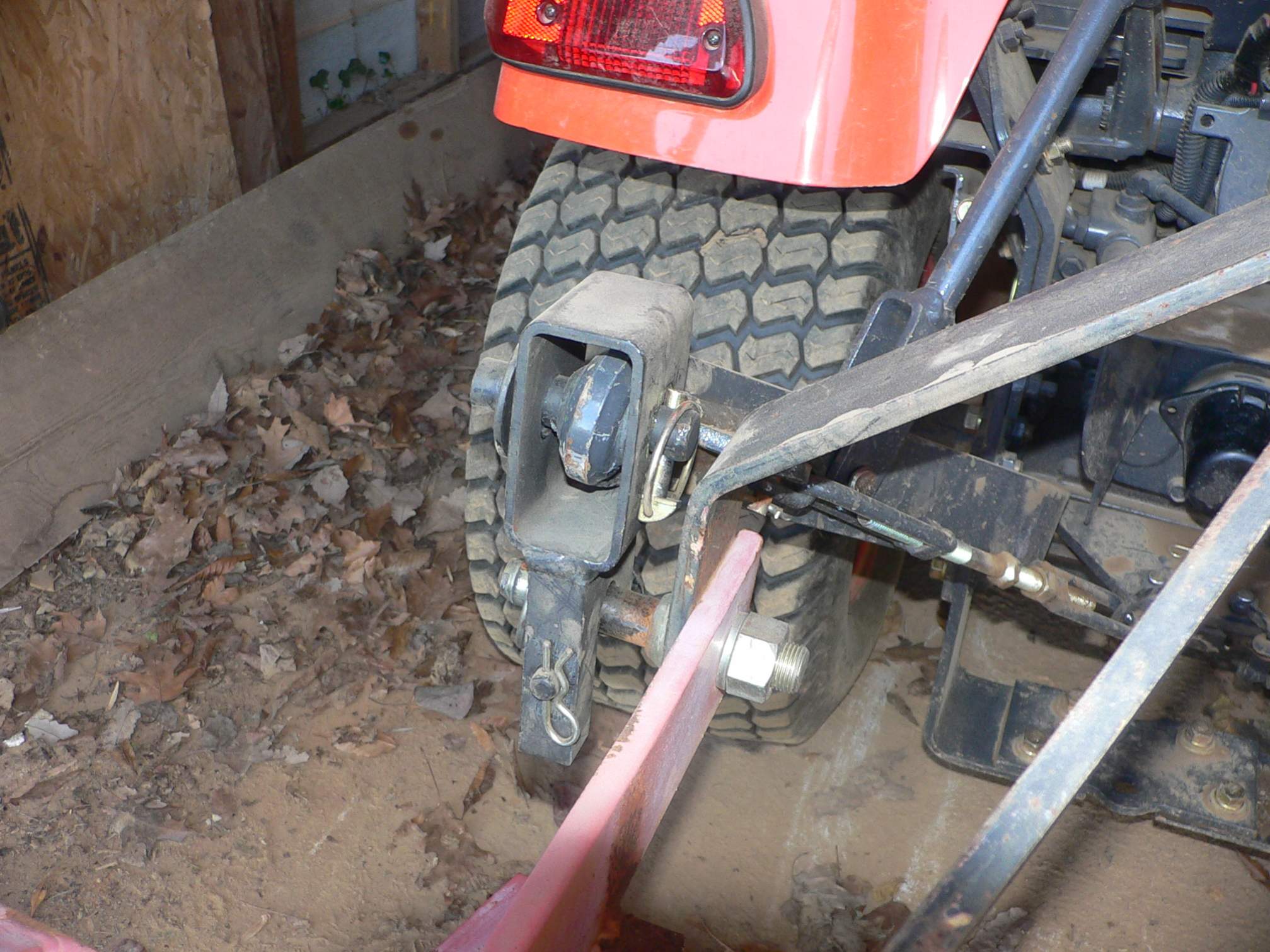

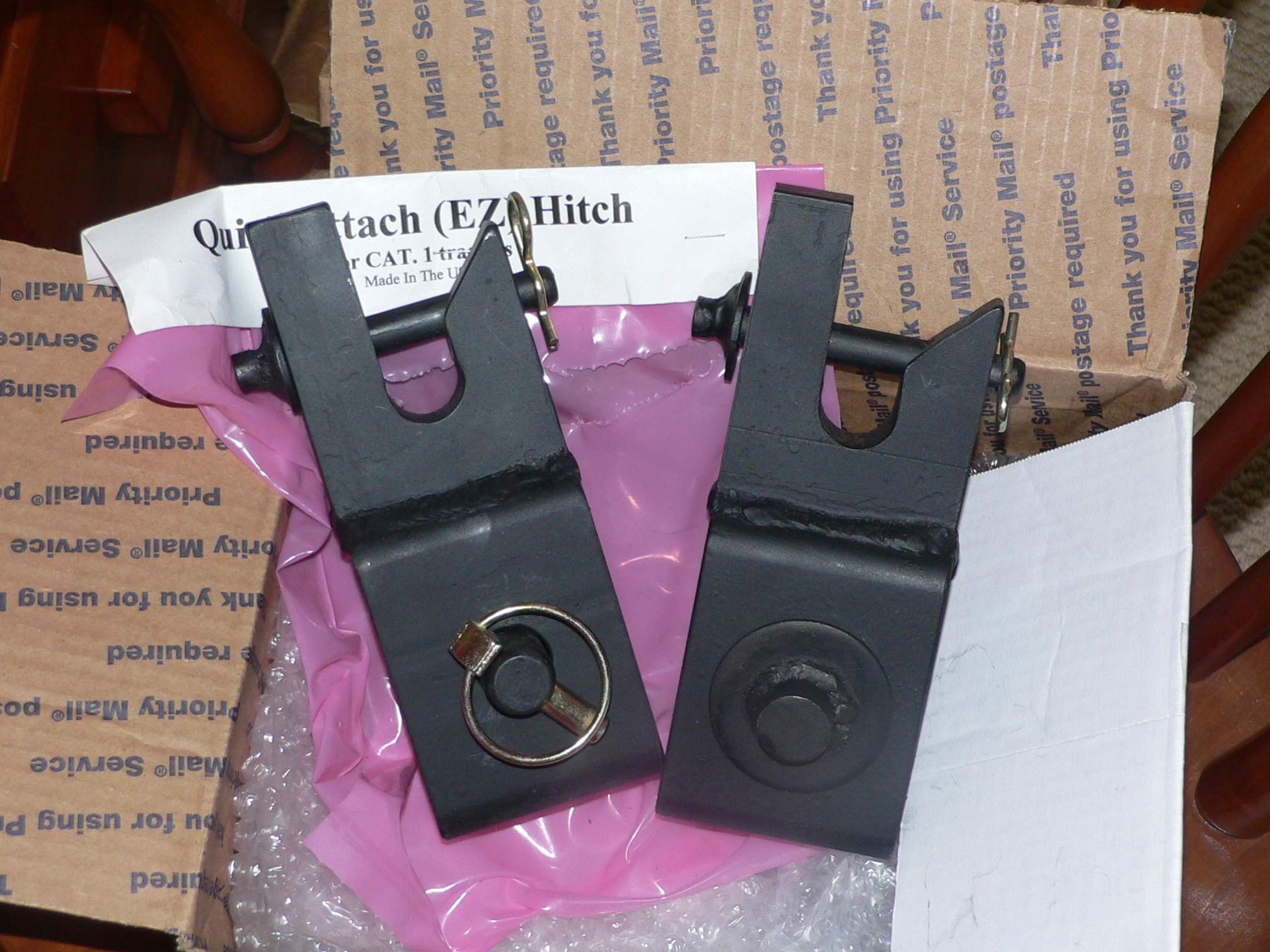

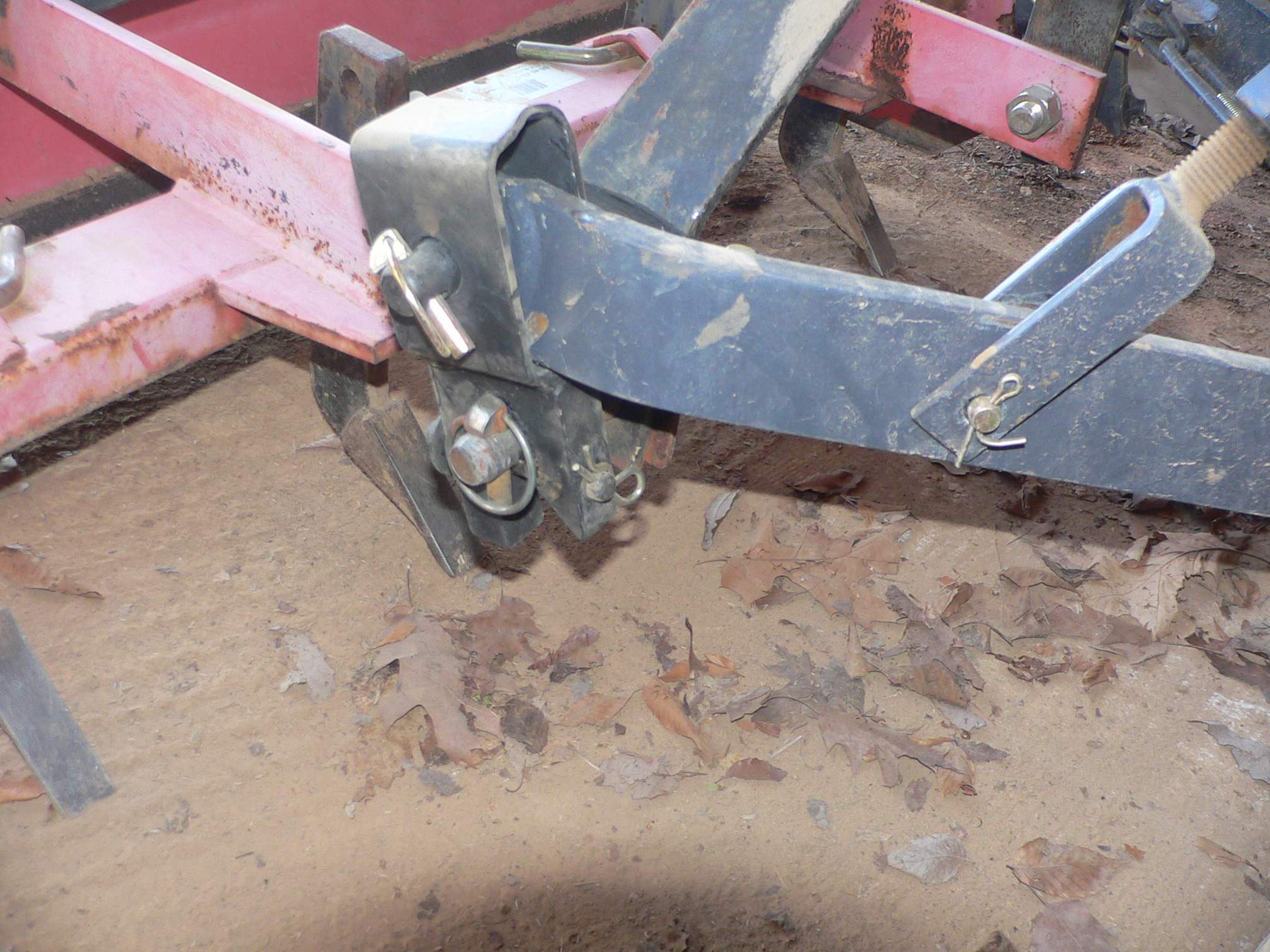

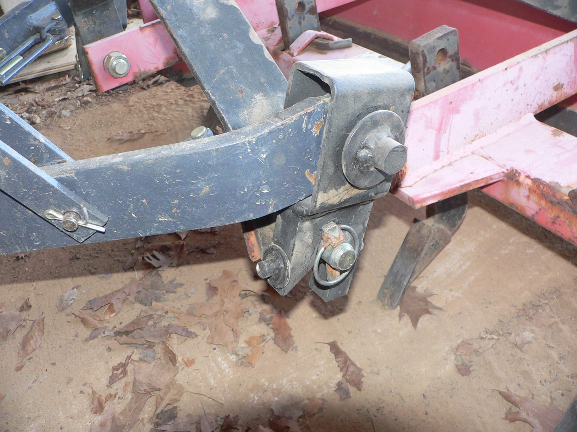

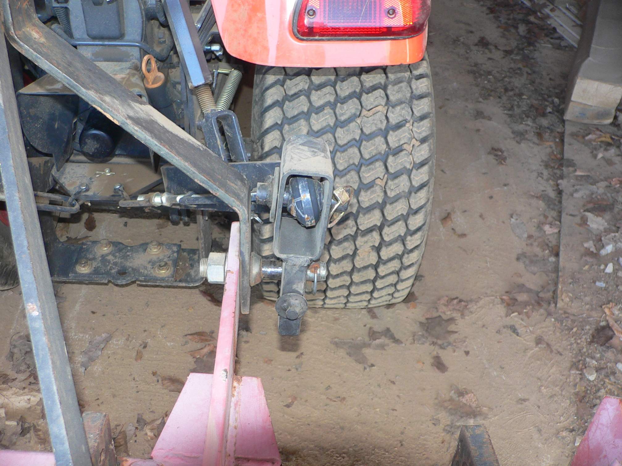

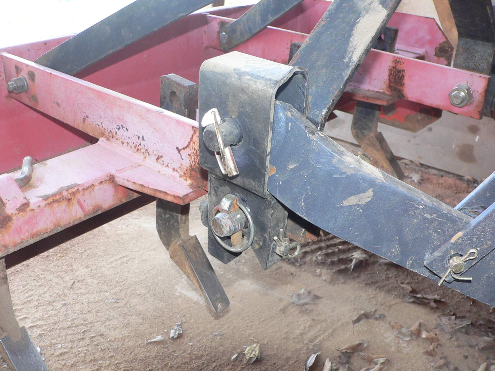

Only problem was I had the wrong quick hitches on. The ones that stick straight out worked fine for plow since I didn't use the PTO with it.:)
Hooked the tiller up, drove over to nearest patch needing tilled, of course I had an audience watching, engaged pto and the drive shaft came loose. Got off, unhooked tiller from 3ph arms, went over to the storage building, got QH's that go down or up, removed wrong QH's, installed right QH's, hooked 3ph arms with right QH's to tiller, installed drive shaft and tilled.
Pictures included of wrong and right QH's that I use for non PTO and PTO implements with the current drive shaft that I have. I'll just keep the "right" QH's on all the time now.

What tiller do you have? If you used it with your BX, how does it match up with 2320? Specifically, did you have to change the PTO shaft?:confused3:
I did not have to change the shaft but it's very close to being to short. When I used the quick hitches that extend out from the 3ph arms like Pats then the drive shaft was to short. By using the quick hitches that let the implement sit on top of the QH or under the QH the shaft works.
Pictures of tiller and QH's that work. QH's were uder $100 on eBay and made in Ky or Indiana.
