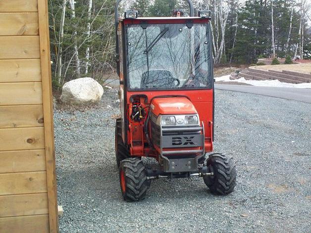

Junkman,
Here a photo of the curtis cab that you where looking for, on the other tread. I've got a bracket welded to the tractor to hold the valve on the tractor, which I use for the blower in the winter.
Hope this helps...
