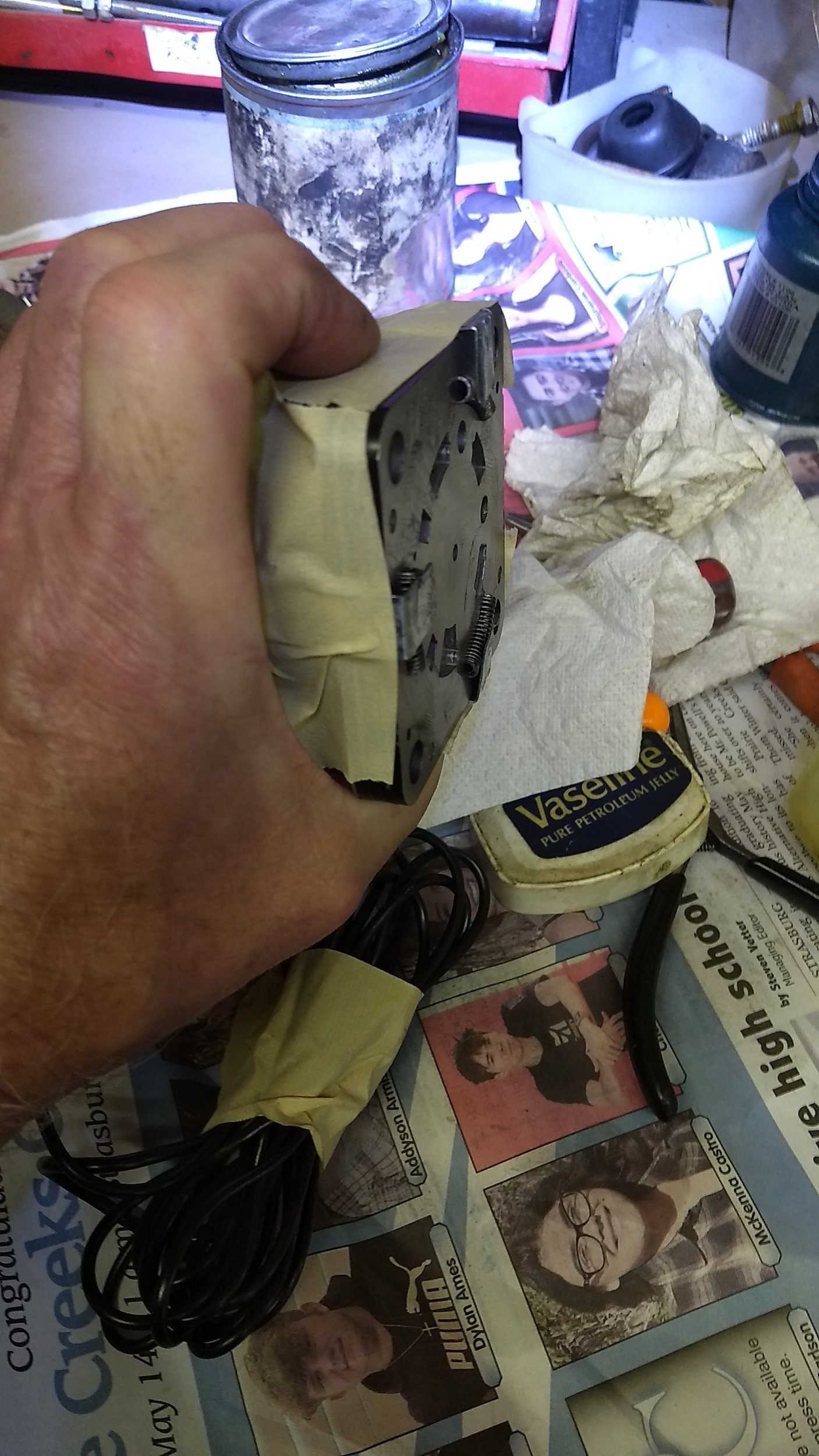

I rebuilt the steering box in my t5c this past summer due to excessive leaking and hard steering. It has a Hydraguide™ Hydrostatic Steering System. I used the HGF Series Service Procedure found in the Service Manual 2753. I ordered parts from QCC consisting of a bushing item 38 part no. 063042X1 and seal kit SK000097. I later found information that John Deere AM107078 seal kit is a substitute for Parker SK000097 seal kit but have not confirmed this. The procedure was fairly easy to follow but the springs inside the box were very hard to keep from flying off when opening the box up and even harder to keep in place during reassembly. Be aware that the 2 sets of 3 springs each are different lengths and go in different locations. Manual had no recommended way to hold the 3 problem springs in place during reassembly see attached IMG_20220618_171631188 showing my solution. If your steering box has item 52 a 9/32" steel ball be extra careful that the ball is in its chamber toward the center of the box when the item 2 Port Cover is reinstalled. My mistake was thinking that the ball would move freely from one end of the chamber to the other, this is not the case as I found out after reassembly and reinstalling the box on the tractor only to discover that the power part of the power steering was inoperative. After troubleshooting the steering pump and finding the pressure okay I had to remove the steering box and disassemble it and get that ball in the right location. The manual neglects to give this important detail in step 41A of the assembly instructions. After getting this check ball in the proper location the steering is working great with no leaks. Something to consider to save time and possibility of screw ups is skipping the steps on disassembly of the commutator, I considered carefully doing these steps but the thought doing the readjustment of this device seemed daunting and probably unnecessary as the commutator seemed to turn freely with no binding and since the box interior showed no metal or debris I elected not to do the commutator steps but that is your choice do it you want to do it. I did do a couple of things not called for in the manual which you may consider if you think it makes sense. I added a fitted grease seal where the steering shaft passes through the item 32 Upper Cover Plate. I also used a thin layer of silicone sealant between the shaft tube flange and item 32 Upper Cover Plate. My reasoning on doing this is I found corrosion damage in this area as seen in the photo (See attached IMG_20220615_171231059 for part # of seal). These boxes have a problem of oil leaking up the steering column and out from under the steering wheel this grease seal adds back up to the primary seal and along with the silicone sealant will help to keep water that may get into the shaft tube from entering the box. Good luck.
