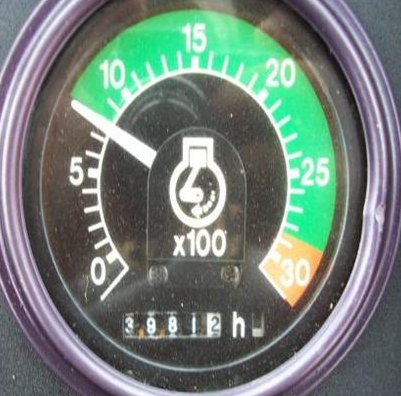

found the pic I was looking for. It is only a 5 digit display, now whether or not someone's toying with it......
/ 1990 JD 410c meter reading #8
sounds fishy, like the meter got replaced and no one ever kept a sticker or something that said at "add this many Hours" or something. No way a utility only got 1000 hrs. Also, it is 2wd which I doubt you will be happy with if you plan on any loader work. 2wd is fine for utility companies on asphalt all the time, but what you plan on doing could be different. And unless thr machine actually has 1055 on, price is high.
