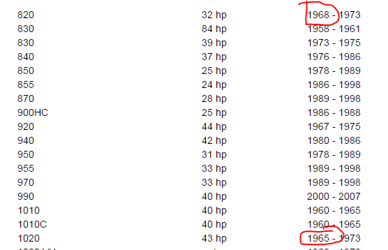

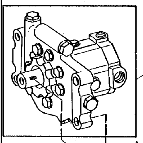

Sorry but I disagree with you as all 1020's were closed center hyd's. Granted earlier 1020's had open center steering with a gear pump mounted to RH frt of engine,a gear trans pump that oiled trans then supplied oil to frt CC pump but 3 pt hitch and all other hyd functions were closed center. Photo of CC pump below. I sold 1020's when they were new plus served as a JD dealer service manager for over 10 yrs so I'm fairly well versed on a model 1020. JD did build some other 3 cyl utility tractors for N American sales that were open center(820,830 & early 2040)

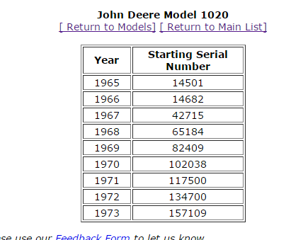

SORRY George but the bursted bubble is 1020 utility's with closed center hyd's were according to Tractordata & other sources built 3 yrs before 820 utility's with open center hyd's. TRY AGAIN and you have a good day anyhow!!!!!!!!!!!!
