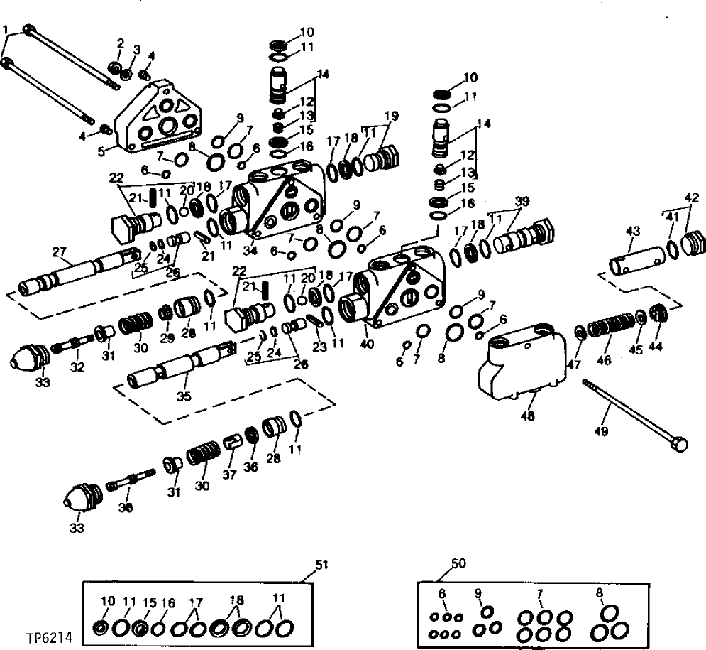

Local cemetery has this tractor with a leaky loader control valve. Shop states that the valve is worn and not repairable. What valve will work as a replacement?:)

2 different loader for this machine. The 7300 and 7320 loader. The 7300 had just a conventional remote mounted valve that should be easy enough to get an aftermarket valve if the leak is too much. Not much you can do with that valve other than toss it. The 7320 used a setup more similar to later model units that have a stacked valve formation but again not much you can do with those either both valves where class fit (individually matched spools to valve housing) but parts are still available although very spendy. Is the unit expensive vs the amount of oil it is losing?

This is a joy stick control. We tried a replacement valve (generic) that a local hydraulic shop supplied. The flow seems to be restricted. We tried the new valve in open center mode and closed center (power beyond) mode with the same result. How any gallons per minute does this sytem have the capacity to displace?

I had this system checked out today at a reputable truck repair shop where they have the ability to check pressure and flow. They state that the original equipment valve, tested on the tractor, flows 22 gpm at 2900 psi. Also that this is a open center system. The JD manual that we have for this unit states that the valve has two relief valves. One is set at 1500 PSI and the other at 2750 psi. Could this mean that the flow throught the valve is through the 1500 psi circuit and that when the lever actuates a circuit the valve changes to the 2750 psi relief? I appreciate everyone's help. There are no JD mechanics around here that are able to remember how this system was designed. Thanks
/ 1972 JD 300 backhoe and loader-hydraulic problem #9
The truck repair shop is incorrect. There were no open-center hyd JD 300's built. All were closed center. Normally 2400 psi is the maximum the stand-by psi should be set or seals/o-rings will begin to blow. This is from Tractordata.

Now it is getting interesting. The parts book for this loader on JD 300 tractor with 7320 loader (PC-1111-(May-69) shows one relief valve. The JD operators manuel for the JD300-A and JD400-A (OML27245 Issue A1) shows a picture of the valve for the 400 series and states that the valve has two reliefs. Are the 300 series and the 400 series valves the same?

After being employed at a JD dealer for over 20 yrs('66-'87) I know that JD 300 tractor is painted ind. yellow from the factory and is indeed closed-center hyd's.
I got the stat's I posted from "Tractordata.com"
This is what the hyd pump should look like in a 300
According to JDparts.com(parts cat #1111 - JD300 (7320) Loader - 07Nov01) the relief valve in a 300 with a 7320 loader the relief valve AU40752 is used in these models which includes 400.

What are you referring to as the "accumulator pressure cut on psi" & "unloader circuit"? Closed center hyd systems such as the JD 300 have stroke control & pressure control valves. Parts keys # 42,43 & 44 comprise the stroke control valve in the larger pump in a 300 in the photo

Getting back to my original problem with my yellow iron. The factory assembled this loader (7320) with a valve that has two reliefs. A newly purchased and hydraulic shop recommended a dual spool valve that is rated at 20 gpm operating in closed center manner at less than 3000 psi stresses the engine so much that the tractor wil not motivate down the road and heats up. The rpms will not tach up and the engine sounds labored. What type of valve can be used as a replacement that will let us enjoy our yellow iron to its fullest capacity? Engine was professionally rebuilt recently. With the original, leaky valve the machine operates as it should. Please help, as I really appreciate the help.

First thing does the "new valve" have built in relief valves? If so they could be popping open at a pressure lower that the stand-by pressure is set. 2nd thing I would do is disconnect the the newly installed valve "return hose" at reservoir and aim this hose in the hyd filler hole and start engine. If oil squirts out of hose either the relief valves(if equipped)aren't holding stand-by psi or valve is an "open center not a closed center valve". As far as relief valves go on a closed center system they are only required to help keep from bending parts on things such as backhoe. HTH's,Jim
PS: My purpose for posting photo's of other hyd components was to try and "explain a closed center system"

The new valve has one relief. It is adjustable externally and is located nest the input spool. I don't understan the theory of the old valve having two reliefs. What is making the engine labor so hard? I appreciuate your insight.
/ 1972 JD 300 backhoe and loader-hydraulic problem #19
If the NEW valve is bypassing enough quantity of oil such as a bypassing relief valve or an open center valve it can cause the hyd pump to load engine. Did you do the checks I suggested?? If not then we can discuss this till the HOT place opposite from Heaven freezes over and not arrive at a resolution. If you would like to call me my # is 8one7*five1seven*1five9
