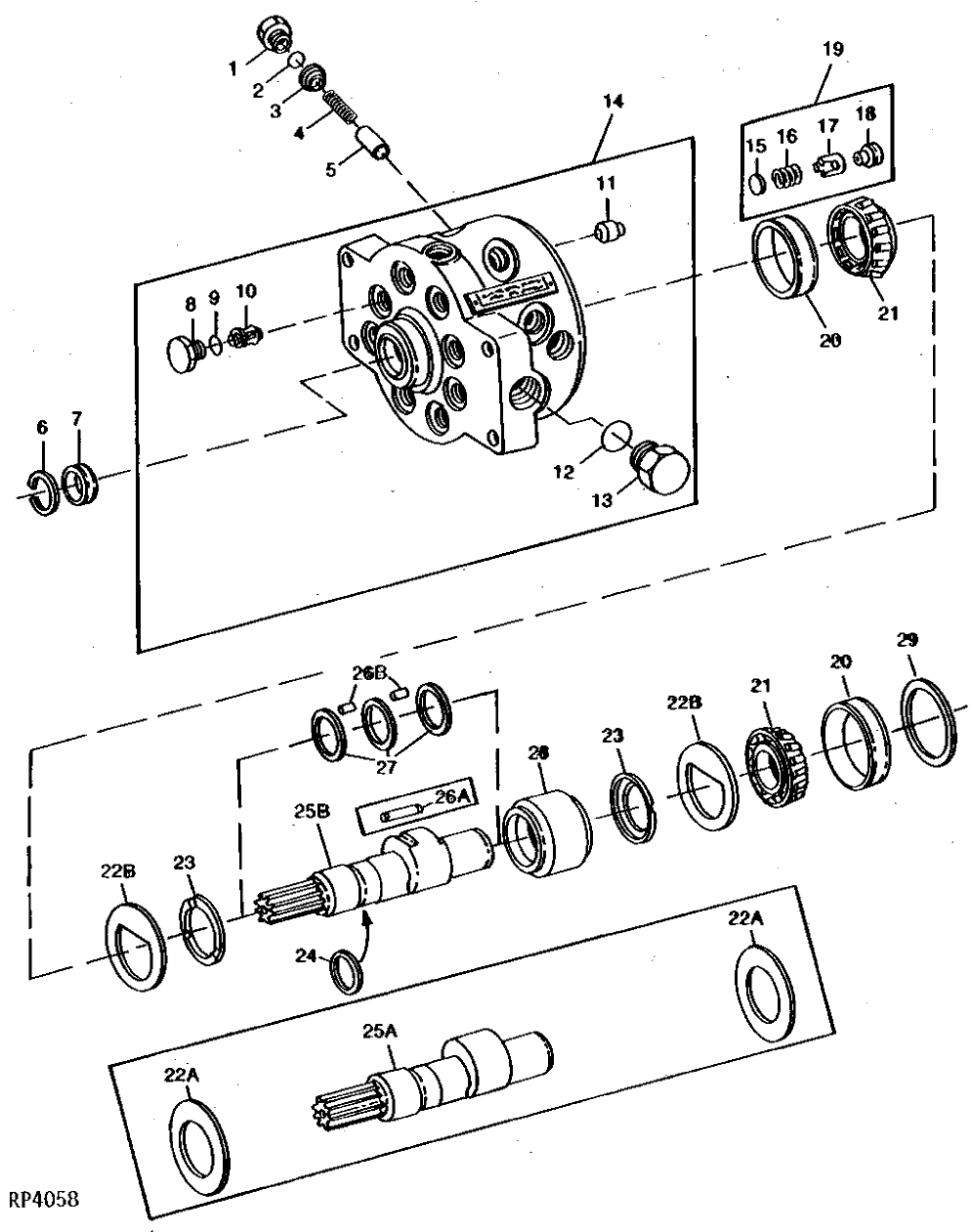

This is what the hyd pump should look like in a 300

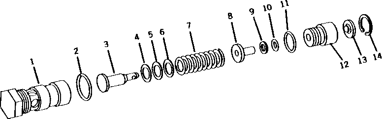

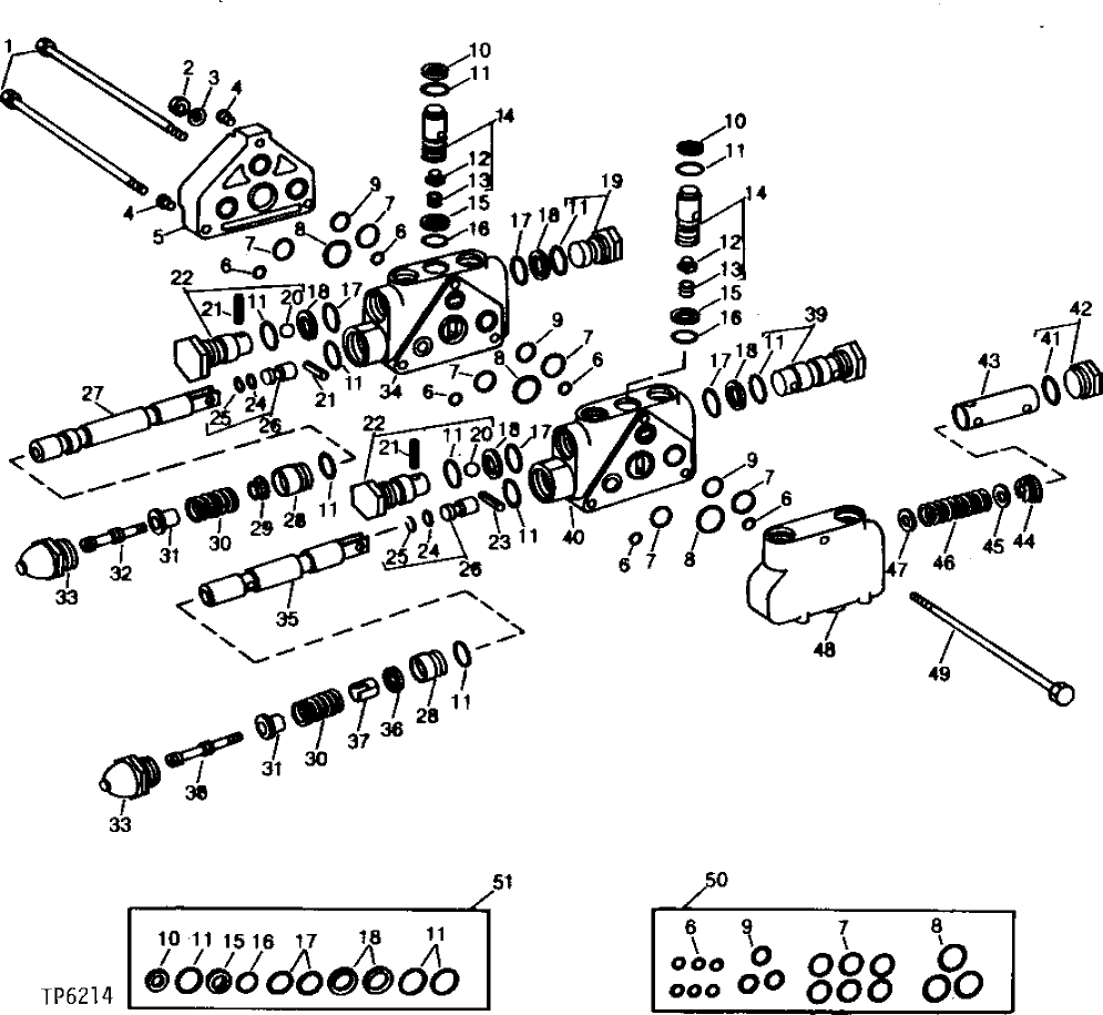

Are the 300 series and the 400 series valves the same?
According to JDparts.com(parts cat #1111 - JD300 (7320) Loader - 07Nov01) the relief valve in a 300 with a 7320 loader the relief valve AU40752 is used in these models which includes 400.

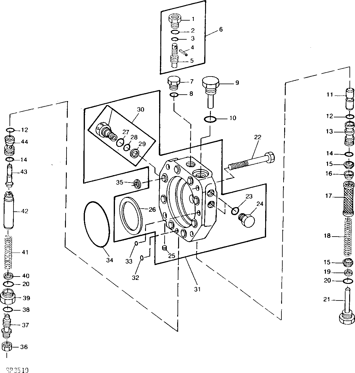

What are you referring to as the "accumulator pressure cut on psi" & "unloader circuit"? Closed center hyd systems such as the JD 300 have stroke control & pressure control valves. Parts keys # 42,43 & 44 comprise the stroke control valve in the larger pump in a 300 in the photo
