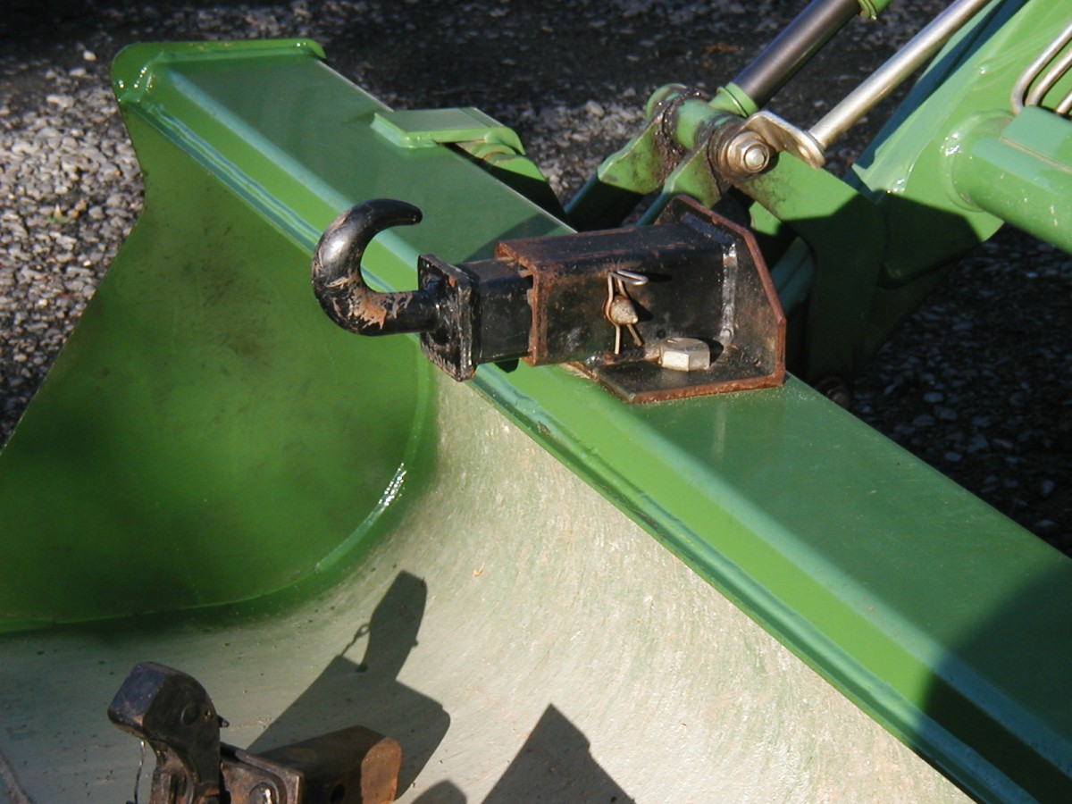

This is deviating from the 1850 thread, but it still addresses the bucket, and it's usefullness .
Tim,
Why not look for a LMB locally, and just add the PT plate to it. If you have welding skills, you might be able to make one to your satisfaction, with extra hooks and 2 in receiver hitch, etc.
