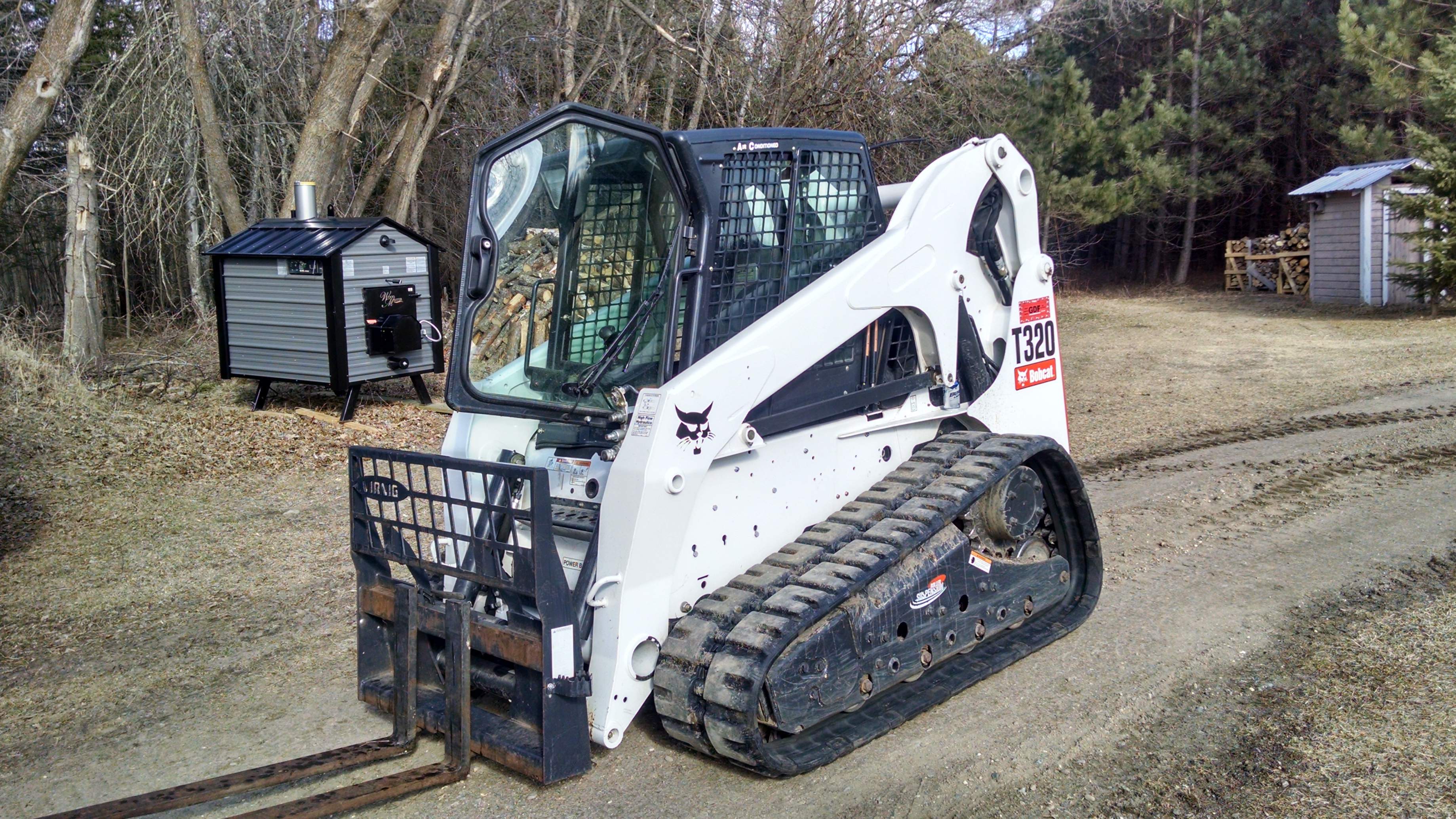

Borrowed this to move the wood stove, rated for #3300 lift, it's a brute.

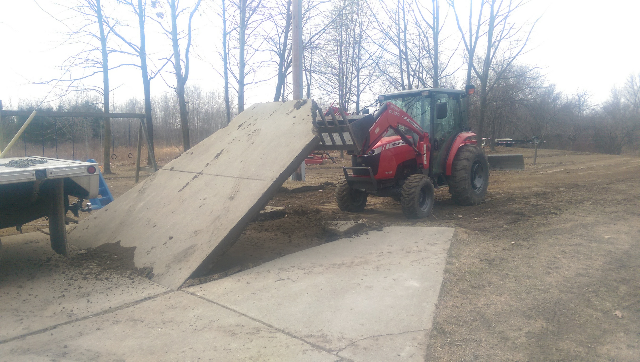

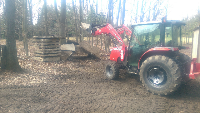

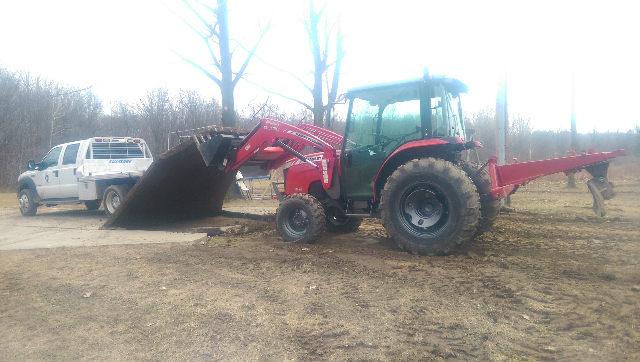

Woblin ... AGCO just switched suppliers for the loaders. Soo Tractor (Radius Steel Fabrication, Sioux City, IA) was the previous supplier. They made your DL120, my DL130, and the rest of the MF, AGCO, CAT Challenger, etc loaders. Now, they are using ALO-Quicke. No one has seen the official specs yet for the new DL135. I had found something that suggested the weight capacity dropped a bit. But, the DL95, which replaced the DL100, is rated for more weight than the 100.
I agree that MF underrates their loaders ... I am continually impressed with mine. Here's some shots from today:
