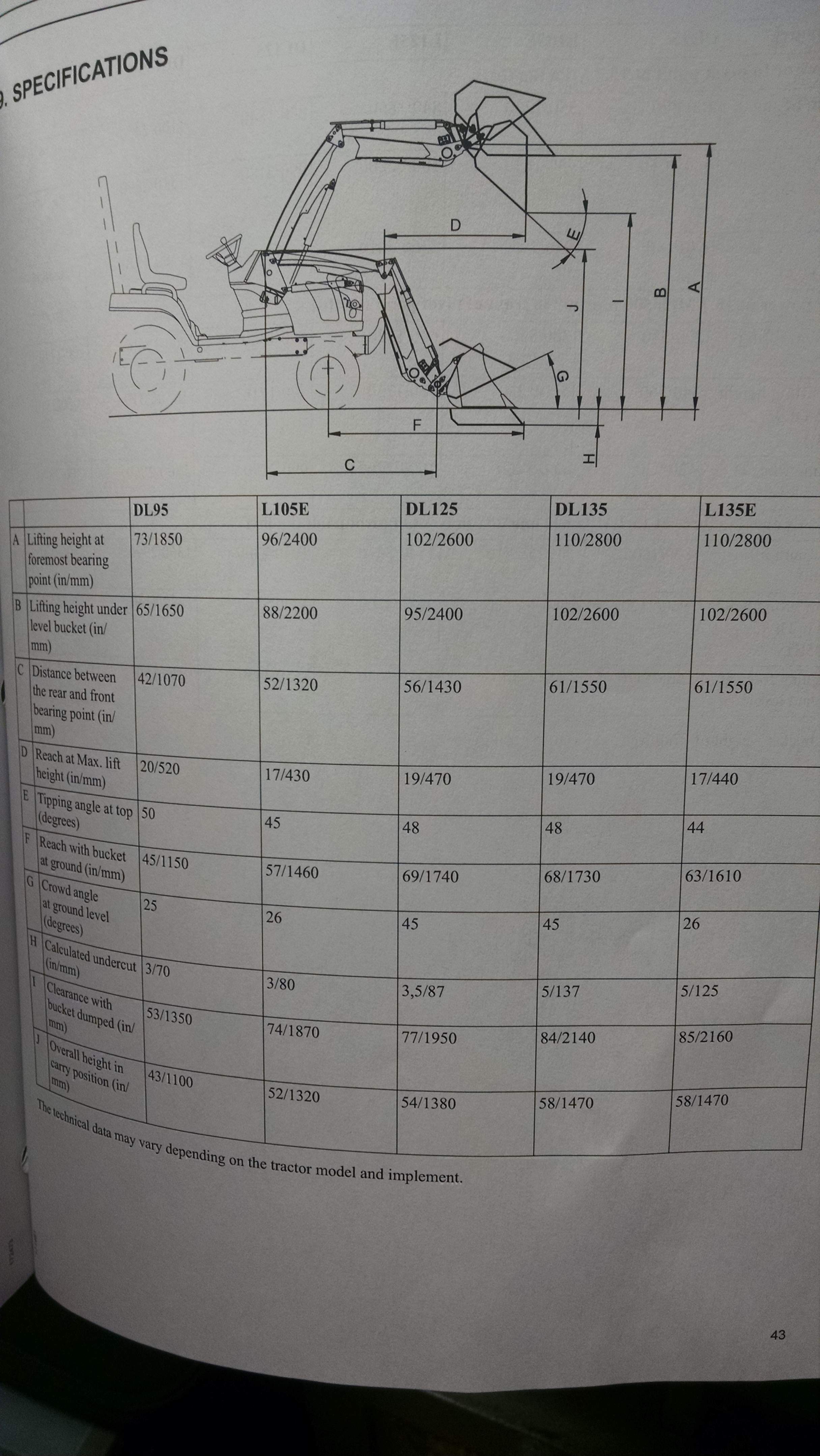

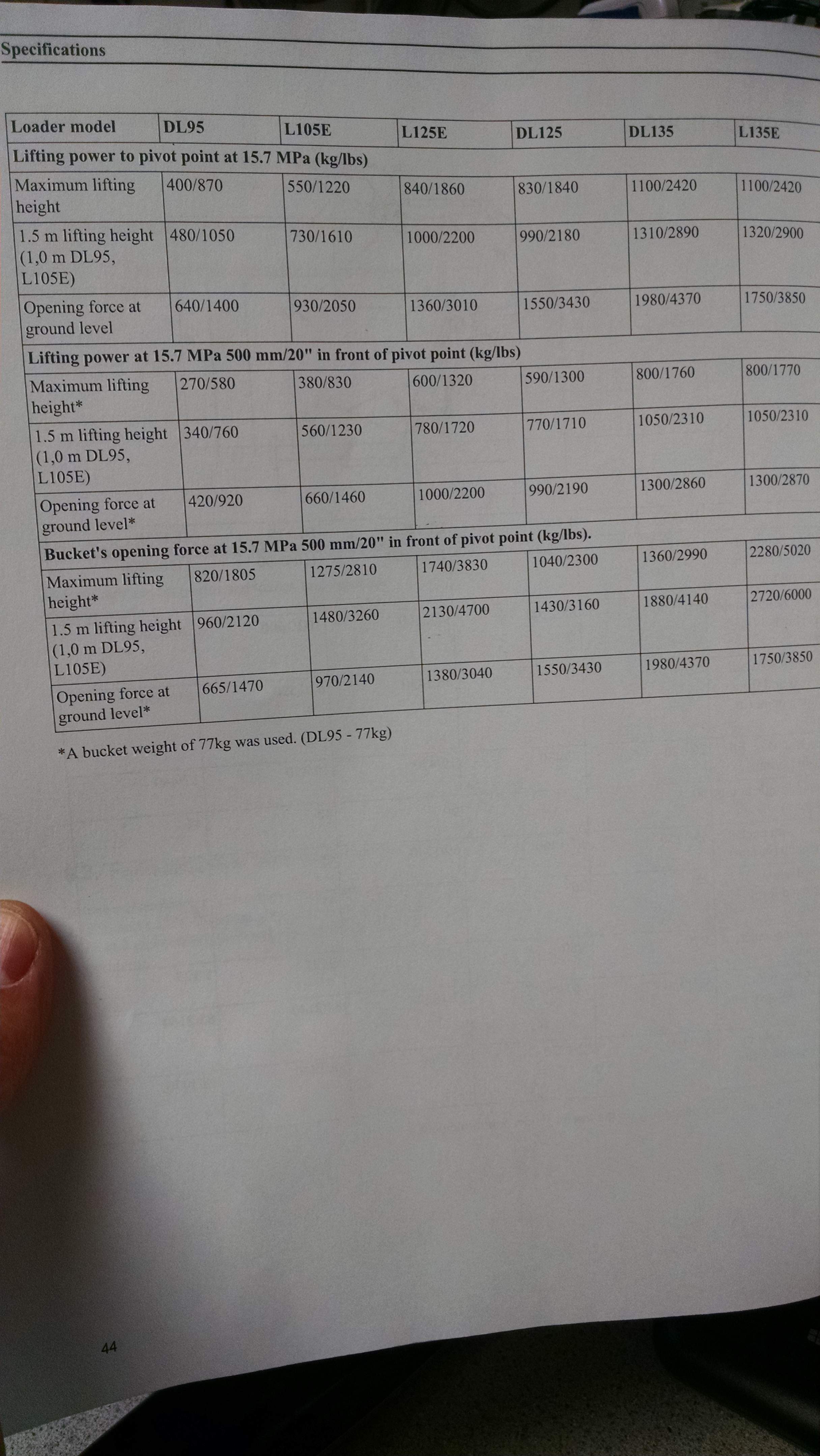

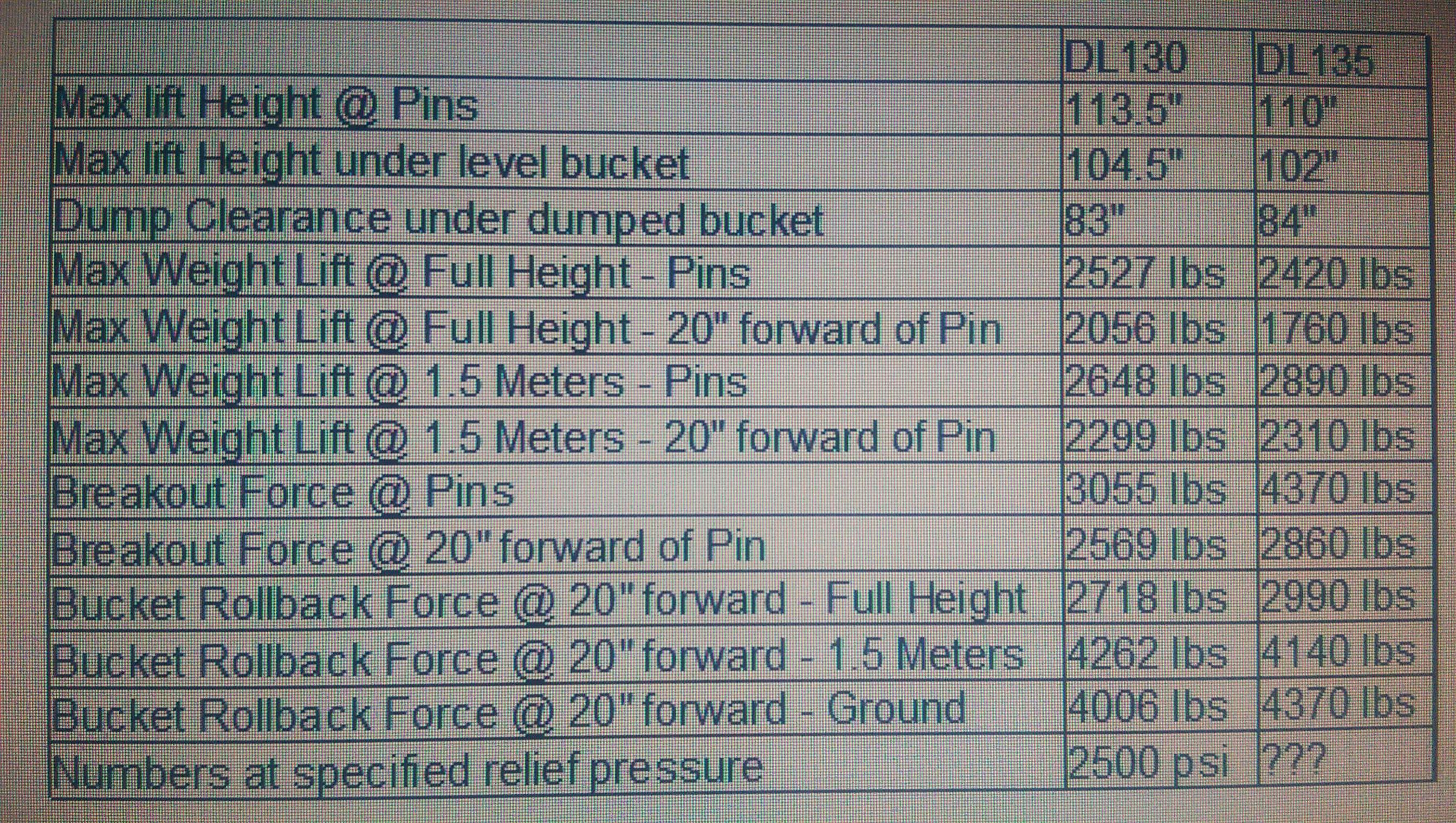

Okay, here's a comparison. Looks like the loaders are very close in specs, and the new one actually "out-specs" the old one on paper.
/ 1758 Review #44
The 135 looks like mashed rectums, however, compared to the 120s and 130s, for a negligible difference in performance.

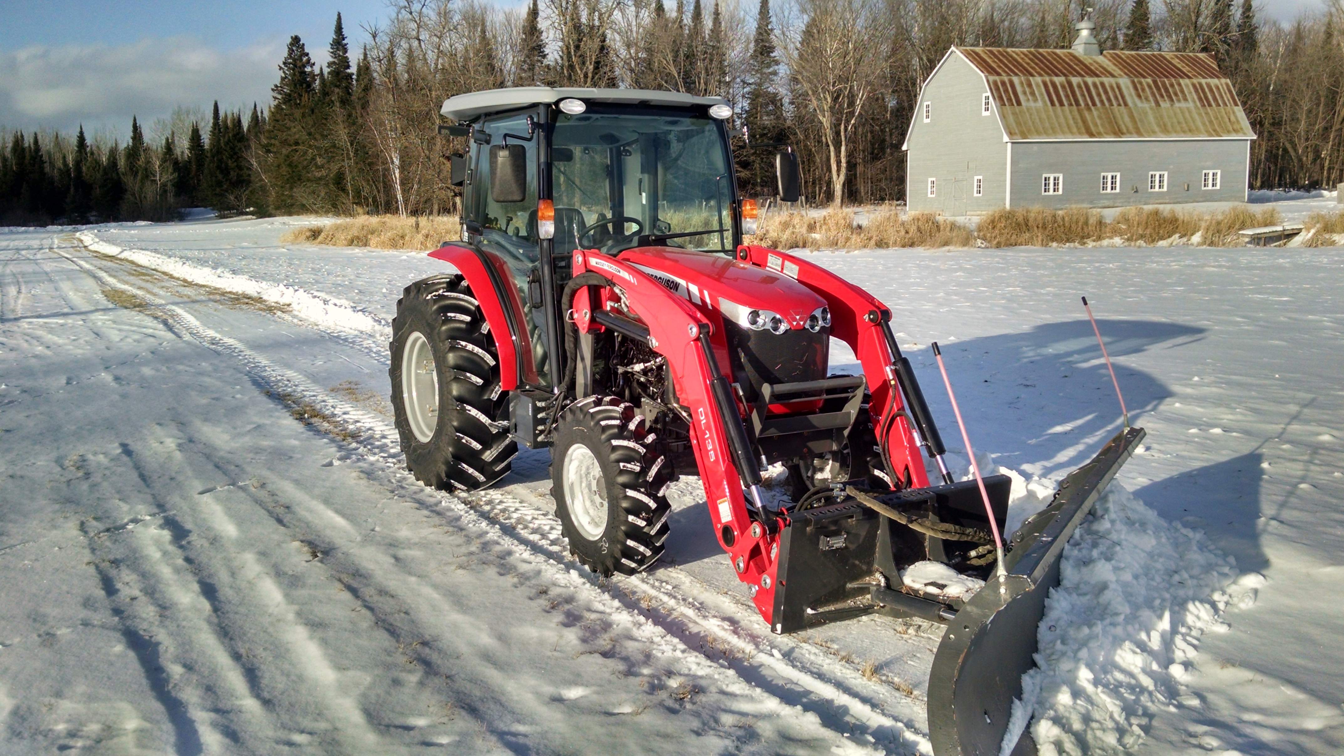

About 40 hours, soot level at 4. Glad I bought this tractor. Traction awesome. Now working the unit only in 2WD. Engine seems smoother and stronger and levers and controls limbering up. Wish it had a three point lever function outside of tractor when hooking up stuff. I ran a 84" rototiller and it chugs away effortlessly. Will advise when the tractor hits regen with more info. I am really surprised that more of these units are not sold locally. JD and Kubota for the extra $$$ didn't capture my attention. I can see why Kioti and others are also a viable option. Here is a short video and some pics from today. The Imatch JD hitch is superb. Always wanted one and it makes for some pleasant chores.

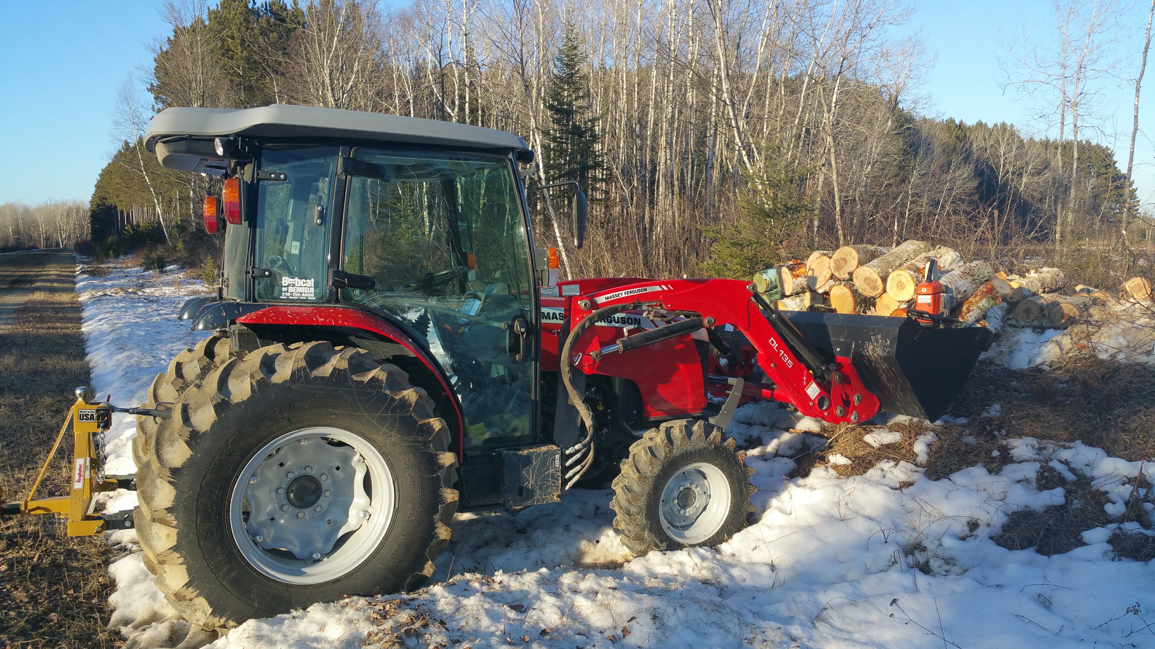

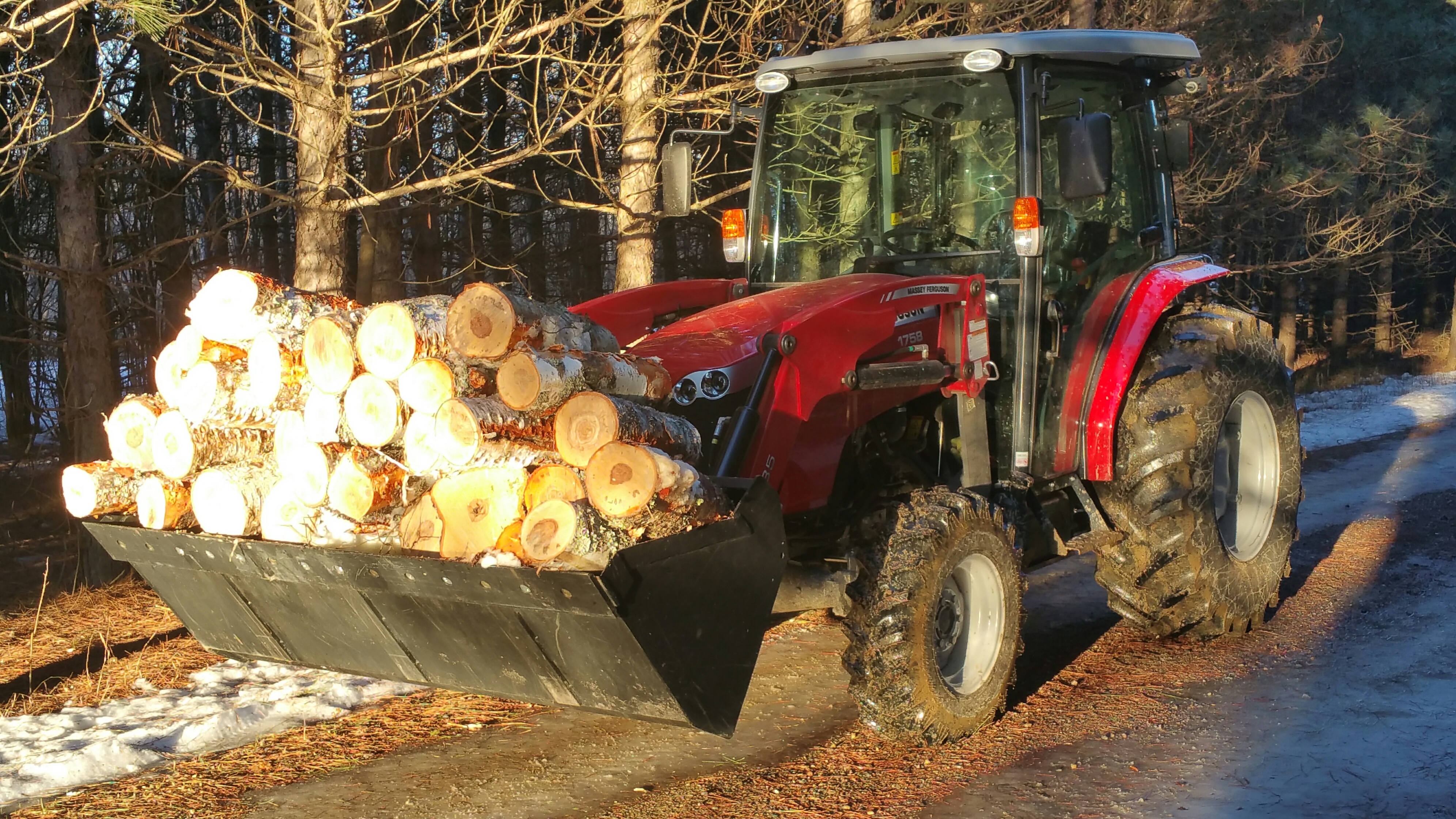

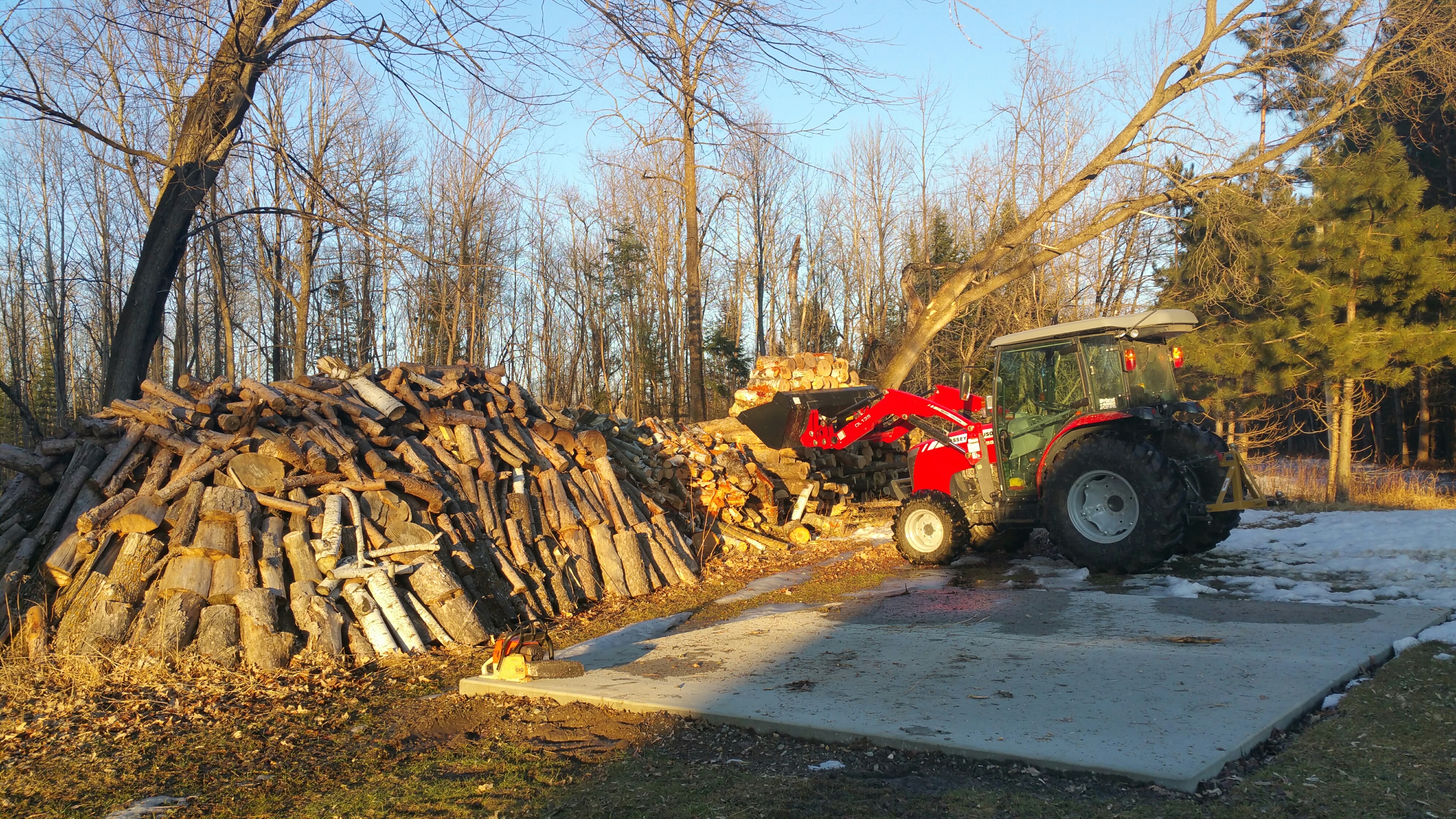

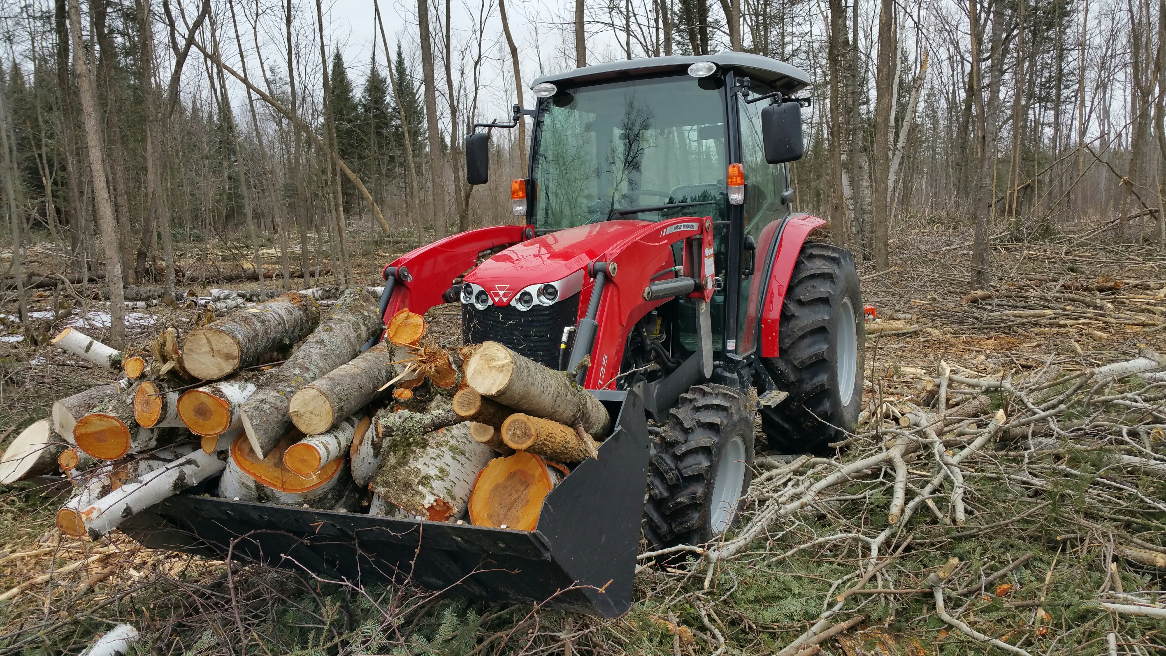

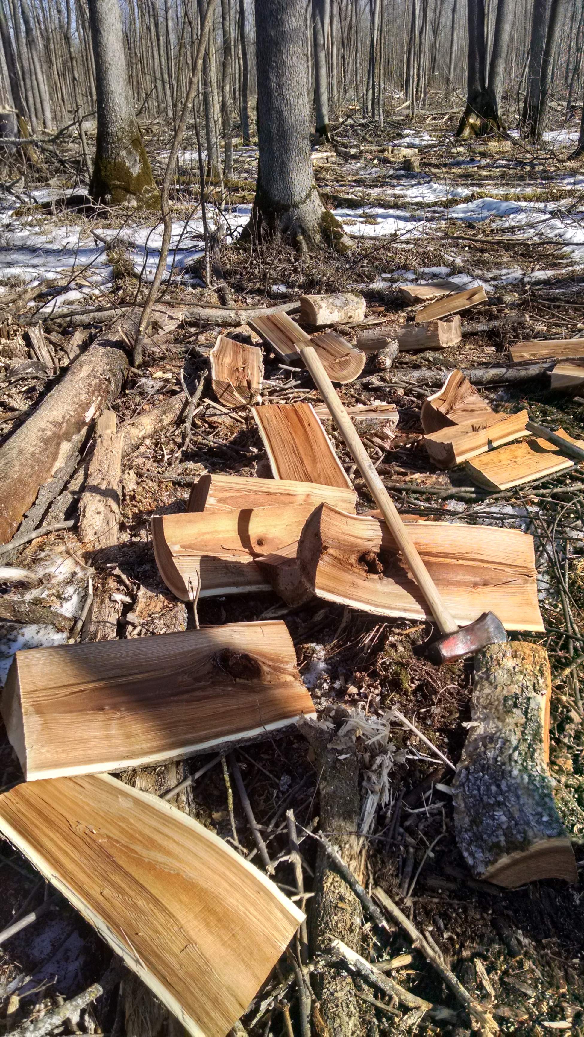

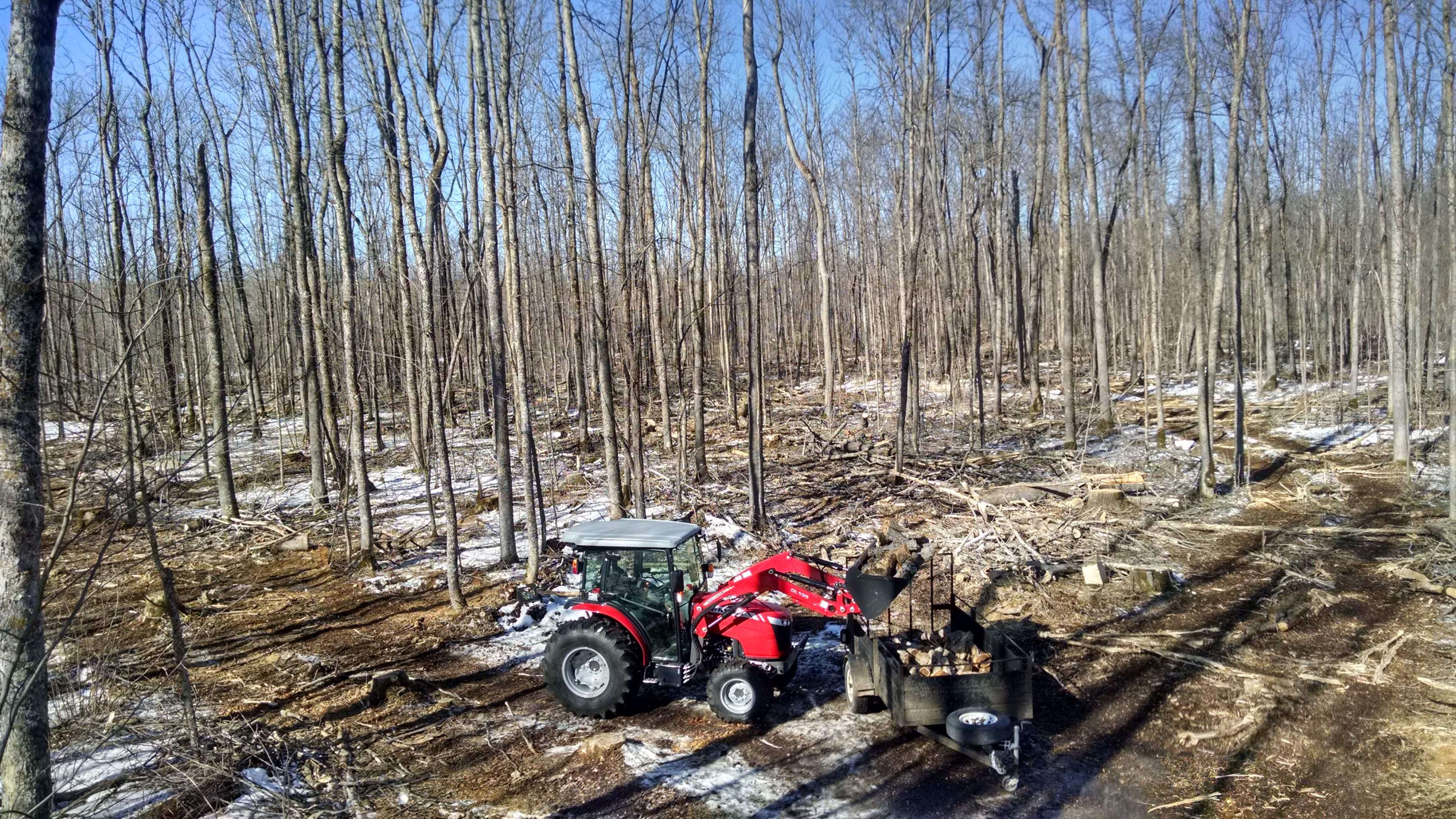

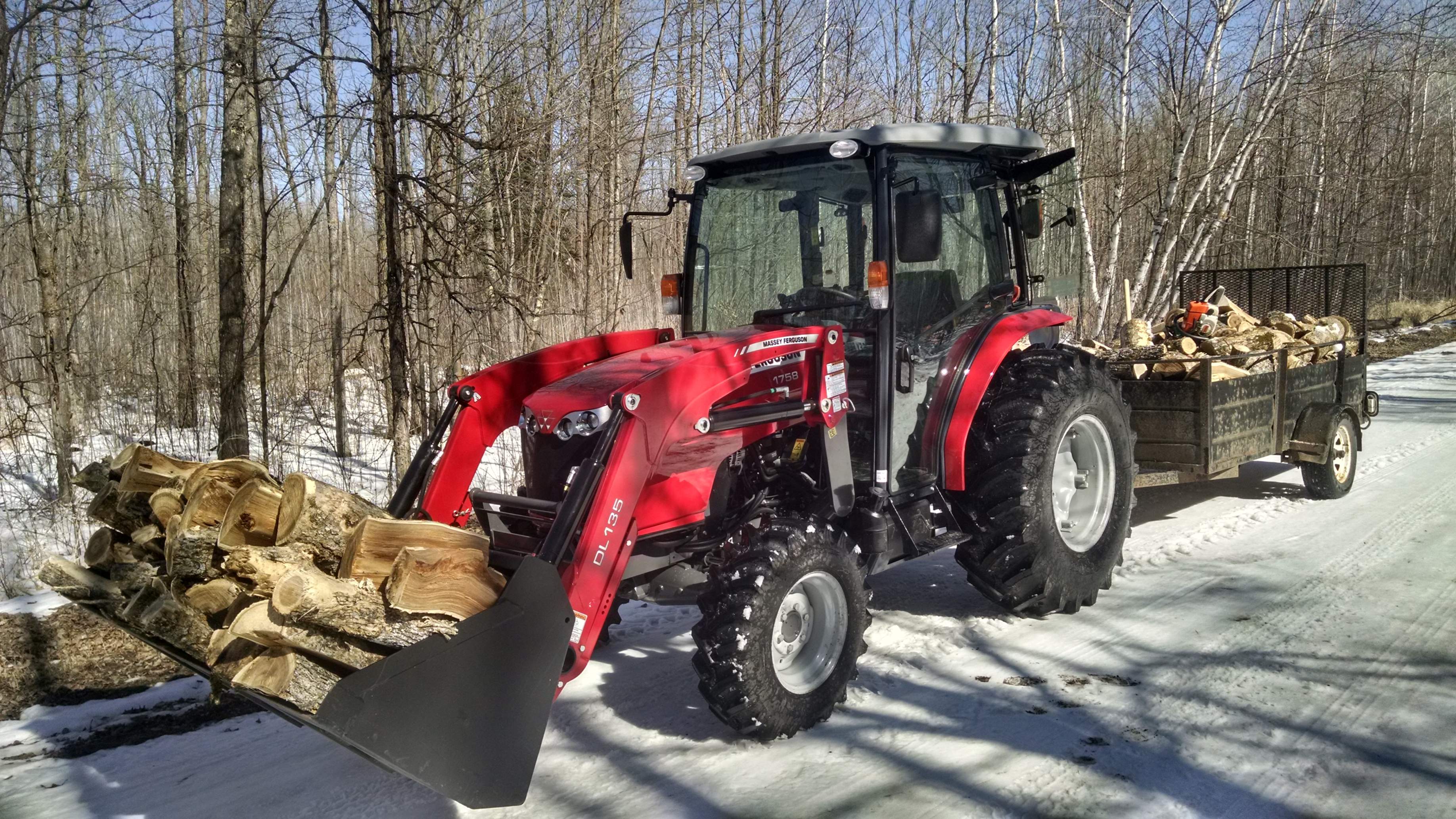

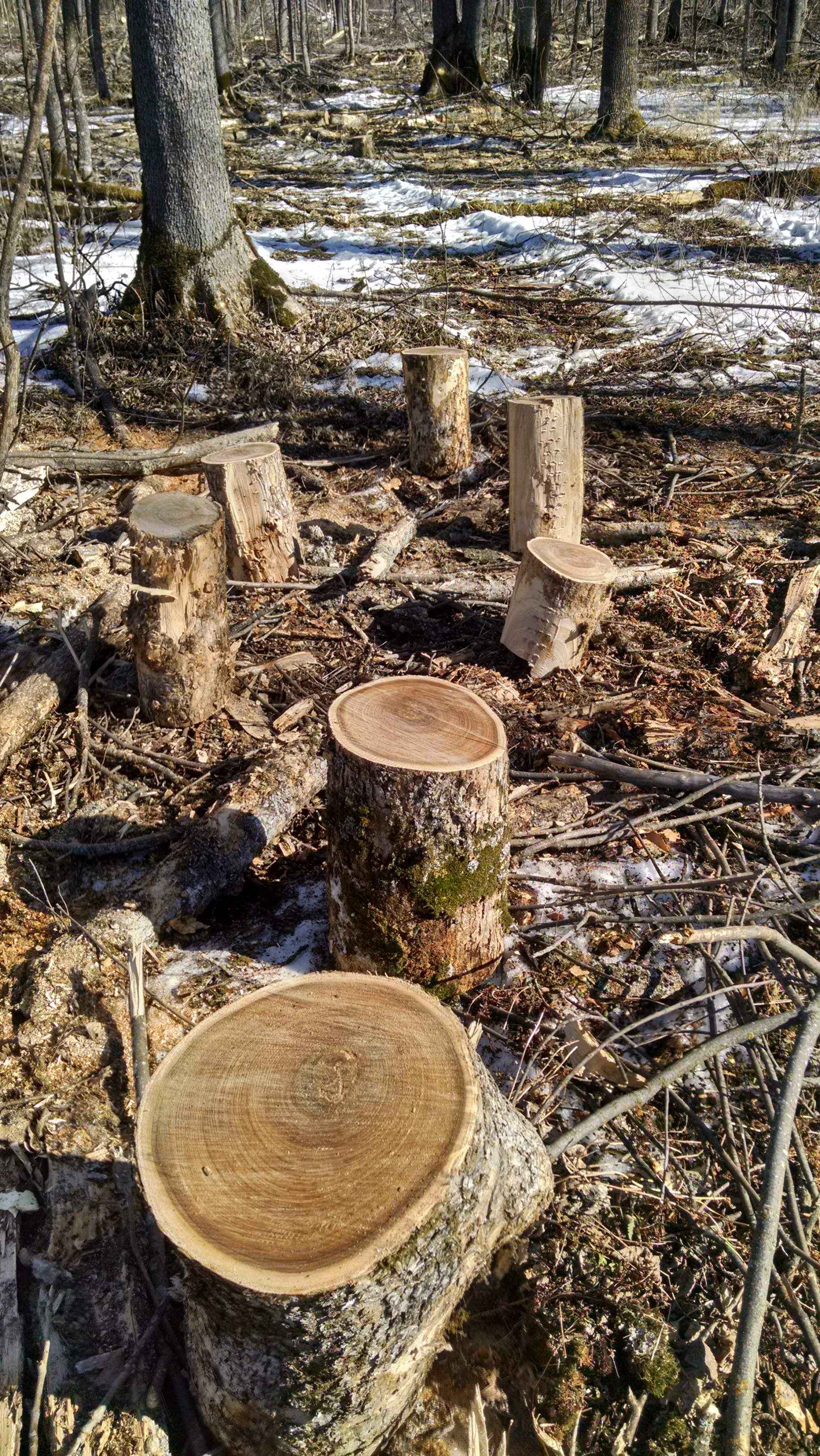

Wood cutting season. The 135 ldr/1758 combination is a great lifter. Green Birch heavy heavy. Roads in breakup here frost coming out super soft. Tractor roads in high empty and M range with bucket full. Without loaded tires no way would I have the stability and capacity.... Love my Massey
20160309_113512_resized.jpg20160310_165843_resized.jpg20160310_173519_resized.jpg20160310_173743_resized.jpg20160310_174236_resized.jpg

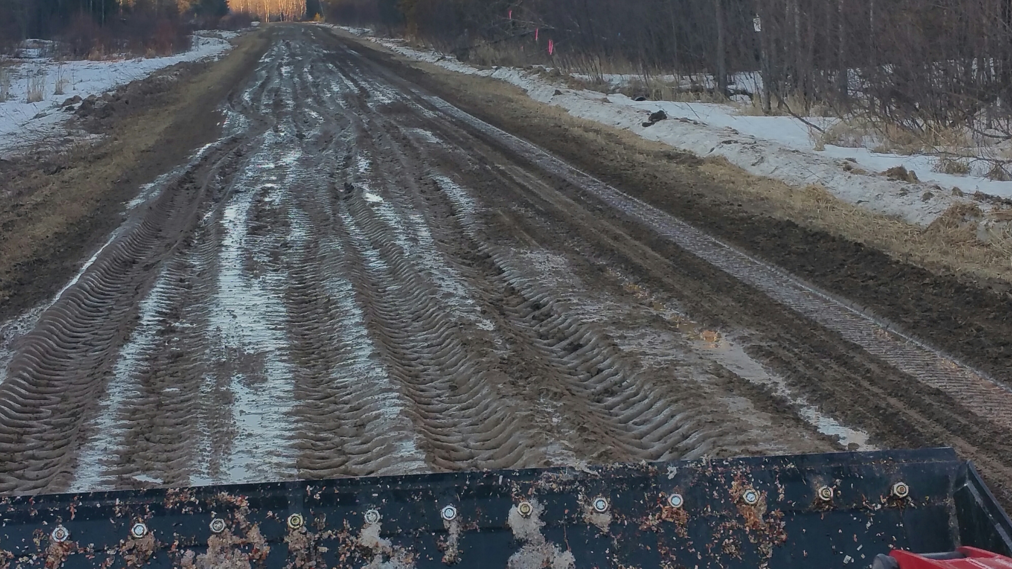

Your road looks like my road.
Going to bring in class 1 in an attempt to firm it up for thawing and heavy rains as soon as the road restrictions come off in spring.
