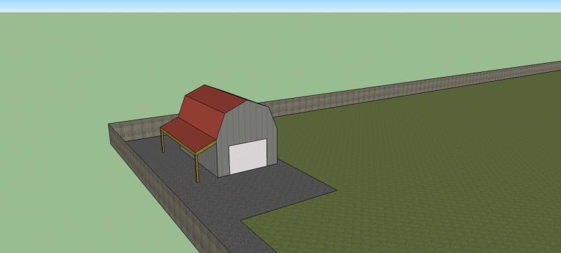

After a lot of back and forth about what to build and how to build it (and thanks to folks here who offered their knowledge) I finally pulled the trigger on the permits yesterday and got my approvals from zoning and construction in town. I'm doing a 16' x 24' Mini-barn which is probably the biggest I can go with without really encroaching on my yard space (1/4 acre lot). It will provide plenty of room for the OPE including the log splitter which is currently sitting outside under a tarp, as well as a boat, and lots of other stuff up in the two 8' x 16' storage lofts I'm building in. Finally, alongside I'll have 5 and 1/2 cords of covered and dry firewood storage via a lean-to. Here's what it's all going to look like:
I had initially planned on pole framing it and cladding the entire building in steel, but after I ran the numbers I found that it just doesn't make sense for a building this size from a cost perspective. For the walls, the cost of poles, girts, and steel exceeded the cost of stick framing and OSB composite siding every time no matter which way I sliced it. However, I still didn't want to pour a slab or a frost wall, so I searched around for solutions and found this:
http://bct.eco.umass.edu/publications/by-title/wooden-grade-beams/
In it, the author describes combining a concrete pier foundation with a treated wood "grade beam" or sill as the base of a building. The piers are poured and then the sills are bolted to the piers to form the perimeter of the building. The sill retains the gravel/stone dust floor on the inside and provides the attachment point for the exterior walls of the structure. I'll be pouring eight piers with 24" bases via "Bigfoot" concrete footings-cone shaped forms which fit conventional 8" form tubes. This way I can have a wide, solid base and use a fraction of the concrete in the process. Once the piers are poured and the 6 x 6 grade beams are bolted on, it will be pretty conventional. Stick framed walls 24" OC with two lofts on either end of the building tying the walls together.
I'll be using a gambrel roof design in order to maximize storage space in the lofts, and also because I just like the look. The design was developed from looking at old USDA extension service plans and is a "braced rafter" type. In the old days they would brace the rafters with dimensional lumber to create an arch that would allow for a large hayloft with no center supports but still stand up to snow and wind loading. A lot of the designs I saw actually used 2 x 4s as rafters for spans as wide as 24' with rafter lengths of 10' :eek: I'll be upgrading to 2 x 6 rafters with 1/2" plywood gussets, glued and nailed. My rafters will only be 6' long and will be plenty strong. The roof will be clad in steel over purlins as it's still cheaper than sheathing in OSB, felt, and shingles-not to mention it's quicker and easier. I'm hoping to get started pouring concrete the weekend after Easter-more pictures to come.

Where are you located? Seems to me that for such a small building it would be a lot easier to just pour a slab foundation then go to all the effort described in building your grade beam foundation. You will also appreciate having a concrete floor and hate having gravel floor. I think if you run the numbers, and factor in all the materials you will need comparing each type of foundation, you aren't saving any money going with the grade beam idea. Keep it simple.

Will your local jurisdiction not allow wood piers? Short pieces of PT 6X6's are a lot cheaper and easier than digging/setting/filling all those tubes with concrete. Dig t
Also, you're going to need at least one post supporting the span of that lean-to.

Is your objection to a slab the amount of work, or the cost? We can talk you through doing the work if you are worried about the cost of hiring someone for the forms, rebar/wire, and pour. That would leave you just the cost of concrete. At 5 to 7 yards (depending on a 4 or 6" slab), you're only talking one truck of concrete.
Ona separate note, are you planning to have the top floor surface up 6" to 12" over the surrounding ground level? If you do, then you can slope the ground around you out for 2 or 3' pretty easy, and it will help a lot for the amount of runoff a building that size will make. Keeping it from getting muddy in front of the doors and water from puddling against the siding helps a lot.
/ 16' x 24' Mini-barn build
The cost. I've gotten quotes on all materials running between $3000 and $3500. I'm financing the building with this year's tax return and some equipment I've recently sold and I don't want to dig into savings. I figure a slab would add at least $2000 if I hired it out if not more. The real problem is access though-I have a 75' x 160' lot surrounded on three sides by houses. Even if I did the slab myself I'd have to bring in one of those conveyor trucks-the nearest the truck could get to the pour is 75' away-I'm not even sure they can reach that far. I suppose I could call around to some of the local companies and see what they charge for that kind of service/if it could be done.
Yes-the plan was to raise the floor about 12" above the surrounding grade using fill from another part of the yard and stone screenings. If you guys have a good cost effective solution to slab though, I'm all ears.

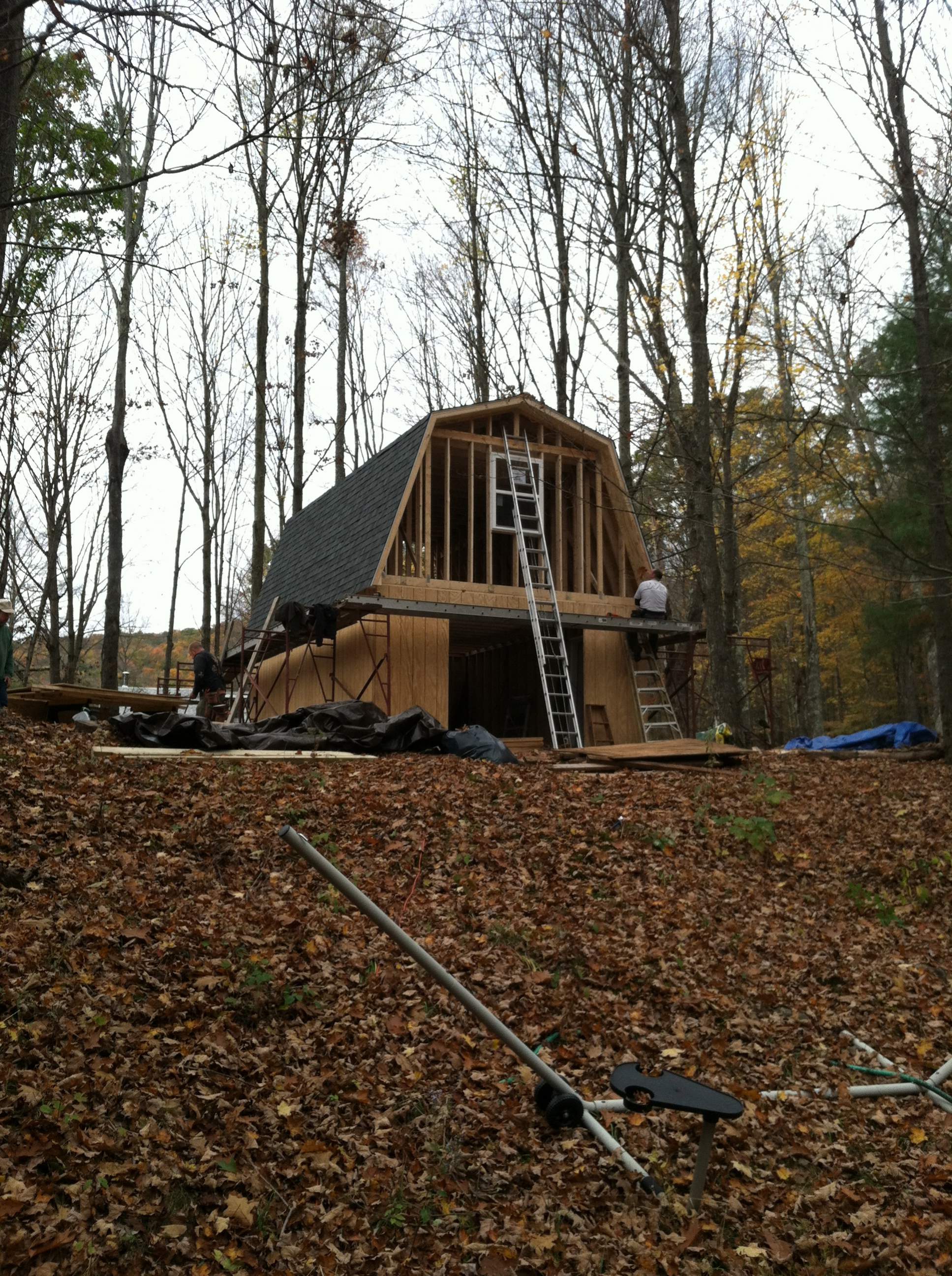

A little progress today-batter boards up:
Old woodshed loaded up and ready to head to the county dump:
/ 16' x 24' Mini-barn build #11
This will be interesting to watch.
/ 16' x 24' Mini-barn build #12
that the same size i built
