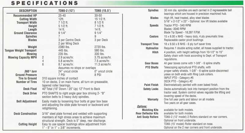

I found a 15 foot TD-65 mower at the local dealer. The brochure recommends 30 - 50 HP. How is the HP for attachments normally specified? Is that spec for the tractor (engine) rating or are they talking PTO horsepower?
The TD-65 mower is an expensive option. Should I keep considering it or should I be thinking flail mower instead? Right now my field is grass with a lot of weeds. I'll be spraying and overseeding and eventually the field should be mostly grass. I'm using the field for flying and it will need to be fairly smooth.

Normally the rule of thumb for rotary mowers is 5 PTO hp per foot of mower. Depending on what is being mowed you can sometimes get by with a bit less. Heavy damp field grass can be one of the most demanding hp users. Attachments that are PTO driven would normally quote PTO hp needs. It is really hard to believe that mower is rated for 30 PTO hp.

It usually takes 30 HP just to run a 7' bushog.
Most guys around here have north of 75PTO HP for a 15' batwing. That's a bushog, maybe a 15' finish mower can run on less, but 30HP is a lot less.

The manual says the input PTO is a cat 5 and deck PTO is cat 2. What do the categories mean?

The mower you're looking at is not the traditional 15' batwing like those from Rhino or Bush Hot, etc. The 65 is a turf mowing machine like you find at a golf course or, correctly enough, a grass strip. Light decking, lawn mower-esque fixed blades on the spindles. It's a big lawn mower.
I would believe that 30-50hp is perfectly fine running it in ideal conditions. But, do you have ideal conditions? If you're cutting anything more than something like an overgrown yard then there'll be trouble.
From your description of the property, it sounds like it's already rather well maintained for airplane ops. If so, you can probably handle it with a 30-40 PTO HP (meaning roughly 34-45 engine HP) tractor. Your H my turn it okay depending on condition and terrain. It has the weight to do so.
The mower price does seem really good for the condition it's in. I'd buy the mower, try it with the H, and then see if you need a new tractor. As for the PTO thing, simply the shaft you attach to the PTO on the tractor is not the same as that running gear box-to gear box on the mower itself. Not unusual and means nothing to you with regards to tractor.
