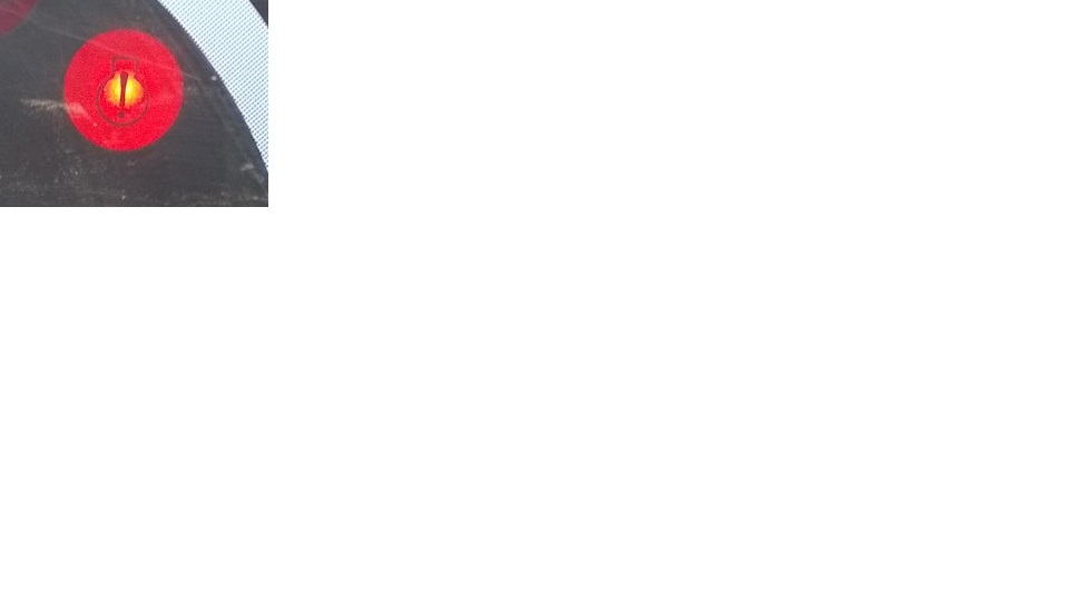

Big weekend with big projects planned and now the 1538 has an error light flashing. Engine temperature rises after a few minutes of running as if the thermostat is not opening up. 81 hours on the tractor. The manual does not help much and the only folks at the dealer today were the parts counter guys not very familiar with the tractor. They suggested I bring it in on Tuesday to get it checked. It ran fine yesterday for the 45 minutes or so that I ran it. Can anyone offer any suggestions? I'm thinking about draining the coolant down and checking the thermostat, presuming that it is under the cast elbow like almost every other engine in the world.
Here is the light that is flashing:

Is the engine temperature really rising or is the sending unit defective? I'd try using an external temp. gauge before taking things apart. Your problem is one reason among many I am thankful for owning a tractor without too much modern technology. I hope it is something simple; a loose wire connection, etc..

So I pulled the elbow off over the top of the thermostat after draining a gallon or so of coolant. Moved the valve on the thermostat down a few times with a screwdriver, it might have been a little sticky at first. It sprung back closed each time. Buttoned it back up and refilled the radiator. Started it up with no error code and the temp gauge stayed down on the C peg as it normally does. Ran it for about 30 minutes without any issues. Thank you Jesus I can get back to the projects planned.

OK so maybe I shouldn't be planning on working Sunday? Flashing light is back, temp rising. Will try to get a new thermostat this afternoon and replace it.

New thermostat did not help, ran 10-15 minutes before the light started flashing and the temp gauge started climbing. When I ran it a little on Sunday morning it started blowing white smoke and lost power, all I could do to get it back in front of the barn. I'll get it loaded up and take it in tomorrow.

So the dealer checked it out and the temperature sending unit was defective and that is what was throwing the code. They changed it out and it will be ready for pick up in the morning. There have been reports of some temperature issues with the 1500 series mostly running cold per the area rep.

the error light was due to a faulty temperature sending unit. Evidently common? The smoke was due to a change in fuel sources. Had always used from the Citgo down the road, got a can from Speedway just before the problems started. The dealer gave me a bottle of diesel fuel conditioner and said that it is being recommended by Mahindra to use due to differences in fuel between USA and India.
And yes all filters were changed at the 50 hour mark as recommended by Mahindra and I check the air filer and radiator diligently. Thanks everyone for the feedback, hope the information helps others as well.
