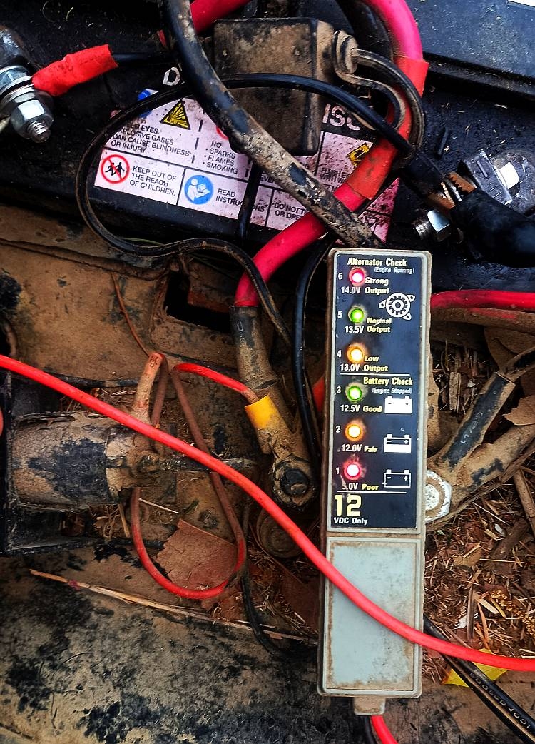

Got a PYT900 from Sears not too long before they shut down around this area. Has been fine over the years with a few problems.
Briggs 24HP VTwin Vanguard.
Latest issue is charging. Battery has to be on float charger for it to start at all. If it dies or has to be shut off for any reason, it will not restart without a jump.
Test today shows no output to the battery, when tested AT the battery.
I'm not much of a tech, so I'm not sure where to begin. Voltage regulator is $10, two bolts and two plug in connectors. I can probably handle that without breaking anything, but will it accomplish anything? Stator seems to be under the top fan assembly and I'm not sure I have a big enough socket, or the torque to remove that nut.

Since the battery has been replaced, I'm assuming there is no corrosion on the cable ends? I would unplug the voltage reg and plug it back in, might be enough corrosion in the connector to kill it.
/ 15 year old Craftsman mower issues #8
Check the wiring going into the alternator, use AC scale. If you see voltage there the regulator is probably bad.
/ 15 year old Craftsman mower issues #9
Check for ac voltage between the 2 wires coming from the stator (coil under the flywheel), you'll have to check for particular engine model, but is usually between 28-35v ac at full throttle.
If you have the correct ac voltage going into the regulator and no dc voltage above 13v coming out, it's safe to say you have a bad regulator. Check that the regulator and engine still have a good ground also

In addition you need there to be battery voltage at the regulator. They are not switched and wired hot. So you depend on the regulator to shut down and you'll have no draw if that part of the regulator is working. Be sure the battery is good to start with. A good battery is capable enough to run the PTO clutch on it's own -probably for a couple hours. Personally, I would opt for the OEM regulator. It has an important job.

New VR installed.
Only the bottom 'Poor' light was lit before.
Battery warning light on Dash is off now too.
