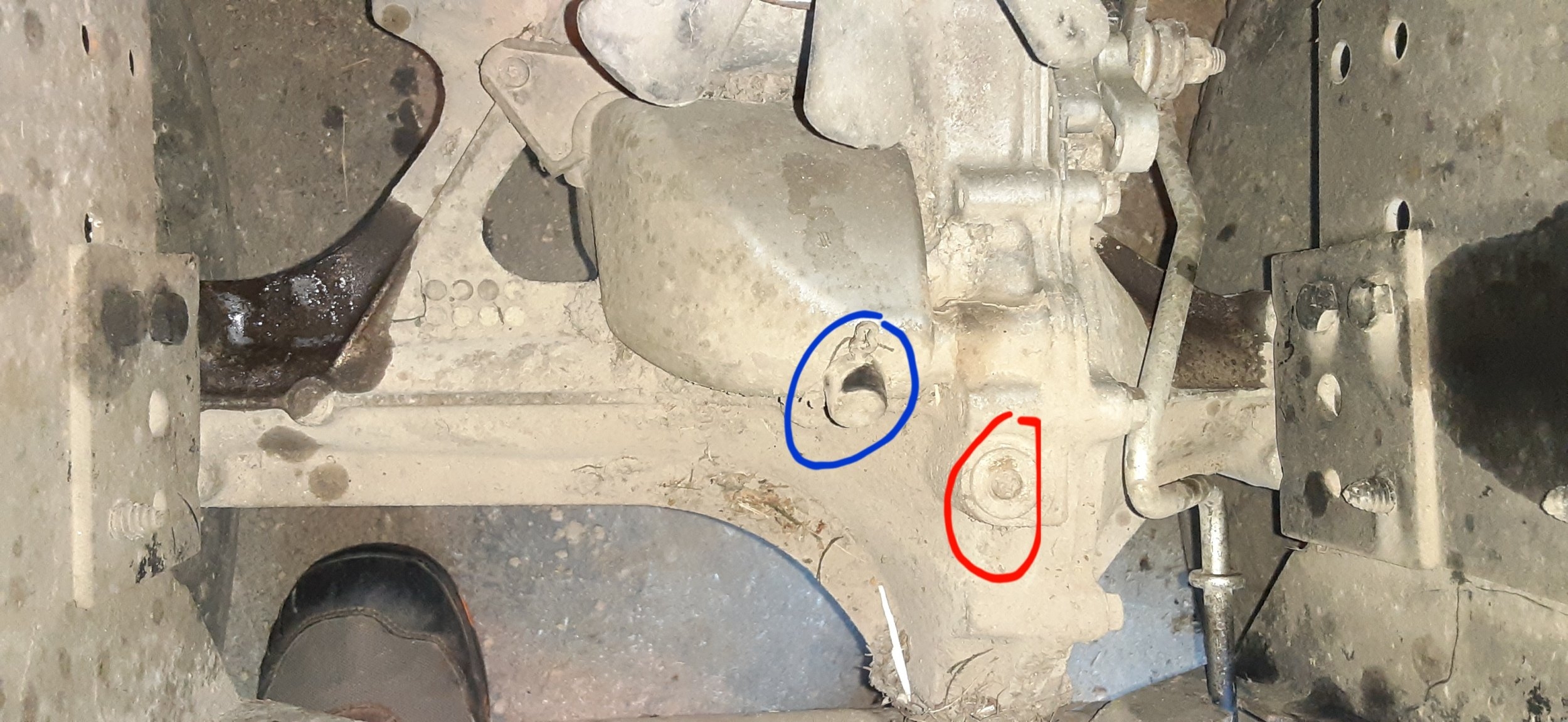

I strained the transaxle fluid and found no particulate. It was really REALLY thick but I'm not familiar with 20W50 so maybe that's expected. Since the expansion tank was empty and the main body was topped off, is it possible that there is a blockage in the rubber expansion tank hose? When I was pumping the fluid out, the suction side hose kept collapsing which could mean it was pushed against the bottom of the tank or it could mean there was no way for air to get into the tank to back-fill the fluid being removed.
/ Help identify Craftsman lawn tractor #44
Possible but 20w-50 isn't right anyway for hydro stat. You want 5w-50. And TuffTorq is even recommending 10w-30 now. I'd put synthetic in it as well. Not conventional.

I got a chance to talk to Hydro Gear customer support (now routed to Gardner Co) wo directed me to a local HG service shop. They said HG transaxles of that era are pretty good and most likely a linkage issue rather than internal based on ddescription. Also confirmed best oil to use is 20w50 full synthetic which was OOS at local store so ordered for delivery. I do wonder if it would be beneficial to use some thinner lubricant to flush the old stuff and use the synthetic after.

I got a black light the other day as a last ditch effort and it popped the sticker out like magic! Turns out, the tractor has a swapped engine and a different deck. It's a 917.272201 25HP v-twin 46" hydrostatic transaxle DLT lawn tractor just like the ones at the shop. The motor was swapped for a near perfect date matched 20HP opposed twin. Mystery solved!
As for the transaxle, I replaced the oil and it seems to work great. It does act a little strange with bypass enabled. It should stop any motion of the axle but it slowly reverses when full reverse and it jerks forward but only when in full forward. I performed the purge but it didn't make much difference with the bypass issue. Since I don't see that as a big deal (I'm not going to be running the engine in bypass for any reason I can think of), I'll not worry about it.
It looks like the electric clutch is running all the time which is a more concerning issue. I'll have to look into that since I'm not sure about how the electric clutch engages.
