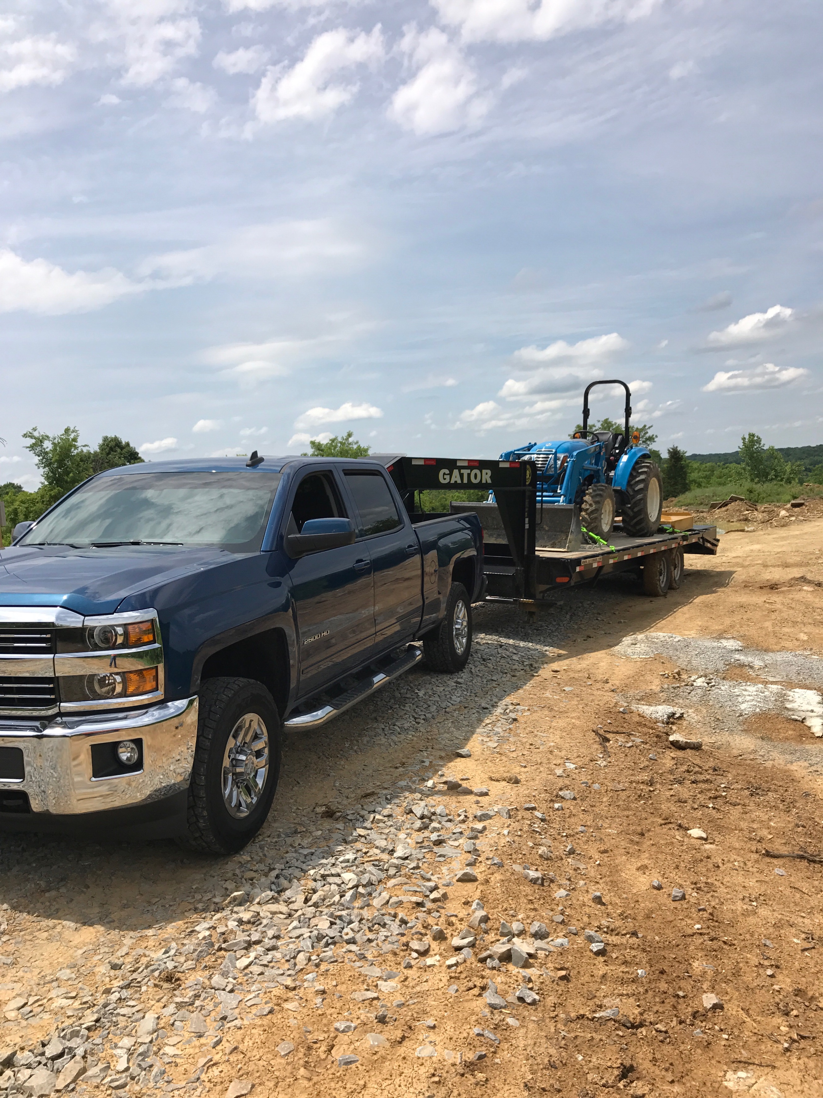

First off I am not trying to be a smart alleck but I don't think a lot of people realize how un-realistic it is to have to upgrade everything you have to virtually semi capacities just to pull you're tractor a few times a year close to home, I pull my trailer with a 3/4 ton truck and when I load it down with hay in the field to bring to the barn I am absolutely sure that I am overloaded by law but I am out in the country not pulling thru a school yard where kids could run out unexpected in front of me or anything like that, I don't pull for a living just now and then, but if I had to upgrade everything to do the little bit of pulling I do, I just as well get rid of it all because I couldn't afford it. It will come down to what you feel comfortable with. Good luck. Charlie.
This 100%. No reason you can't pull what your wanting to with a 14k single wheel gooseneck. I'm maybe 1k to 1500 lbs off your load and I pull with a 6.0 chevy gas truck and it does just fine. IMG_3860.JPG
