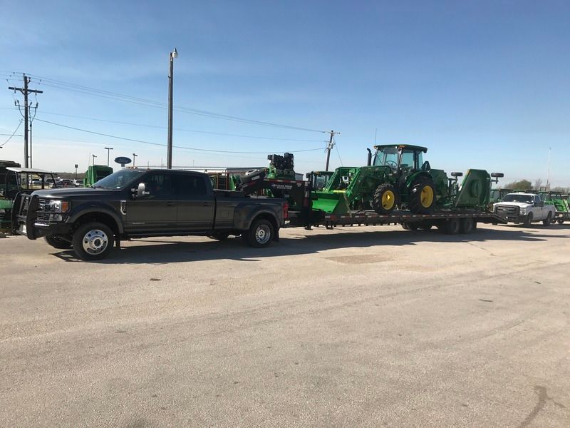

First off I am not trying to be a smart alleck but I don't think a lot of people realize how un-realistic it is to have to upgrade everything you have to virtually semi capacities just to pull you're tractor a few times a year close to home, I pull my trailer with a 3/4 ton truck and when I load it down with hay in the field to bring to the barn I am absolutely sure that I am overloaded by law but I am out in the country not pulling thru a school yard where kids could run out unexpected in front of me or anything like that, I don't pull for a living just now and then, but if I had to upgrade everything to do the little bit of pulling I do, I just as well get rid of it all because I couldn't afford it. It will come down to what you feel comfortable with. Good luck. Charlie.
This 100%. No reason you can't pull what your wanting to with a 14k single wheel gooseneck. I'm maybe 1k to 1500 lbs off your load and I pull with a 6.0 chevy gas truck and it does just fine. IMG_3860.JPG

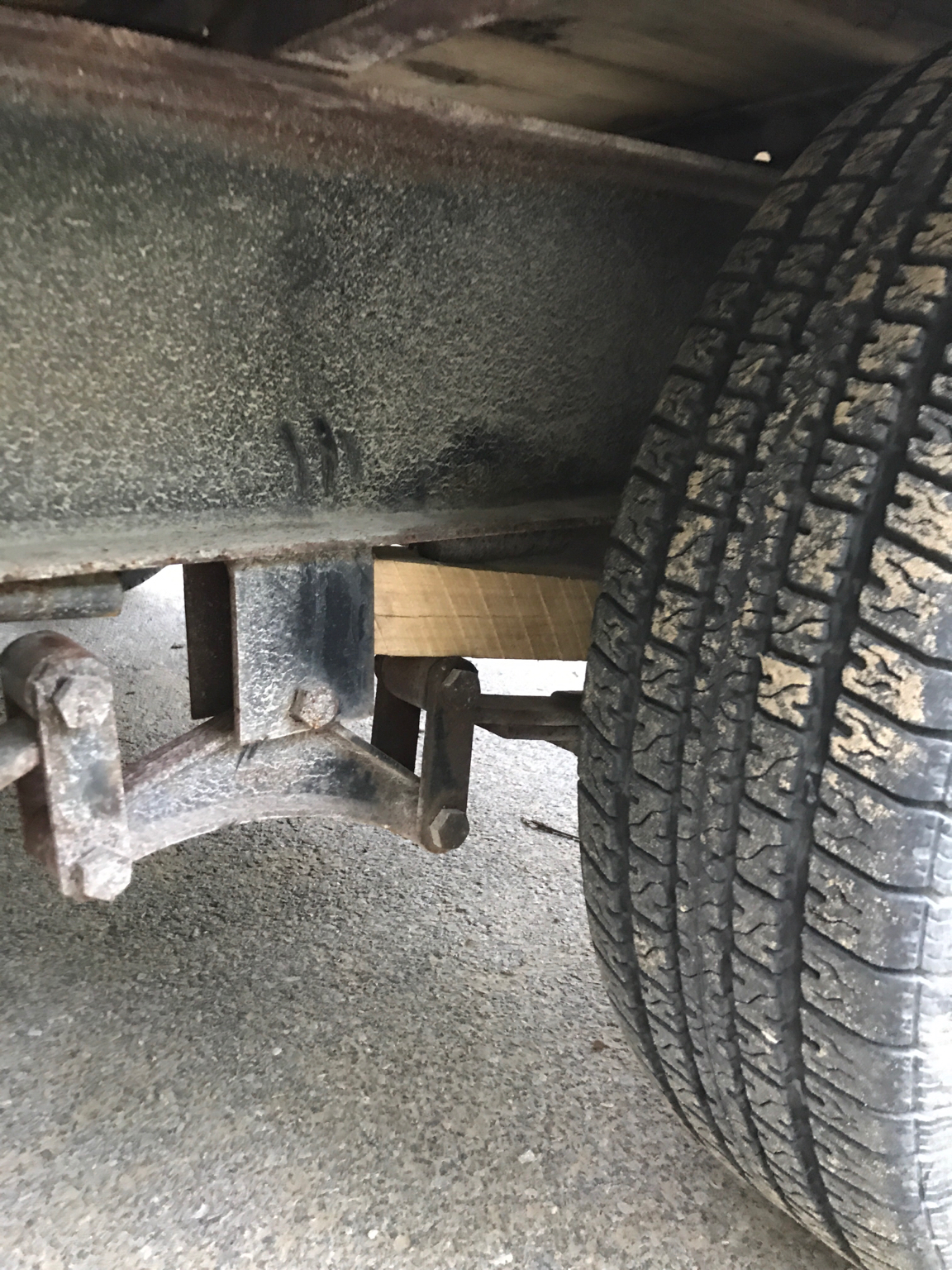

The tires on my trailer are 235/17.5 Hercules brand and I believe they are 16 ply, they are Made in China but they haven't given me any trouble yet, and yes I have 2-10k axles, I want to say the tires are rated at something like 6k each at 125psi. I will try to take a picture and verify the specs tomorrow.
/ 14k vs 20k trailer? #34
I checked the tire and it states it's rated for 6005lbs max load at 125psi if ran singled rather than tandem dual.IMG_20170524_184614495_HDR.jpg

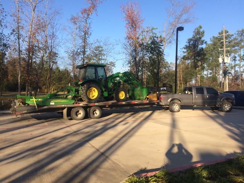

Just get a deck-over GN with a 16000# rating. That would give you 14k on the axles and the rest on the hitch. I have one like that and the trailer weighs around 6k by itself. I carry a 3720 with FEL, loaded tires, B-BOX, blade and box blade attachments like a shot with it.
Of course making a trailer change for an extra 2k capacity would take some thought.
If you have a trailer rated for 14K you can have 14k on the axles and X Amount on the hitch. If it has a 16K rating you can put 16K on the axles X amount on the hitch. If you had 15% on the hitch a 14K trailer could have a maximum load including trailer of 16,100 lbs.
