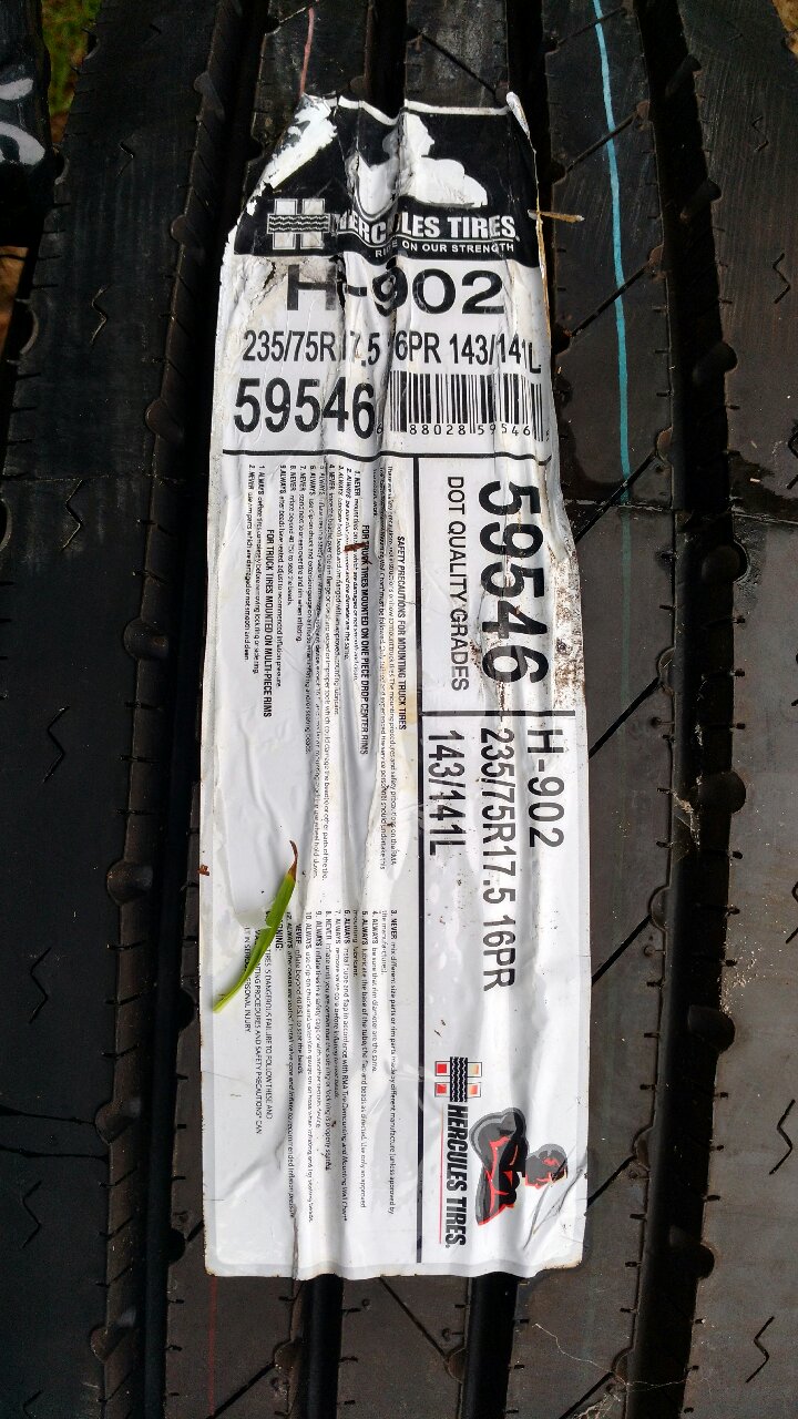

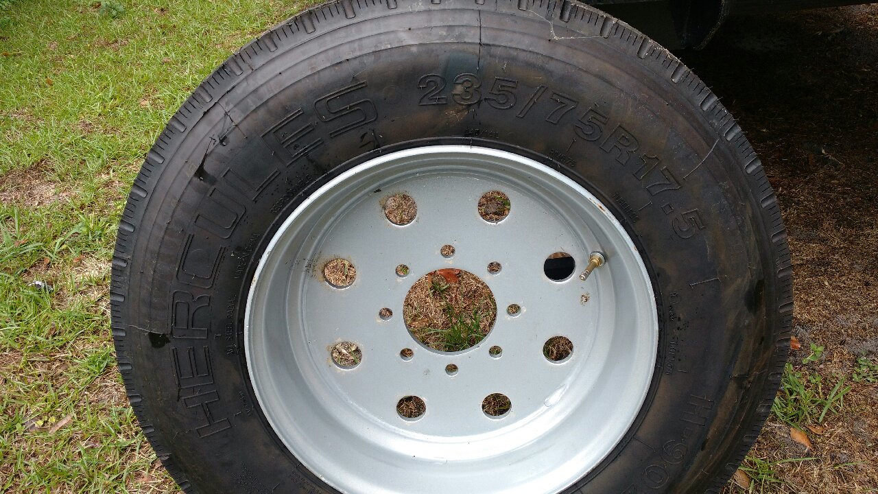

The tires on my trailer are 235/17.5 Hercules brand and I believe they are 16 ply, they are Made in China but they haven't given me any trouble yet, and yes I have 2-10k axles, I want to say the tires are rated at something like 6k each at 125psi. I will try to take a picture and verify the specs tomorrow.
   / 14k vs 20k trailer? #34
I checked the tire and it states it's rated for 6005lbs max load at 125psi if ran singled rather than tandem dual. IMG_20170524_184614495_HDR.jpg
