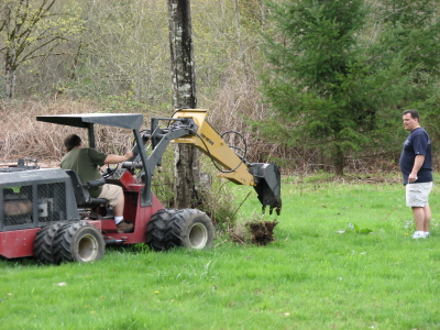

Though I've hired out both excavator and dozer work, don't overlook the usefulness of having the minihoe on hand, when the need (i.e. project) arises.
It is NOT a viable substitute for a trencher or mini-excavator, if you have a lot of digging to do, but having such a versatile tool on hand (especially with the thumb on it) when I need it, and the ability to mount it in no more than 2 minutes, is as the commercials state.... PRICELESS!
My PT normally goes out of the shed with the grapple bucket mounted, with the mini-hoe inside the bucket...
Those two attachments probably account for 80% plus of the hours put on my machine to date. I'd give up all the rest of my attachments before I'd let these two go...

Using the existing auxillary lever did not bother me as much as I thought it would but still could be better located.
I can not believe a trencher would dig 4' deep here - way too much rock/shale.
The first time I used the mini hoe, I dug 130' of 3' deep trench in 8 - 9 hours. The ground was very rocky. The part not near buildings went much faster but lots of the trench was with the PT a couple of inches away from a building so I had to be real careful.
