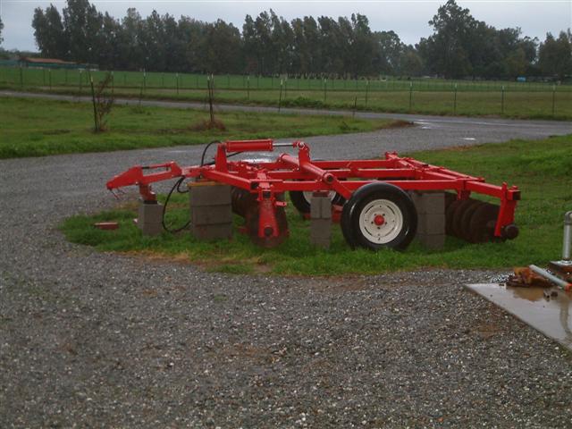

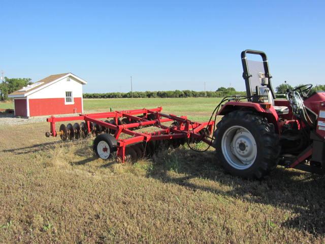

50hp (pto) is a good size for your needs--my main tractor is a 2008 Mahindra 5525 (54 hp(engine), 45 hp (pto), 2WD, power steering, gear tranny 8F/2R) with the ML250 FEL (6-ft bucket, 2950 lb lift to 10.5 ft height). Get double or triple remotes on the rear and one remote on the front to handle your grapple. Chain hooks on the FEL bucket. Skid steer quick attach on the FEL arms. Here's the setup on my 5525
Orchards: I'd get a post hole digger and flail mower. And you may have to do some deep subsoiling (18-24" depth) if there's hardpan where you want the orchard.
Deer plots: 6-8 ft tandem disc, some type of seeder/fertilizer spreader (broadcast, drill, drop seeder like a Brillion).
Good luck

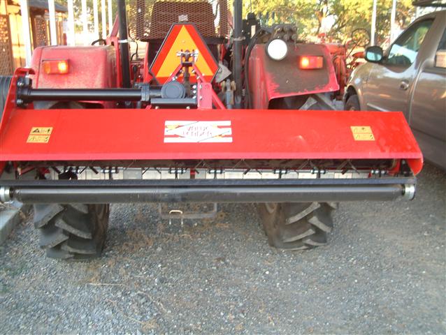

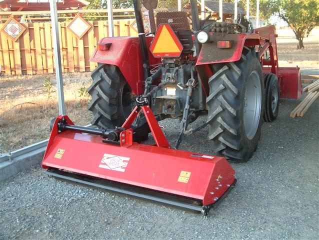

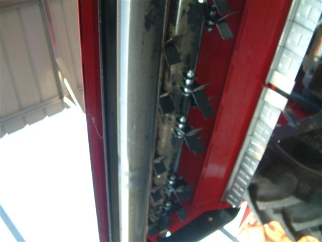

Remotes: pairs of hydraulic quick disconnect fittings (female fittings on the tractor, mating male fittings on hydraulic hoses--feed and return--attached to the implement. Here's my wheel disc hookup. The big, honkin' hydraulic ram on the disc raises and lowers the transport wheels and is operated via the hydraulic control valve on the fender of the tractor (see my previous post to this thread for a photo).
Here's my 68" wide flail mower on my Mahindra 5525. It operates similar to your military flail--swinging blades attached to a horizontal rotation axis. A rotary mower (aka brush hog, bush hog, slasher--the mowers with the swinging blades) spins about a vertical axis.
[/ATTACH][/ATTACH][/ATTACH]
Flails are used for cutting everything from underbrush in the woods to golf course fairways and roughs.
