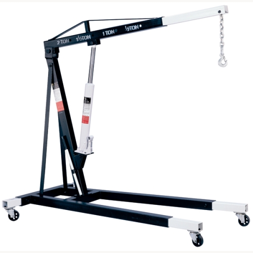

A shop crane/engine hoist in the pickup bed, chained to the gooseneck hitch is what I have used for similar situations.

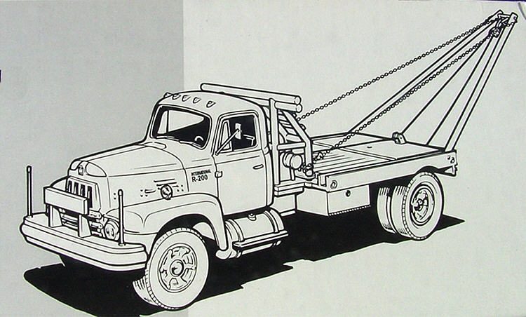

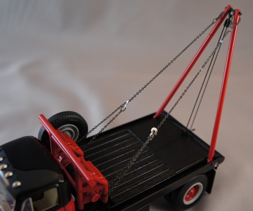

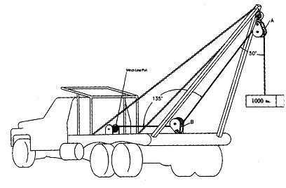

Gin Poles and a big come-along would also work to load them on the trailer.29777d558d96481.jpg GinPoleBox.jpg 1957.International.R-200.detail.rigging.jpg
