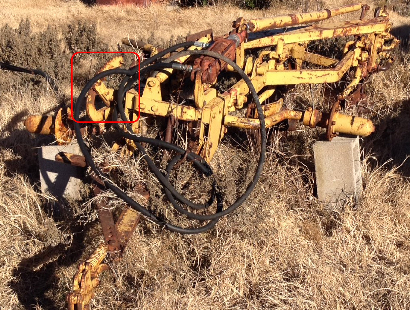

I've studied this equipment pretty closely, and see nothing that could be considered a "transport latch". The PO had one hydraulic cylinder that raised/lowered the wheels on all 3 implements, and just moved it around. That cylinder's status is unknown, but the hydraulic connections laid in the dirt/grass so long that they're unusable.
I know I can come up with solutions, but it would be much simpler if the implements were at my shop.
I'm definitely looking for the right way to do it, but want to make use of this old gear that is really solid and unbelievably priced.
EDIT: I found a picture of the plow, and maybe the area I've highlighted was once a transport latch, or at least a depth control of some sort. You can also see the existing cylinder. I have the wheels off, replacing the ancient/rotted rubber. View attachment 352921
No, I don't think that would be a transport latch. I'd guess you are on the right track that it is a depth control or adjustment some how. Transport latch would simply be a pin inserted somewhere (usually near the hyd cyl) that locks it in full up position. The weight of the equipment bouncing down the road can place huge shock loads on the cyl. If it or the hoses were ever to fail, it would get messy quickly.
As the equipment is in the state of the pic, you'd still likely need the hyd power to get it up on the wheels, depending on seized pivots etc. I'd assumed that the equipment was already mobile, just needed lifting. Based on the pic, I'd get one of the ratchet jacks previously mentioned just to get them home.

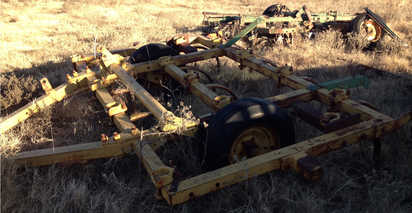

Here's a pic of the chisel, also showing the disc in the background. The chisel is a Krause, the plow is a Case, and I can't find a plate on the disc. 1-2-2014 10-24-10 AM.jpg
If I plan to use (or at least, attempt to use) that cylinder, should just cycling the ram with the hoses off be enough to chase the old fluid out? I have no idea what condition it's in, and don't want it mixed with any of my other systems.
On the Oliver 3 bottom plow we had, a similar lever was used to adjust left vs right tire height.

In the pic of the chisel, there appears to be a second hole on the rear hyd mount below/behind the knotch. I'd suspect that will line up with another hole for the transport pin.
If you want to try using the old hyd hose and cyl, drain them first before connecting. Yes, as you said, cycling with the hoses off (and the ports facing down) will get most of the fluid out and will also give you a chance to see what it looks like. If it looks decent, then don't be worried about the last little bit of fluid. If it looks like crap, then you need to flush the old stuff a bit better. Drain the hoses also.
