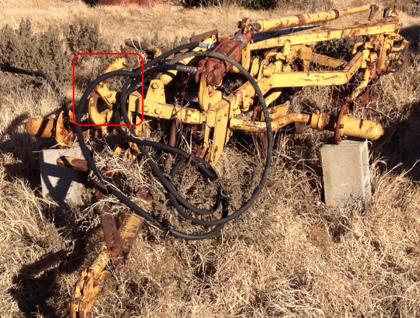

...there appears to be a second hole on the rear hyd mount below/behind the knotch. I'd suspect that will line up with another hole for the transport pin...
Farm Boy - I stand corrected. I took a closer look and found a hole in the chisel frame that lines up with the second hole you mentioned, and a similar setup on the disc. I just need to figure out how to get those holes aligned w/o hydraulic power.
I'm considering taking my small backhoe out there (it will fit on my 16' utility trailer). I believe I can lift one end of the chisel and disc enough to drop the wheels so the transport holes will align. I can also just lift the plow with the FEL and set it on the trailer. May take a few more trips to get it all back home, but doable.
