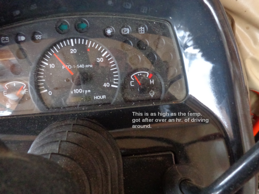

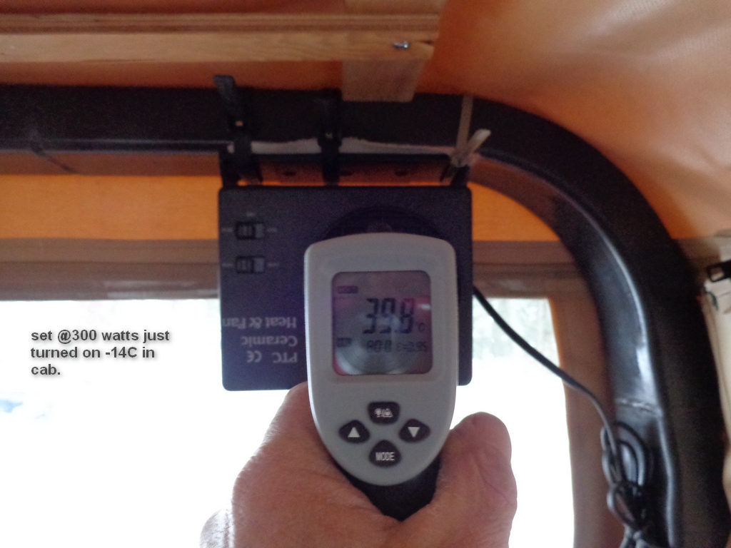

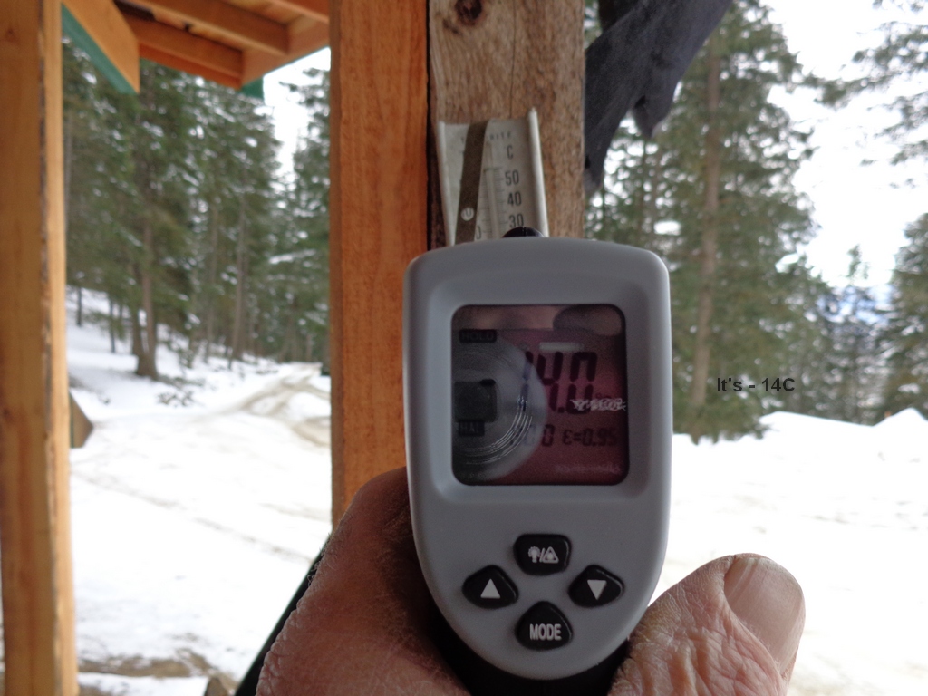

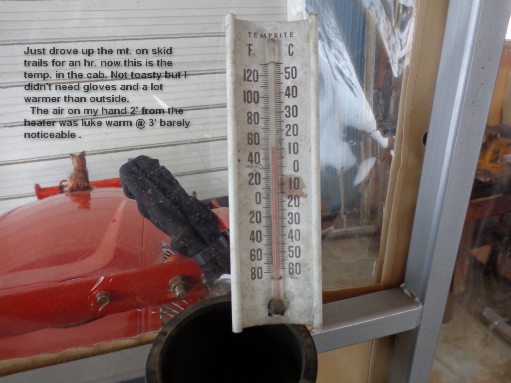

Today I put the 300 watt heater to the test. As my cab comes off 1st thing in the spring I have no desire to have hoses or a permanent heater my main objective was to see if a 12v. would actually make any difference as I'm happy with the fact I even have a cab for winter. I have a glue on oil pan heater and spent yesterday installing a block heater so didn't do the test until this morning. Here's the results.Out side temp.
Turned on the heater then checked temp. for it.
Drove up the mt. for an hr. no gloves or long under wear jacket open cool but not cold. Top of cab is sealed well but not around the bottom area. Temp. in cab when I got back far from hot but warmer than outside.
The engine didn't get very warm either.
Worth it ? but at least anyone considering buying on new can know what to expect. At colder than when I did the test there would be very little improvement if 10 degrees warmer I'm sure there would be a noticeable dif. in temp.
