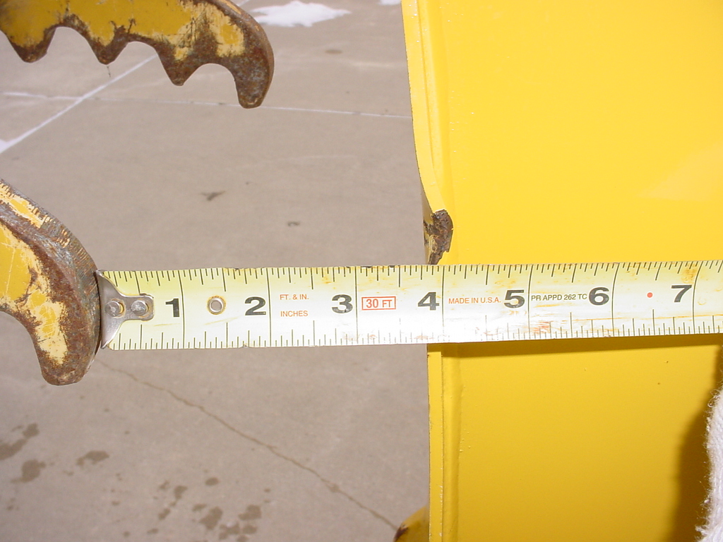

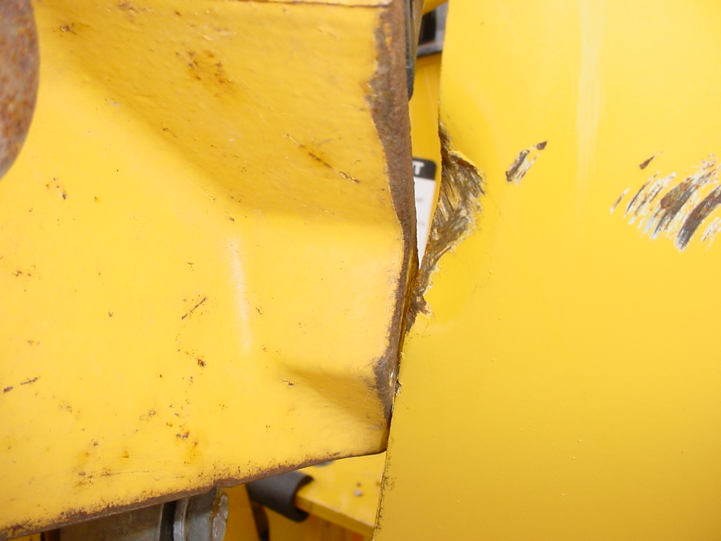

Ok... here's when I'll have to admit to making a dumb @ss move with my 110 backhoe! :) 'Cause I've got a dent along the edge of my boom arm - just like that!!! :mad:
If you leave the stabilizers in the up position and swing the hoe from side to side.... well, the backhoe is NOT designed to do that! And those darn stabilizer feet will absolutely crimp and roll it over; that 1/2" (might be 5/8") thick plate steel! Aaarrggh!
I only did it on one side, though... that was enough. 'Course, if you were in a full-blown swing motion - it would/is very hard to stop that motion with those legs up - the whole back end of the tractor is swaying! And you could crimp both edges.

Stopped by the shed where the 110 is parked after collecting the chicken eggs and replacing some straw in their egg-boxes. Haven't really moved it much during the past 2 winters. The cab tractor has been getting most of the snow work!

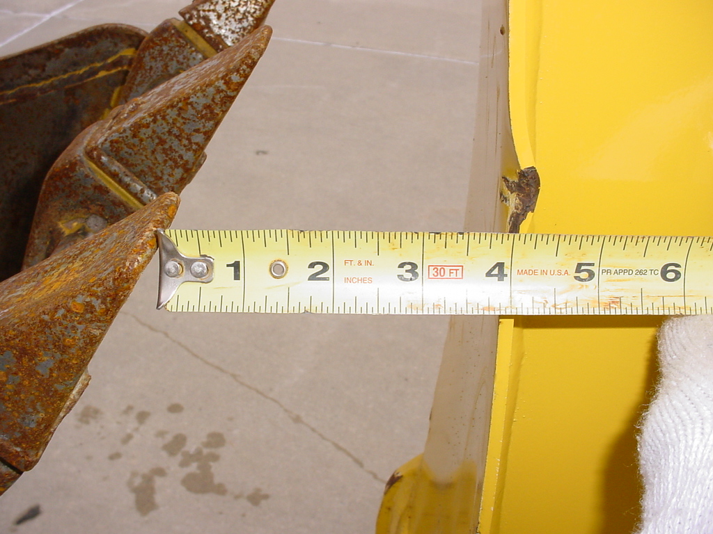

Nonetheless, I looked the boom and dipperstick over to make a mental comparison to mechatgsk's and DocDryden's backhoe's. First off, the plate thickness along the boom arm and dipperstick arm face is only 1/4" - not 1/2" - my bad... memory! :)
And, my hoe does NOT have the wear plate along the bottom of the dipperstick - like mechatgsk's machine. I have a couple of paint nicks where the back of the thumb has made contact with the dipper but no significant damage.
Of course, the curled over edge on the boom arm from the stabilizer foot is still there...
AKfish
   / 110 tlb thumb question? #34

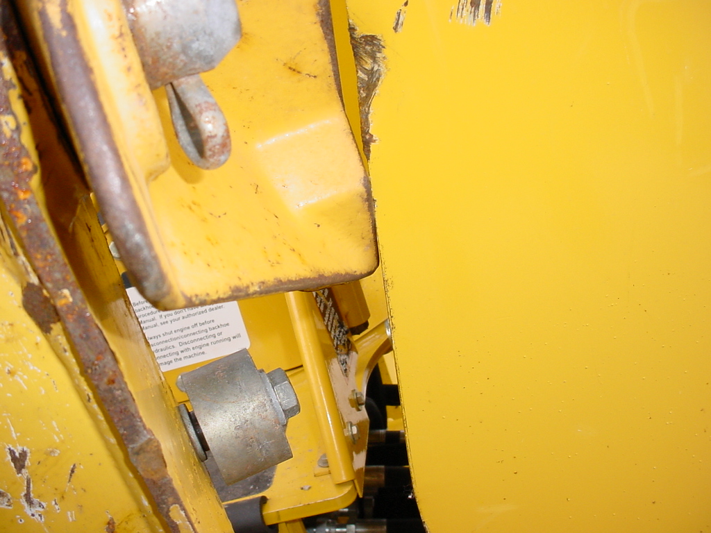

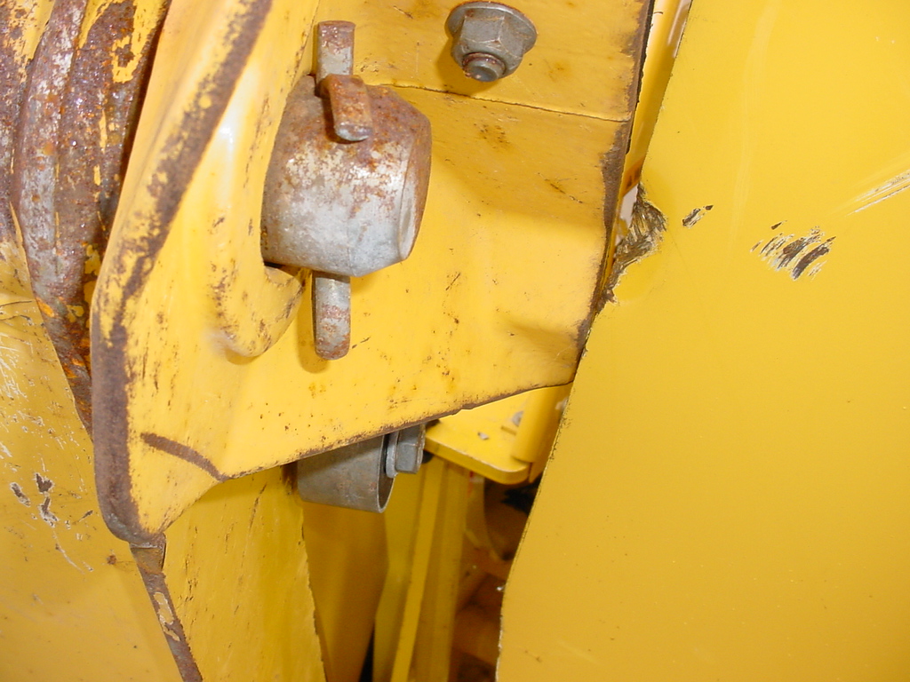

Well as you can see in photo #1 it was not the Thumb, or the bucket teeth photo # 2.
Just as Akfish said it was the stabilizer foot. Photos # 3, 4, 5, I could not sleep last night thinking about this. My hats off to you Akfish you were right. I never would have thought it was the stabilizer foot. Now I know to be careful when I swing that boom with the stabilizers up. And as far the contact stop plate, I can live without it.. Just a note my previous tractor was a Ferguson TO-20 so this 110 is a BIG step up for me. THANKS to ALL
