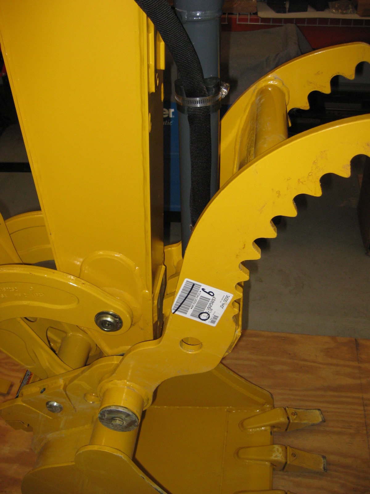

Hello, I have recently installed my thumb kit from John Deere that I purchased with the tractor in 2011. I finally got to use it yesterday and it worked fine. I used it to pick up a few logs about 8 to 10 inches in diameter and 4 to 6 feet long. After I was finished I was looking over the thumb and welded brackets. (1) one that attaches the cylinder to dipperstick (2) the thumb contact plate on dipperstick. Now here on the thumb contact plate I noticed it was bent inward slightly, as well as the dipperstick. Now when I say slightly I mean approximately 0.025. I put a machined straight edge across the top of the 1/4 thick by 2"x 4" inch weld on contact plate. I installed the thumb exactly as John Deere said to in the instructions. I also know the thumb will contact this plate each time it is retracted and this thumb is heavy. No, I have not tried to slam the thumb into the contact plate but sometimes it did move at a faster speed than I would like. I was not aware this may happen. I do know that John Deere revised this contact plate from two plates (1/4 inch lower plate similar to cylinder plate and a 3/4" top block) to the single 1/4 inch thick by 2"x 4" plate that I received with my kit. I do think the contact plate should extend far enough across dipperstick to rest on top of the verticle plates of dipperstick and not between them as it is now. And maybe duplicate the original design?
I was wondering if anyone had experienced this? :(
Thanks,

Thumbs are notorious for getting bent from the operator applying to much pressure against something.
/ 110 tlb thumb question?
Hello sdkubota, I'm sorry you did not understand the question. The thumb is not getting bent, it's the thumb retract plate and dipperstick.
Mechatgsk
/ 110 tlb thumb question? #5
Maybe cylinder too short?

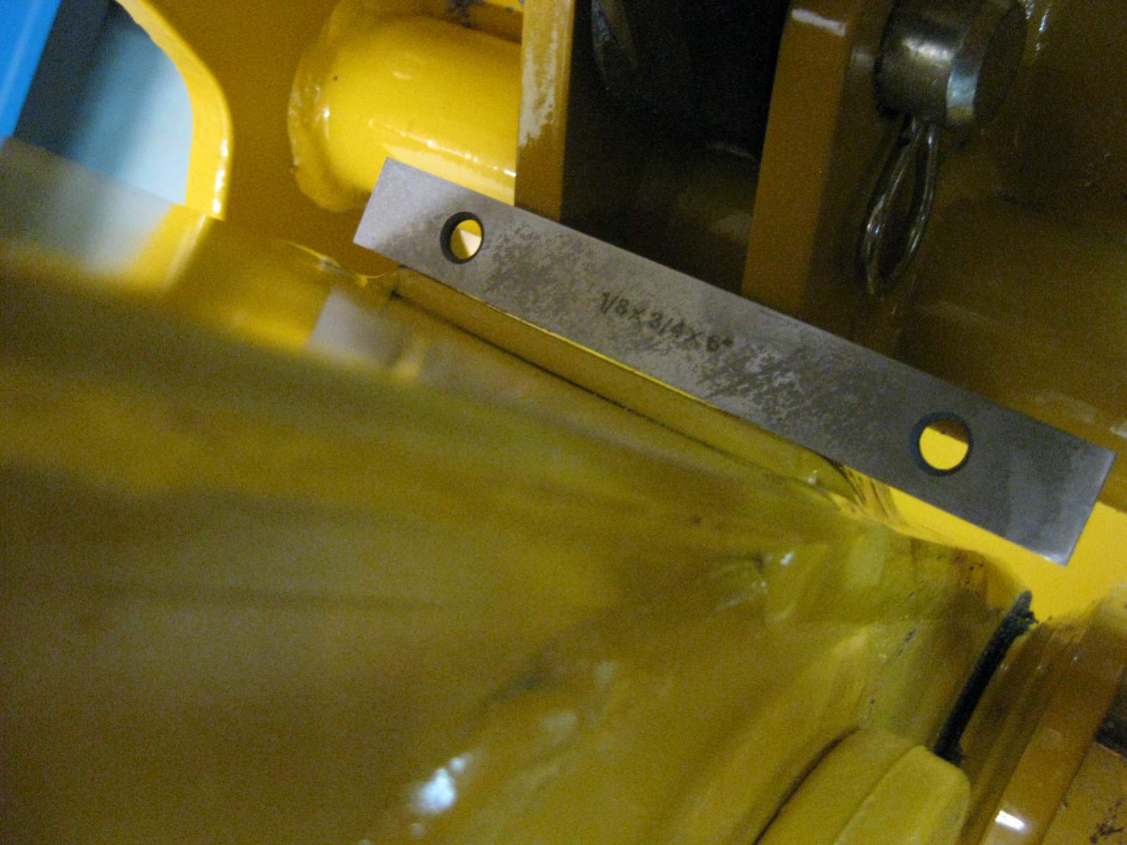

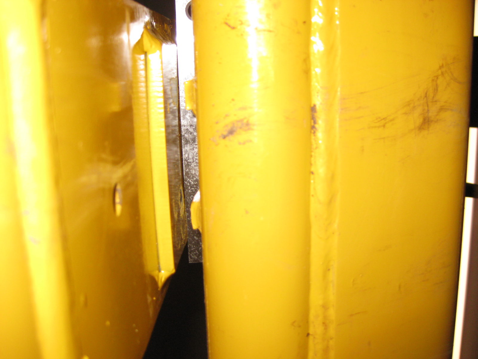

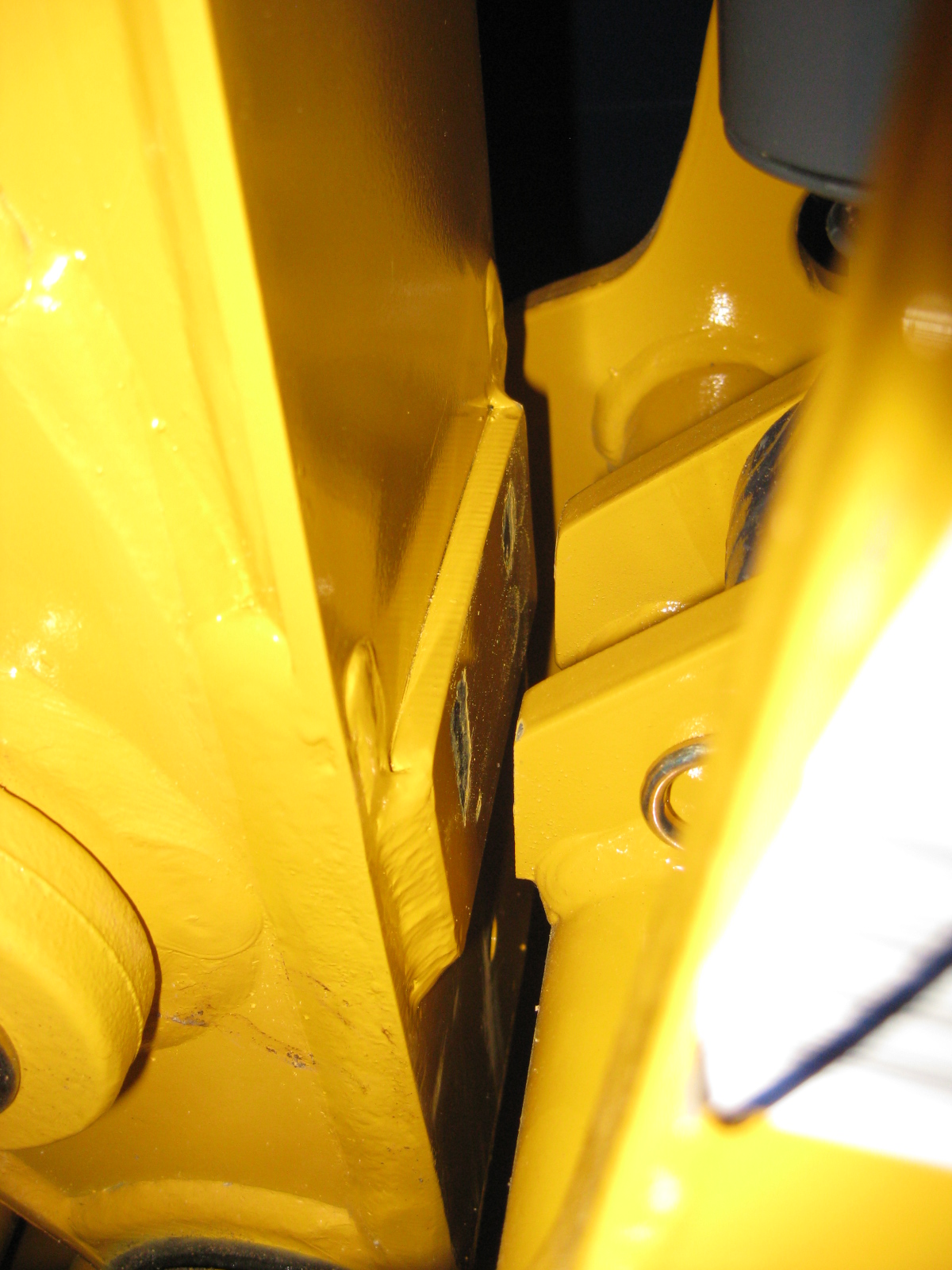

Hello frencht, I added some photos for all to see what I am talking about. Note: This small indentation happened after only 2 hours of operation and I only used the thumb 5 or 6 times.
Hi murphy1244, the cylinder is the one that John Deere sent with thumb kit. It is the correct part. I think it is a combination of two things. One...the new design of the retract plate is too small (length and width) and 2nd..the contact points on the thumb are too close together causing them to touch in the middle of contact plate. I feel if the thumb contact points were spaced apart to about 3.750 to 4.0 inches and a larger contact plate fabricated this would help tremendously. Another thing to remember is the outside measurment of the two verticle plates of the dipperstick are set at 4-3/8". The inner face plate of dipperstick is just slightly over 5.0" wide and also onlt 3/16" thick material. Then you have a small contact plate that is 1/4" thick by 2"x 4"?
Mechatgsk

Ok.... now I'm gonna be polite and take your concerns to heart. Really! I'm gonna try my best! :thumbsup: Twenty-five thousandths? I saw the gap. And you're fairly certain (and you checked) that the deformation was not there prior to using the thumb?
It's not the result of heat warpage from the welding process?
I would offer a perspective on what's likely to occur as you use your backhoe and thumb in the future. That gap is most likely to be anywhere from 1/8" to 3/16" by the time you have 1,000 hours on your machine. Yup...
Now, if you'd like to avoid that situation - I can offer you a freight quote - one way to my house.
AKfish
/ 110 tlb thumb question? #10
I take unlike your other cylinders the control valve does not slow it and and stop it automatically at the end of the stroke preventing a hard high speed contact?
It clanks... sometimes at the end of the cylinder stroke. As the pins begin to wear with hours of use; there's even more "slop" and the motion of the thumb (and every other moving component on the hoe and loader, etc.) does not conform to the same "stop and go" extension limits as when new.
We all note that same operational characteristics with machines as they get worn out...
By the way; the thumb cylinder operational pressure is 2,500psi and the curl function on the bucket is 3,000psi. So, with a clamped load as you curl the bucket the thumb will slowly yield without blowing a seal in the thumb cylinder or blowing a hose.

However, I do not believe that you're being realistic with either your concerns or your expectations regarding the thumb install. The metal contact strip is a wear item. It's sole purpose is to protect the dipperstick and deflect the strike energies from the thumb.
It has no effect upon the structural integrity of the dipperstick. So, gap or no gap either before use or sometime down the road is not that significant.
And it will wear... and the contact points on the backside of the thumb will wear. And the gap will become greater over time and use.
It's a backhoe. Not a surgical instrument or a machine to pick cherries with.

AKfish, I accept your apology. I agree to some extent about your concerns...I'm a mechanic/machinist/metal fabricator by trade...and I'm also a perfectionist with most everything I do. I know the wear (contact plate) plate is not designed to give structural integrity to the dipperstick. My main concern is the indentation of the dipperstick. Just a note..this dipperstick alone cost $3,600.00 dollars. I know this can be done better to prevent this from happening. I will show you how I do it here on this forum. I also know this is a backhoe...but it's way more than that to me. I have dreamed of owning one of these machines. And I finally got to purchase this one in 2011. I have owned several new John Deere tractors prior to this 110 tlb and I can honestly say it's the best all around tractor I have owned. I wanted one tractor to do a variety of jobs. I do all my own work around home and this tractor helps out tremendously. I really enjoy operating it! AKFish, thanks for the compliment on the install. Have a great afternoon! :)
