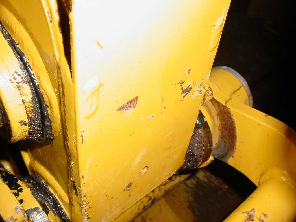

in this photo you can see that someone closed the arm with the thumb opened and did some damage

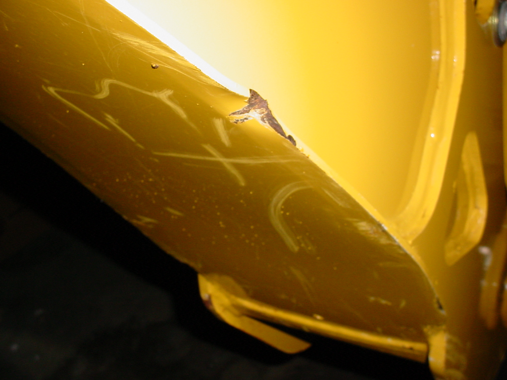

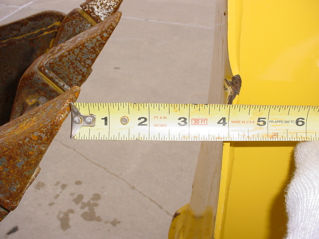

Was this done with an OEM JD thumb like showed in the first post on this thread?
To me it looks more like marks made by the bucket teeth.
maybe your right, i just assumed that it was from the thumb

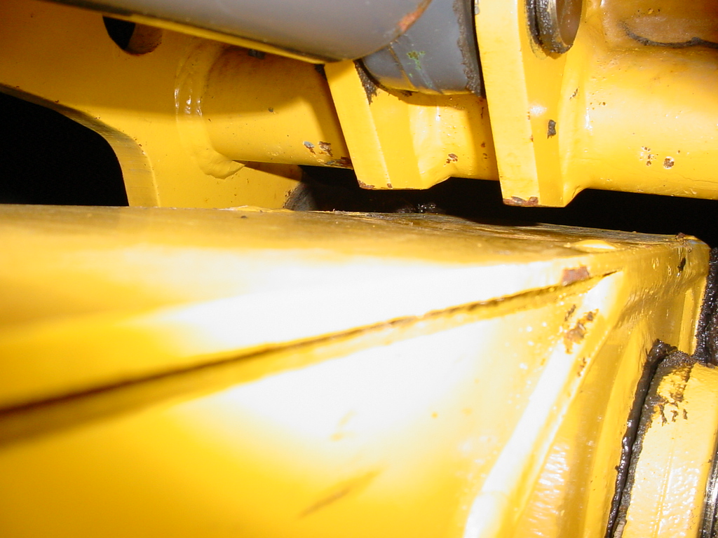

Ok... here's when I'll have to admit to making a dumb @ss move with my 110 backhoe! :) 'Cause I've got a dent along the edge of my boom arm - just like that!!! :mad:
If you leave the stabilizers in the up position and swing the hoe from side to side.... well, the backhoe is NOT designed to do that! And those darn stabilizer feet will absolutely crimp and roll it over; that 1/2" (might be 5/8") thick plate steel! Aaarrggh!
I only did it on one side, though... that was enough. 'Course, if you were in a full-blown swing motion - it would/is very hard to stop that motion with those legs up - the whole back end of the tractor is swaying! And you could crimp both edges.

Based on our JD 310 hoe I do not think JD would design anything that would interfere with another part of the hoe. The bucket teeth (longer after market teeth) gets close but still clears. Our weld on manual aftermarket thumb will not interfere in any possible setting from max to closed positions. We tacked it on then tested in each possible position before proceeding with the mounting process.
Now our hoe bucket was made for another model/brand machine and someone cut off the old bucket below the pins and welded on the current bucket and got a very slight bit of angle in the process so the thumb teeth do not always mesh well with the bucket teeth but that is only an issue when closing the bucket to travel.

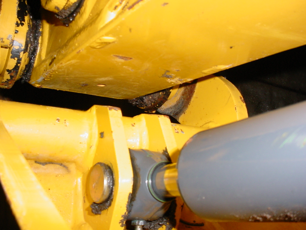

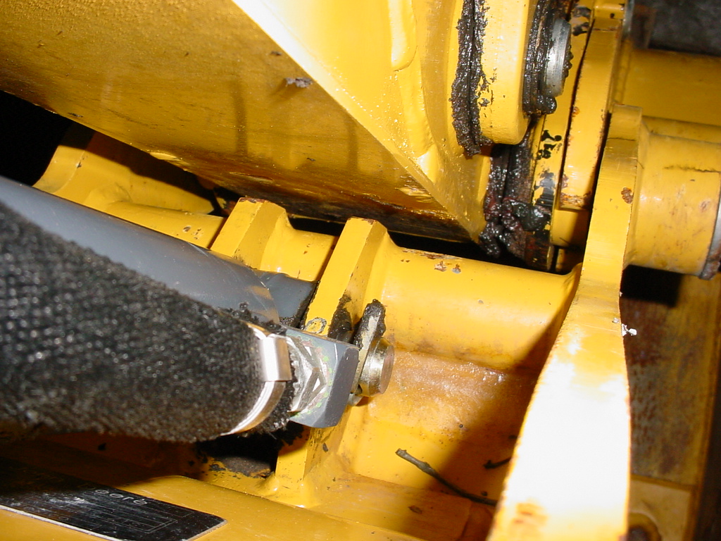

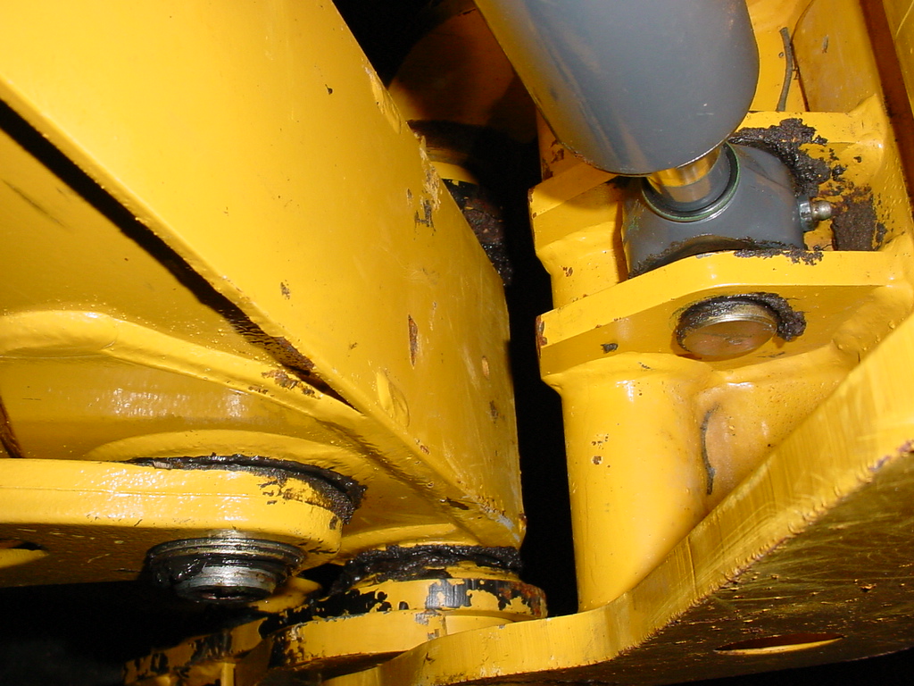

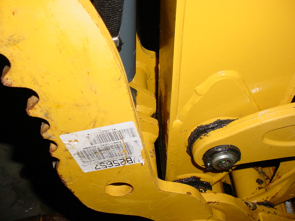

/ 110 tlb thumb question? #34

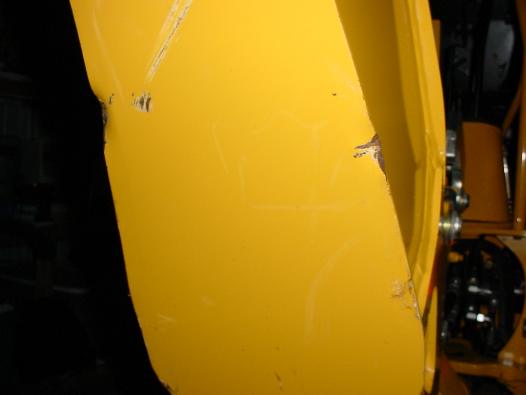

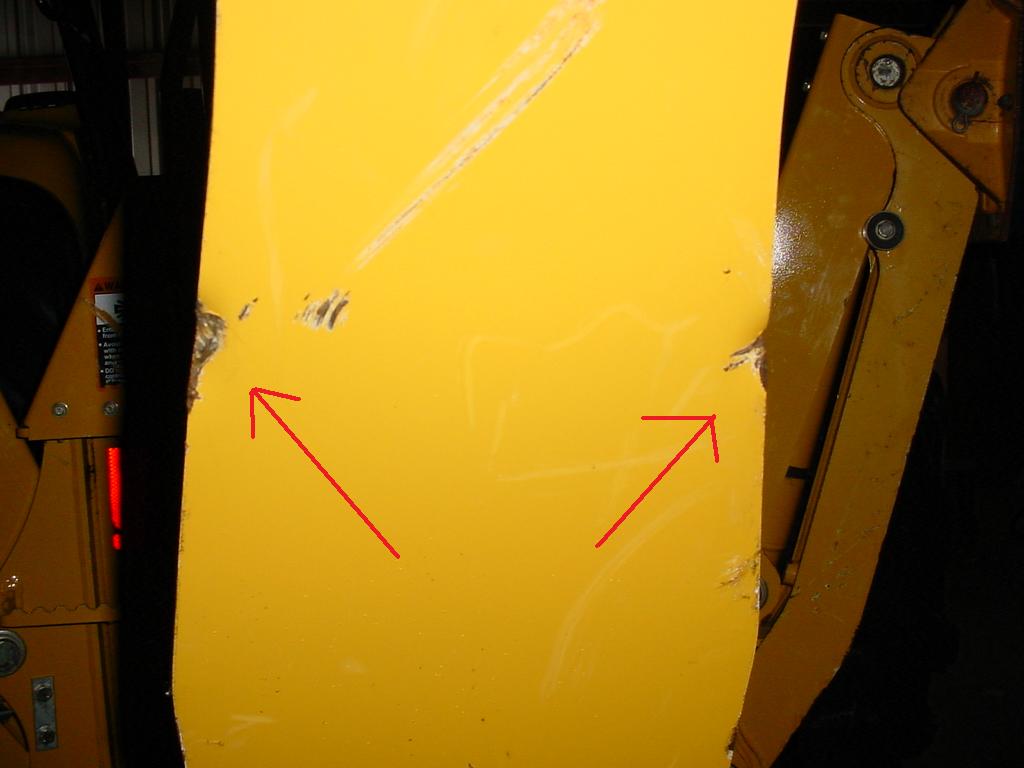

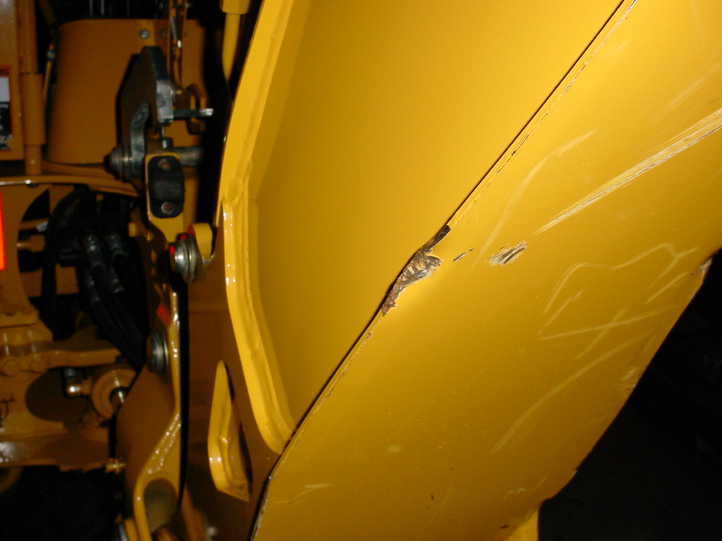

Well as you can see in photo #1 it was not the Thumb, or the bucket teeth photo # 2.
Just as Akfish said it was the stabilizer foot. Photos # 3, 4, 5, I could not sleep last night thinking about this. My hats off to you Akfish you were right. I never would have thought it was the stabilizer foot. Now I know to be careful when I swing that boom with the stabilizers up. And as far the contact stop plate, I can live without it.. Just a note my previous tractor was a Ferguson TO-20 so this 110 is a BIG step up for me. THANKS to ALL
1 110 Thumb 1.JPG 2 110 Thumb 2.JPG 3110 Thumb 3.JPG 4 110 Thumb 4.JPG 110 Thumb 5.JPG5
/ 110 tlb thumb question? #35
Holy Mackerel Batman, Them darn stabes! Good job Fish.

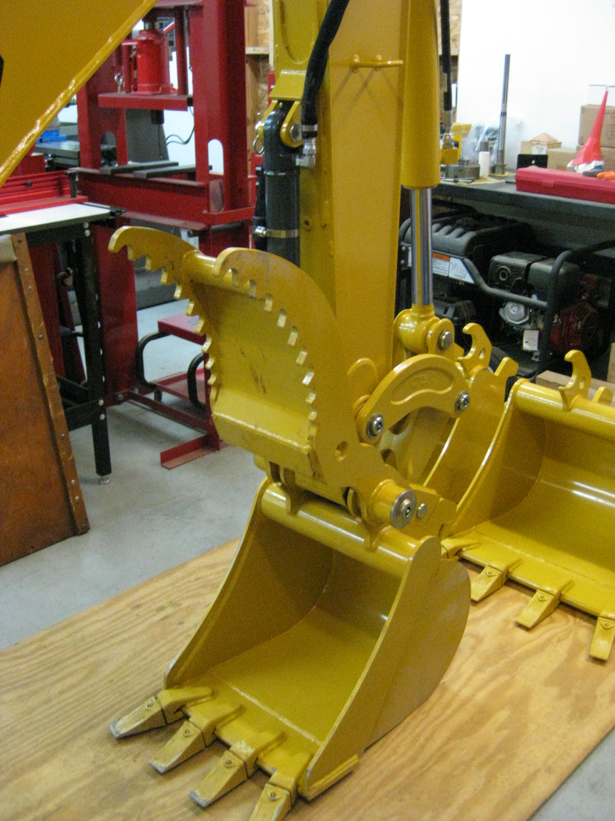

Doc
Just a quick note about your thumb, yes it needs the stop welded on the boom.
Retract your thumb all the way up then with your hand push up on it and watch your cylinder. You will see that it is trying to push the ram in more, and it is already all the way in. The weld on stop is there to protect your cylinder on the ram. Curl your bucket up carefully and it will contact the thumb and push the thumb up some more which will put pressure on the thumb cyl ram.
Ihope this helps
