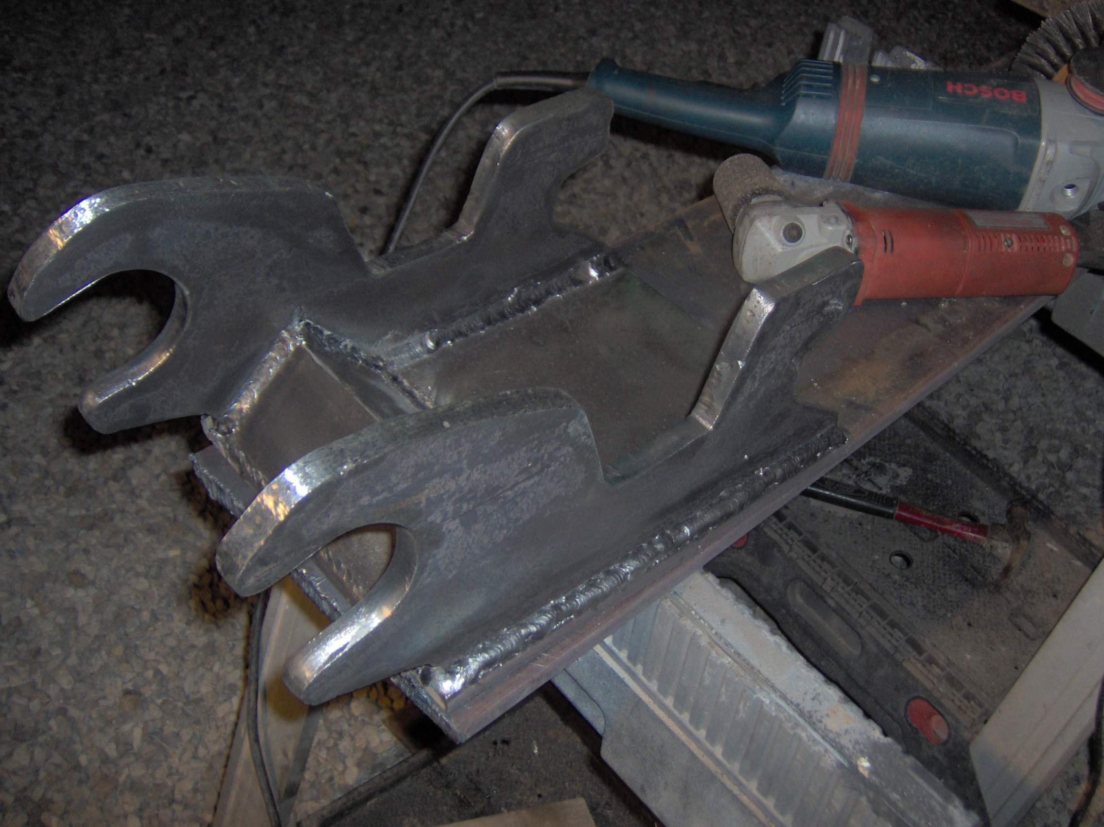

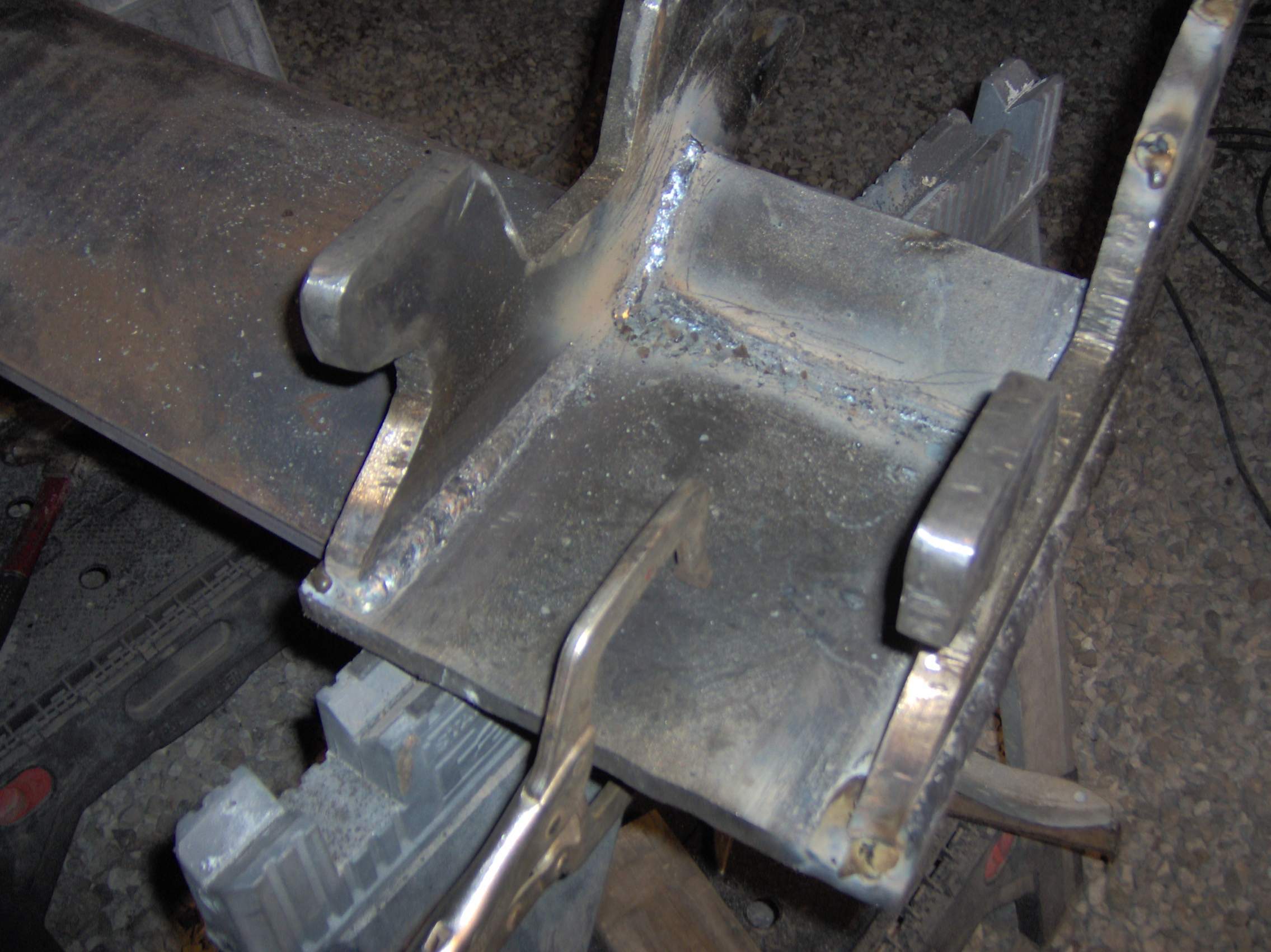

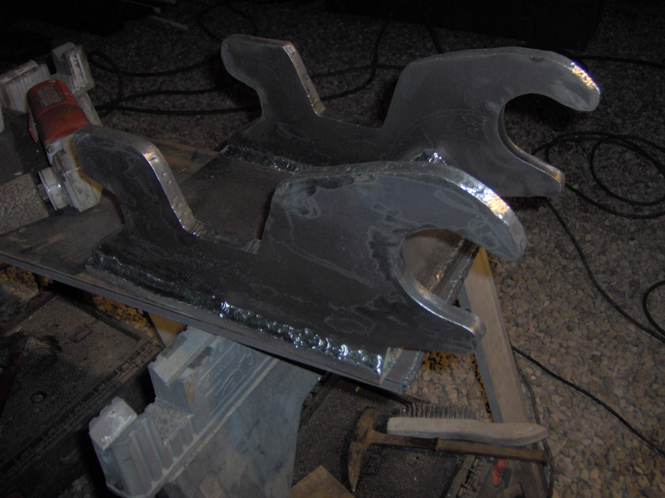

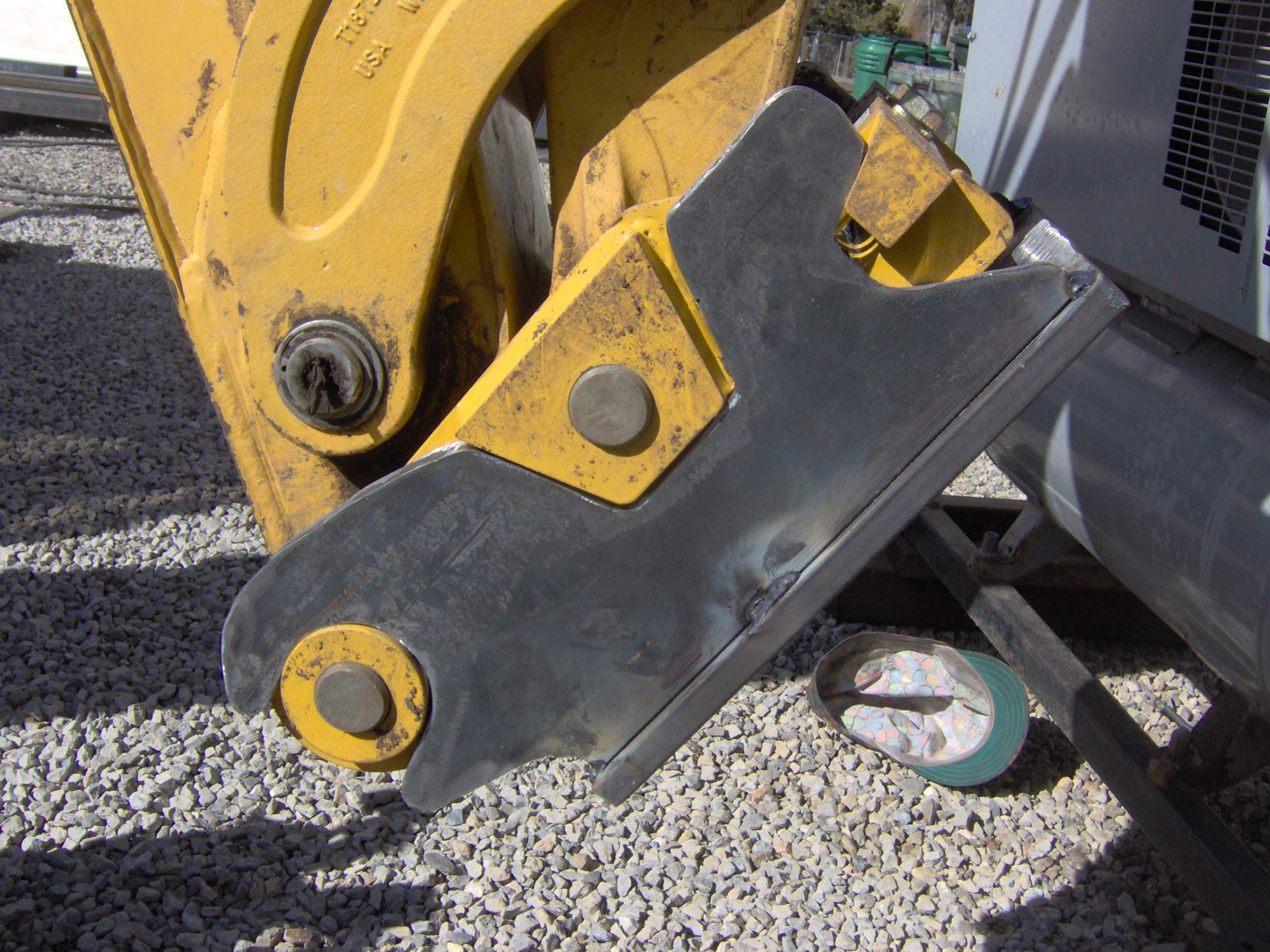

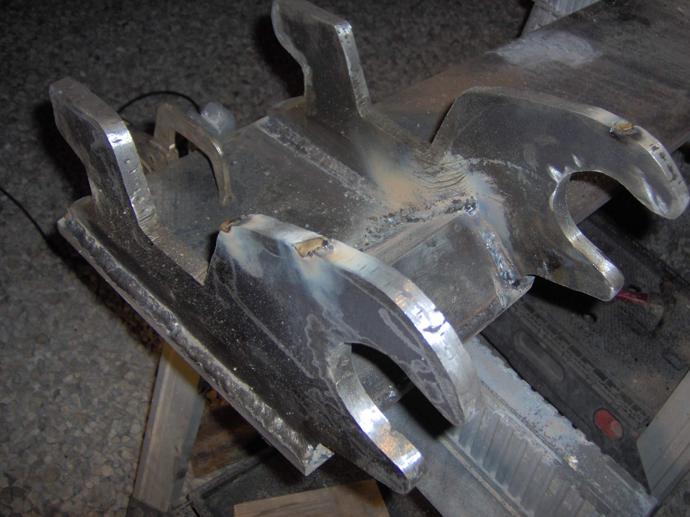

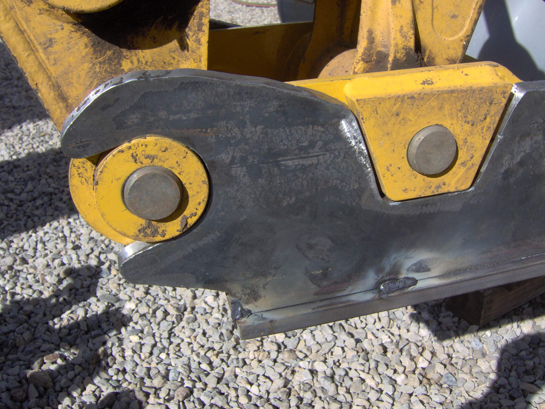

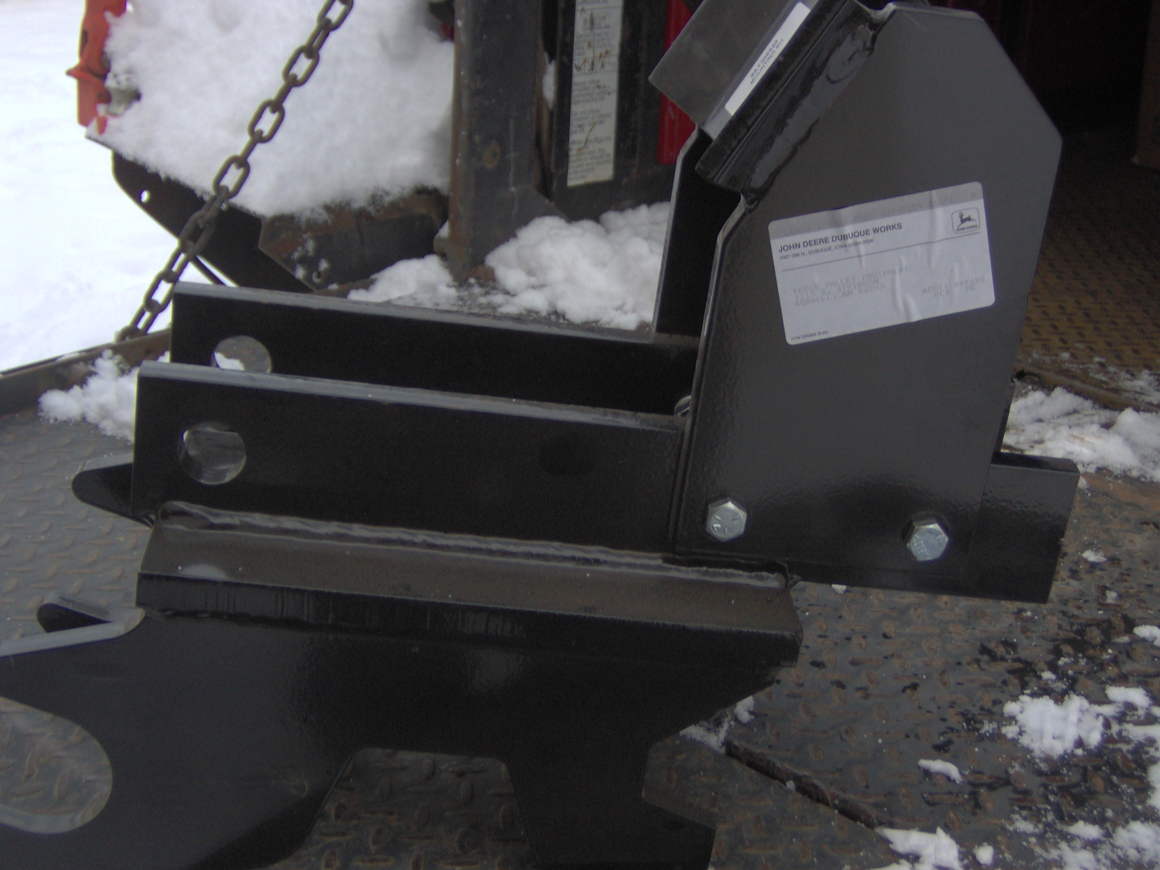

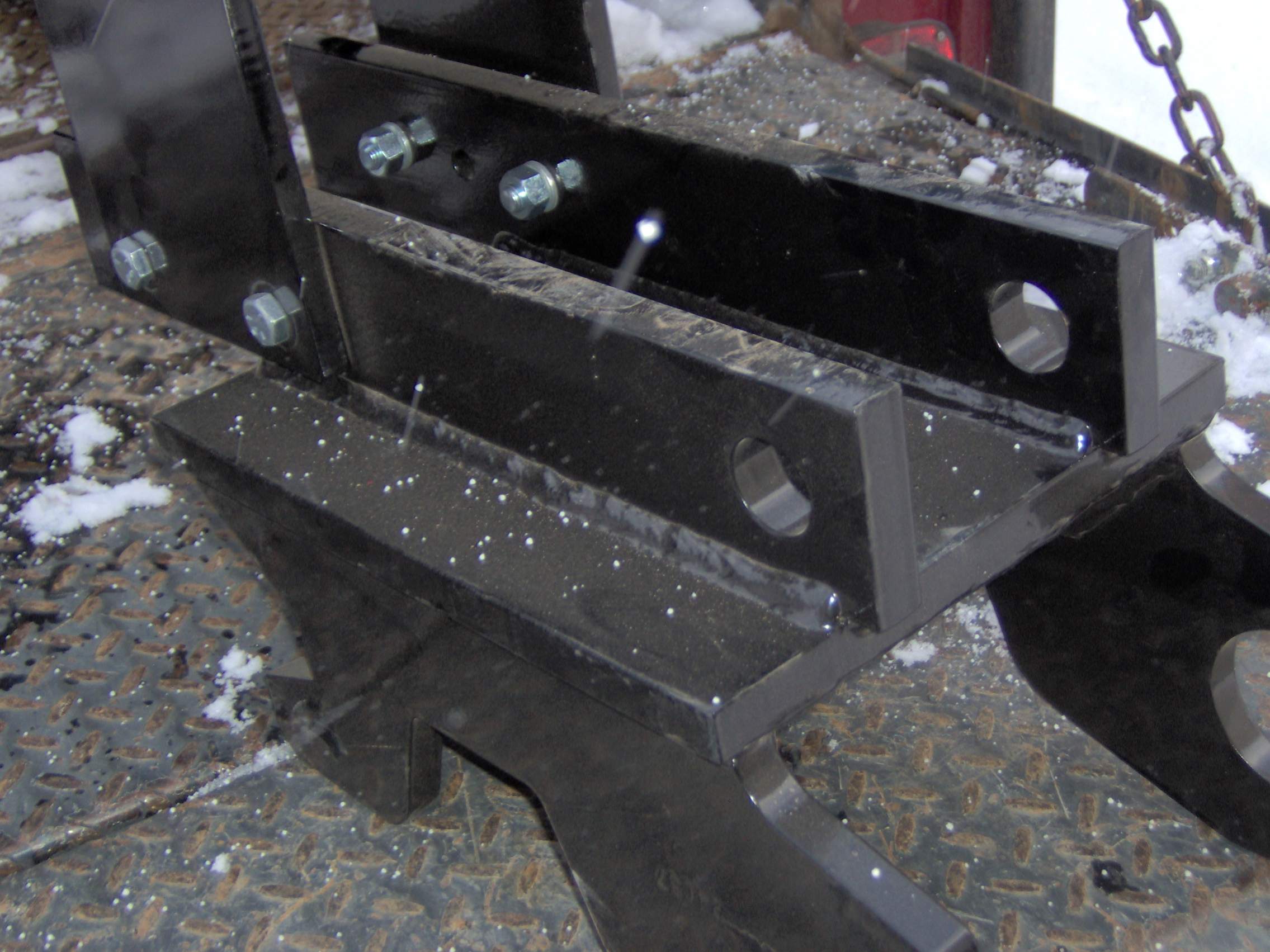

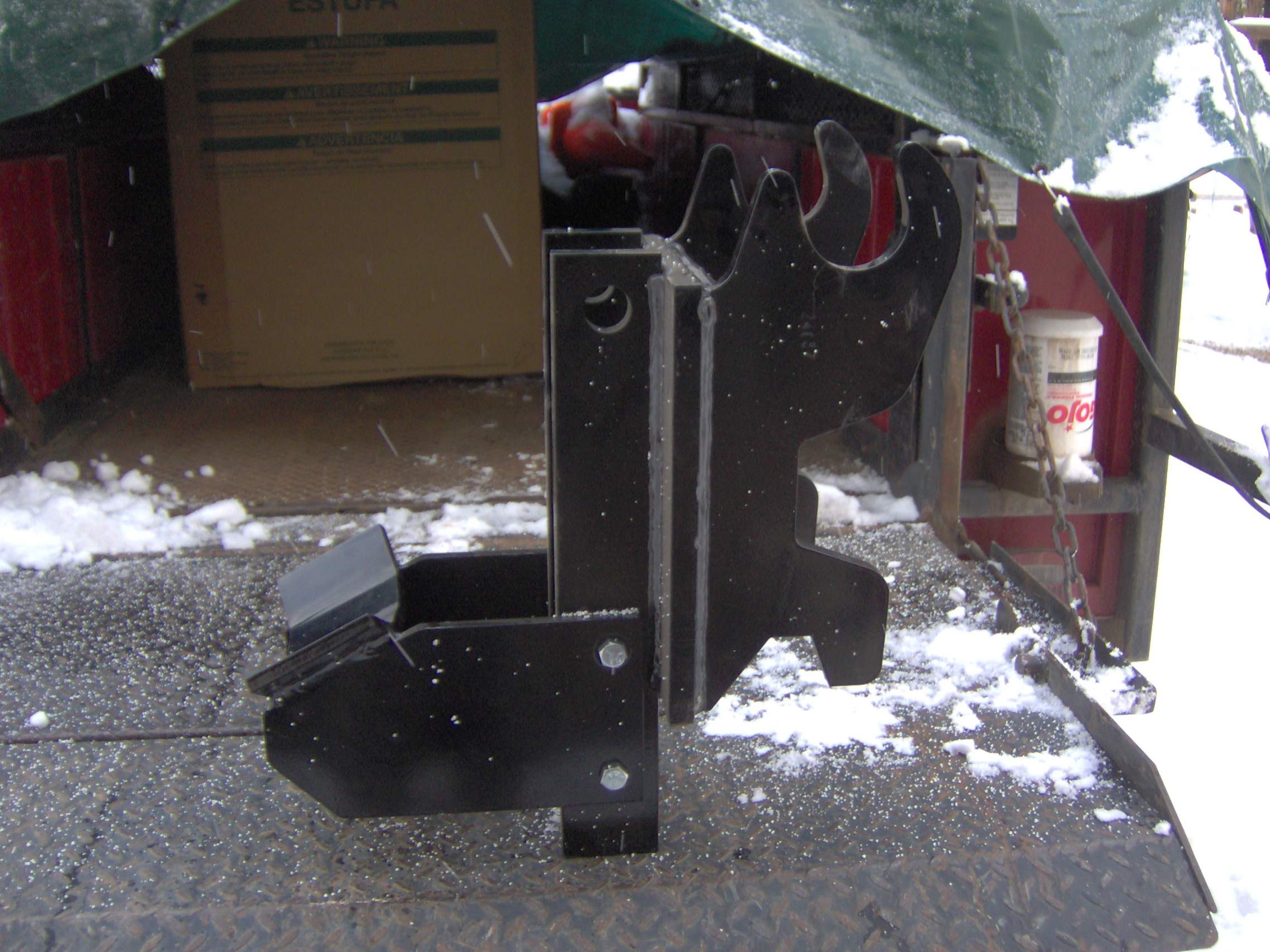

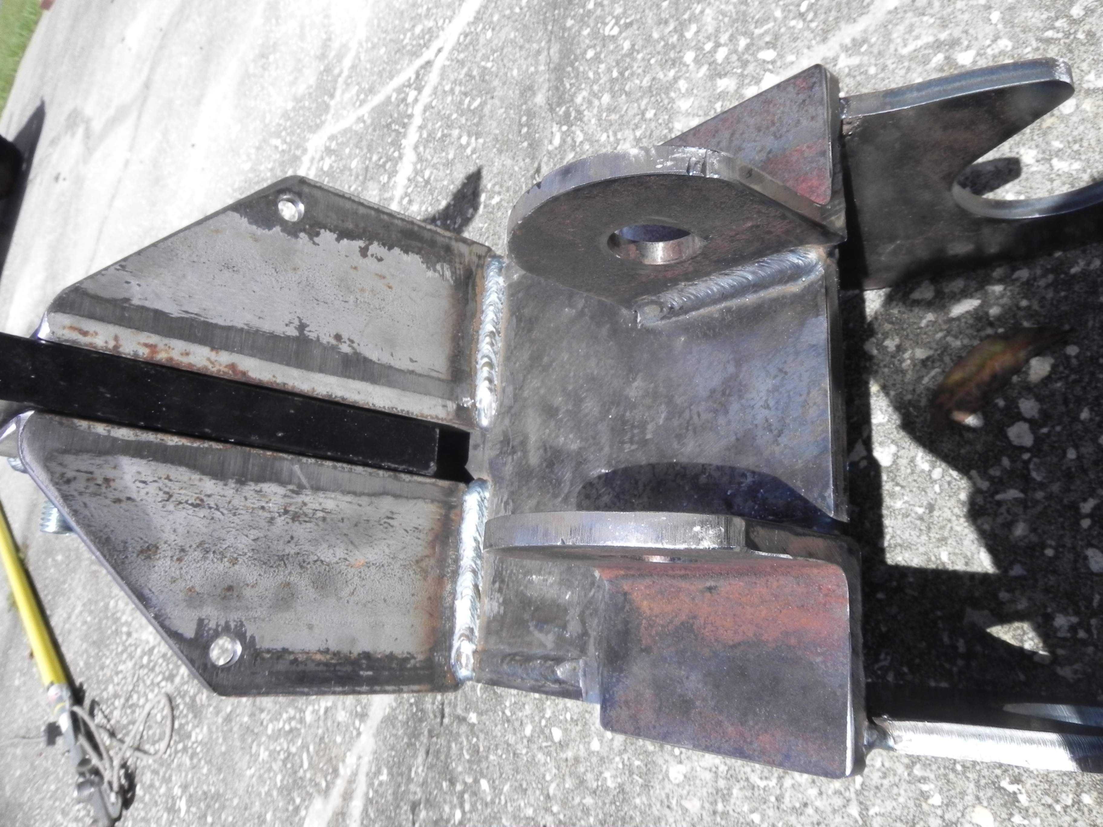

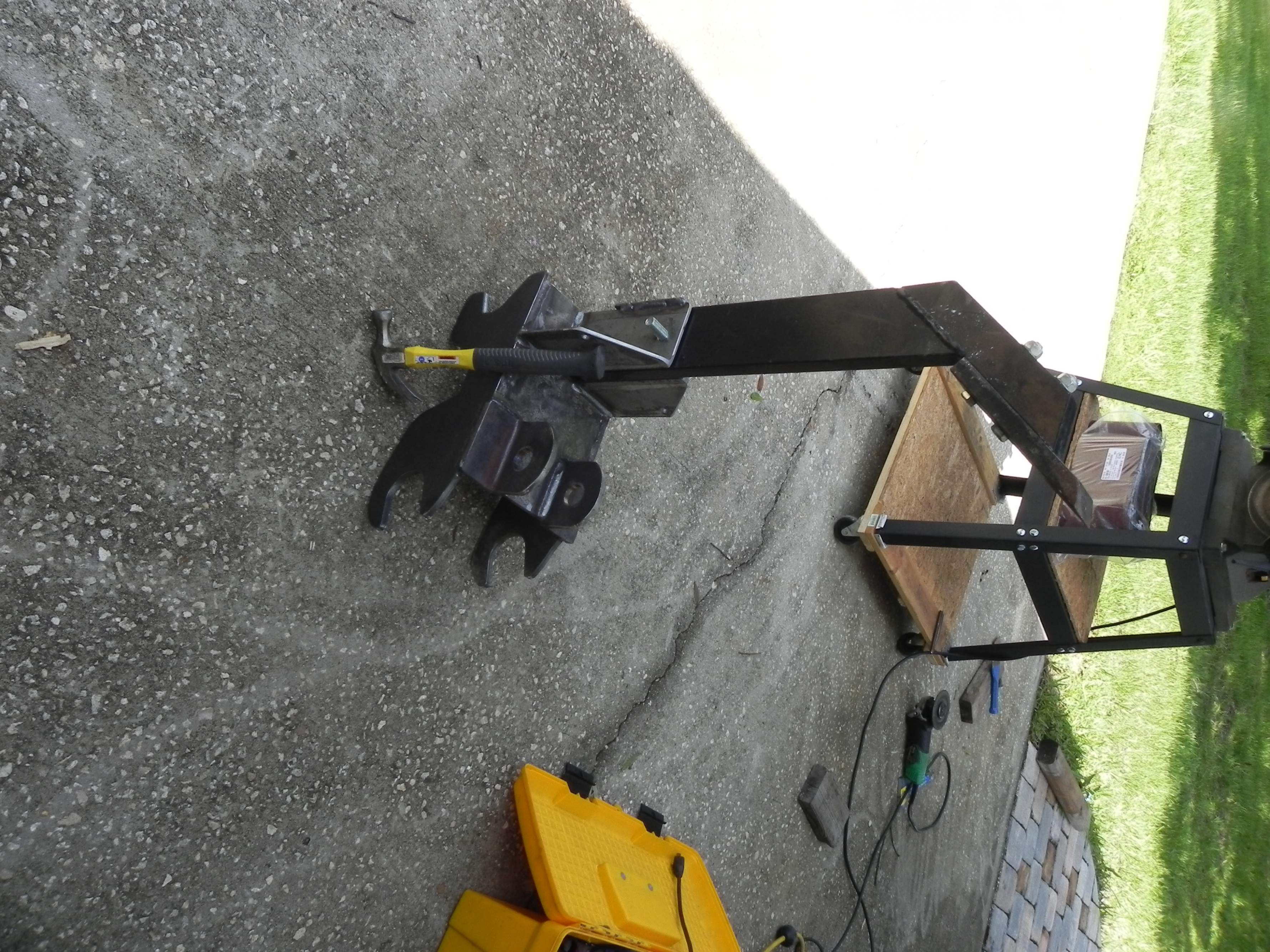

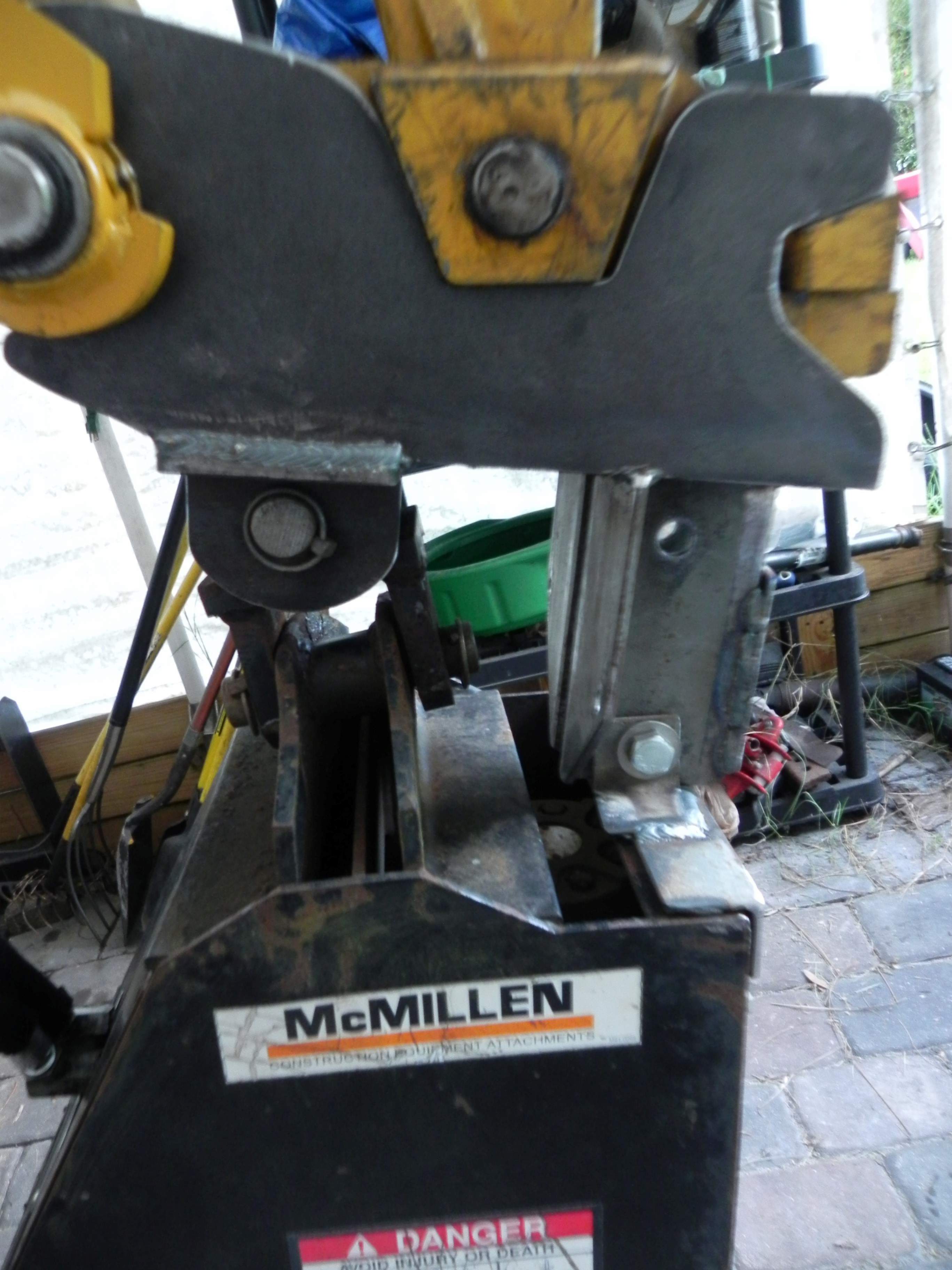

Here are some pics of a mount I built for Curly Dave a few years ago. I may have the patterns for the side plate if you want them. The last two pictures are of the factory mount,
Steve this really helps me visualize the mount! Did you torch cut the QC parts? I've got a steel fab shop 1/2 mile from me. I was going to drop off my root rake with them for the templet and have them fab me up two of the blanks like you made. One I would use for the auger and I was going to have the other setup for a lifting eye. I located another McMillan auger but it's an older model, I ran the serial with Mac and they indicate it's an 89-90. Parts are still available but I'm not sure it's worth the risk as the seller has no means to demo it and it's likely a 8 hr drive to get it.

I used my Victor torch to cut out the parts. I would add I considered the chain drive but felt the planetary drive was a better design for high torque applications. I have had mine for about 5 years now with no problems. The last picture is complete with the cradle mounting.

Steve, can you actually rest the gear box on the cradle with a bit on it? Any pics of the whole set up on the 110?

You can use the cradle with the bit in place no problem. I have two bits a 6" and a 12" and these are good for about 42" to 48" max depth. When loading on a trailer just make sure the bits are held up high with the dipper stick raised.
My backhoe is on a job right now but I can take more pictures when I get it home.
