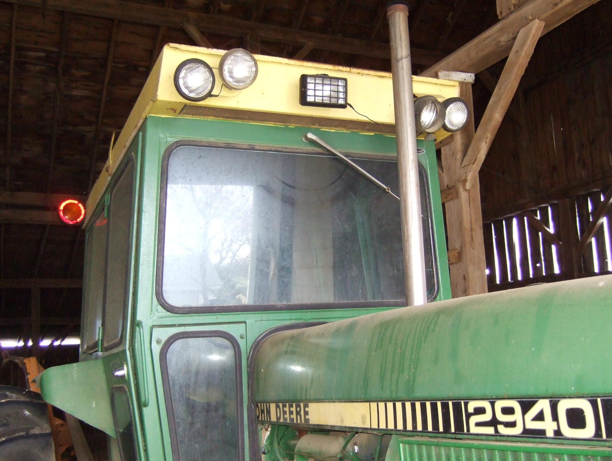

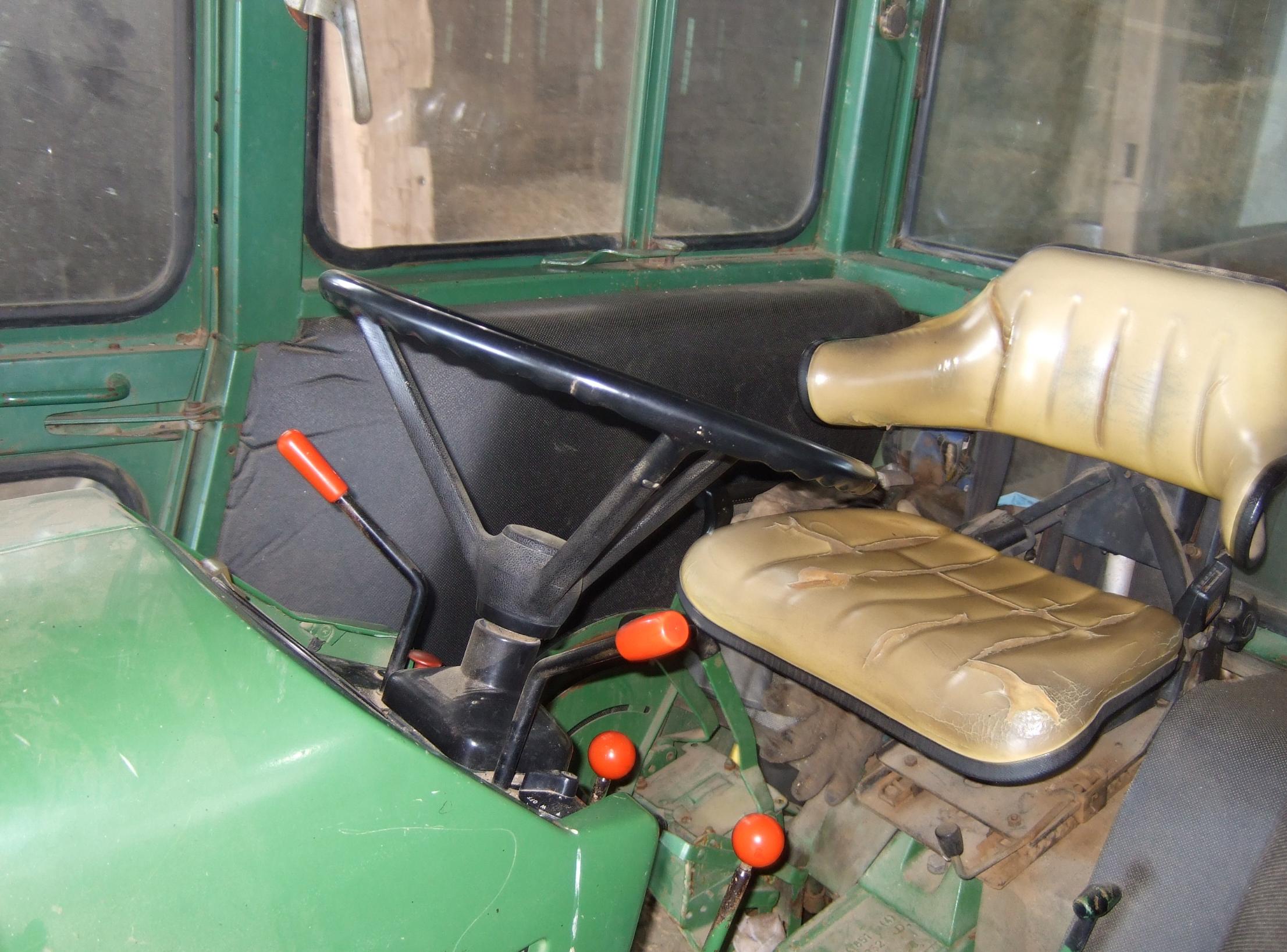

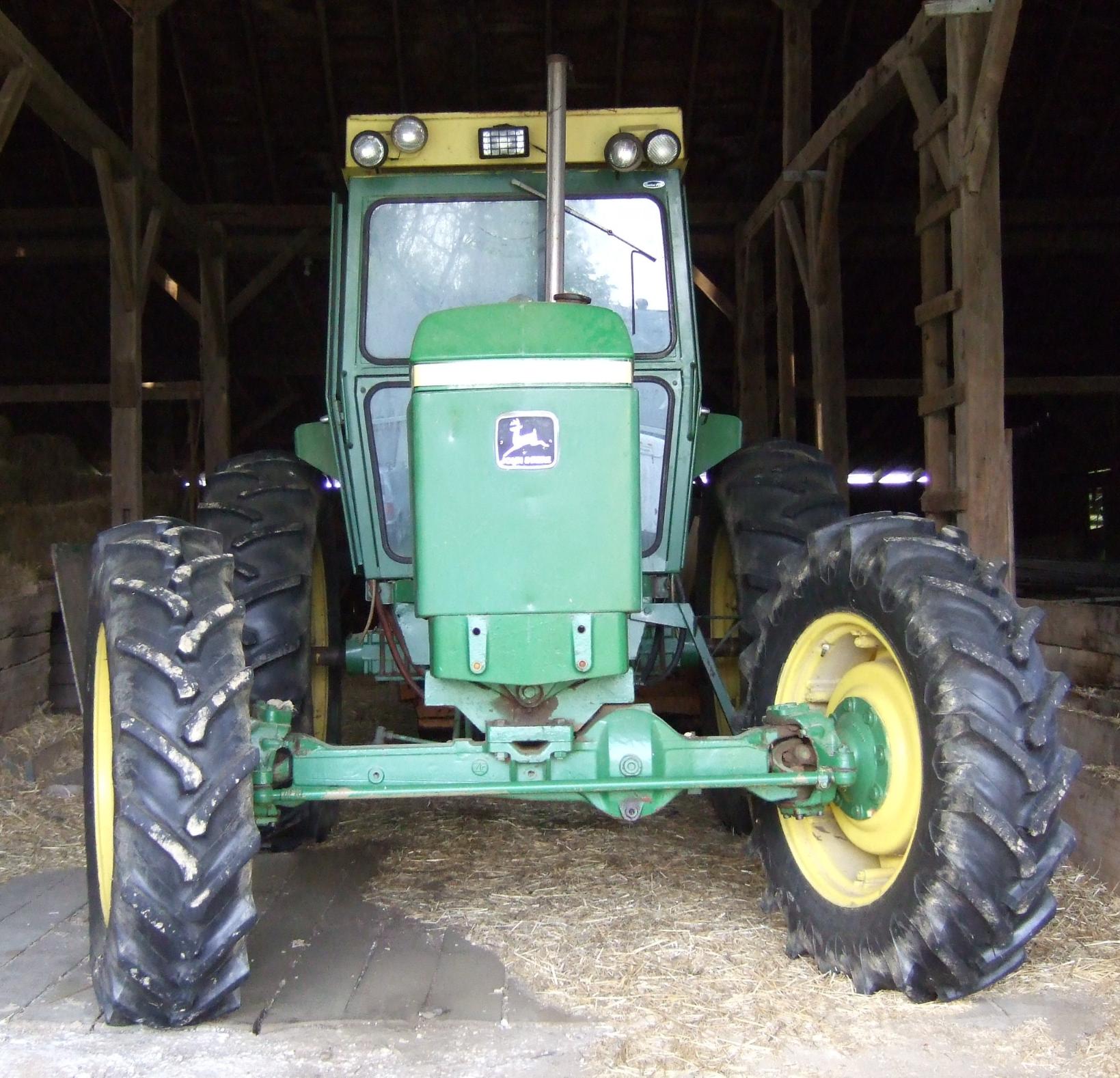

Here are some pictures of the 2940. Any thoughts from anyone?

The 2940's cab isn't going to be very quiet compared to the 4440. Those older style cabs would amplify noise. Still looks to be a fairly decent tractor.
The 4440 and the hydrostatic front drive axle would be good for what you have in mind. That front axle isn't the best set-up for hard pulling drawbar loads, but they offer good control in mud and slick conditions. Also, they don't have the later "positive castor steering" of the 50 series MFWDs. Turning radius isn't quite as sharp as later models. The 4440 is one of the best tractors ever built by ANY brand. The 466 cu. in. engine is a torquer. They have a brilliant reputation. Is it a powershift or quadrange? In any event, it's common to see a 4440 sell well over $20,000 in average condition. The Soundgaurd cab was a giant breakthrough in quiet comfort. (My 4250 had the SG cab and I LOVED it) All things being equal, I'd rather own the 4440.

The cab on the 2940 looks like a Hiniker which was one of the best at the time but that isn't saying much. They are noisy and you will want ear plugs while you operate it.
I am not too fond of the Soundgard cab design but it is much nicer then the Hiniker and if you plan on spending long hours during the warm season in this tractor find one that has a good, comfortable cab as you will thank yourself every time you use it.
