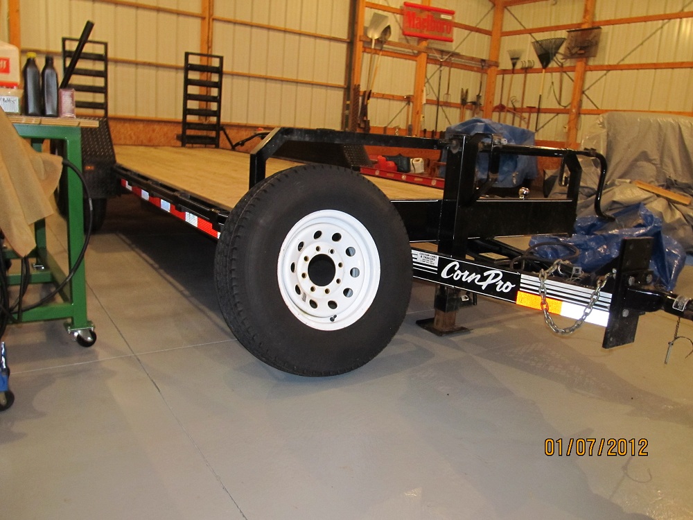

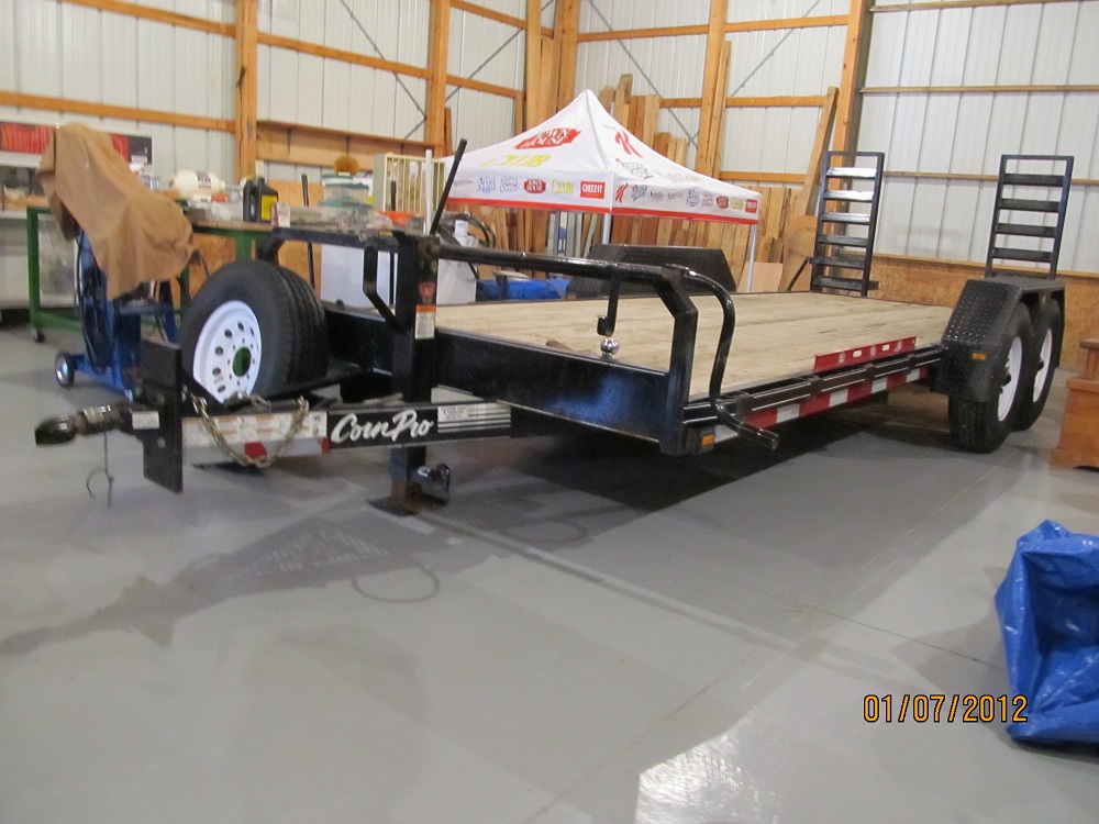

Thanks for all your help. With the advice offered I would up with an 18' Corn Pro 12,000 lb HD trailer.
Thanks all for steering me in the right direction. It's used but very little. I am happy as a clam. Photo attached.

That is one sweet trailer! :licking:
Very similar to mine except I have the 3/4-1/4 tilt bed. No ramps.
I really like the heavy duty adjustable crank jack. :thumbsup:
You should be happy. that looks like a great HD trailer, especially love the jack!
Just a goofy name, but you can always cover it :)
How much $ ?
JB.
