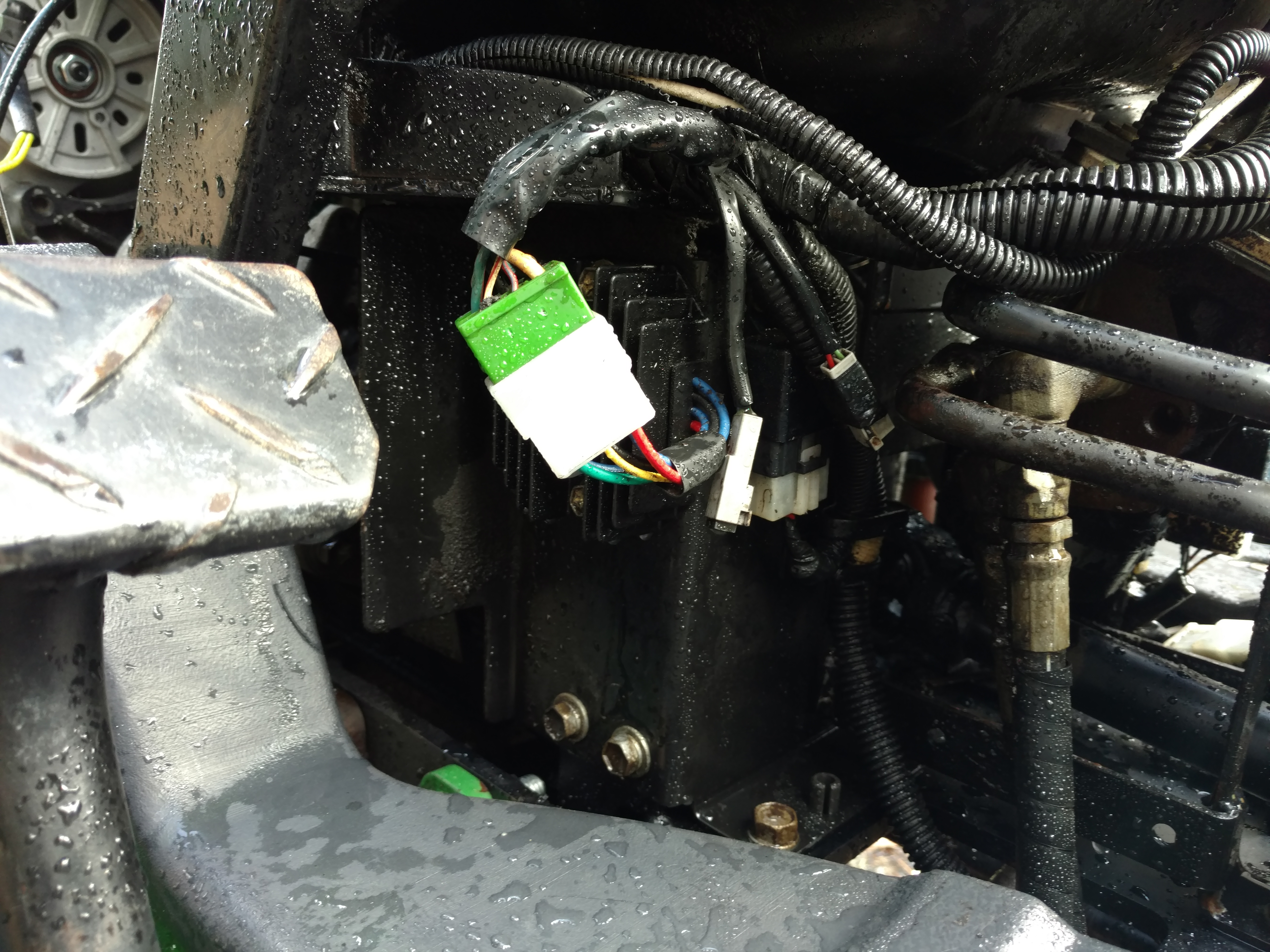

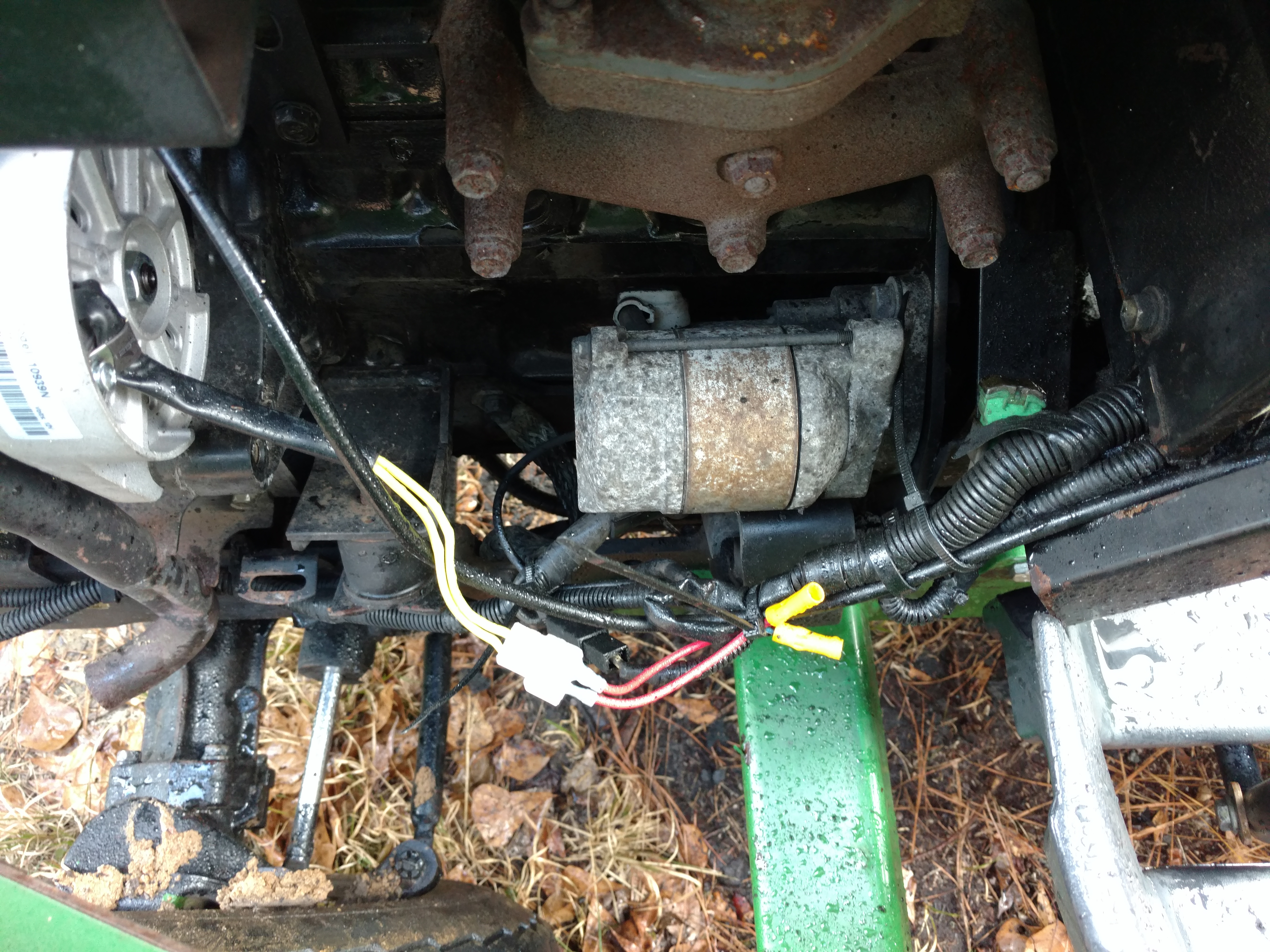

Can you post some pictures showing the alternator or dynamo, the starter, battery and cables.
Are you working from a WSM or wiring diagram? If so can you make it available to me so way.

You likely have a dynamo not an alternator which is why I need some photos plse.

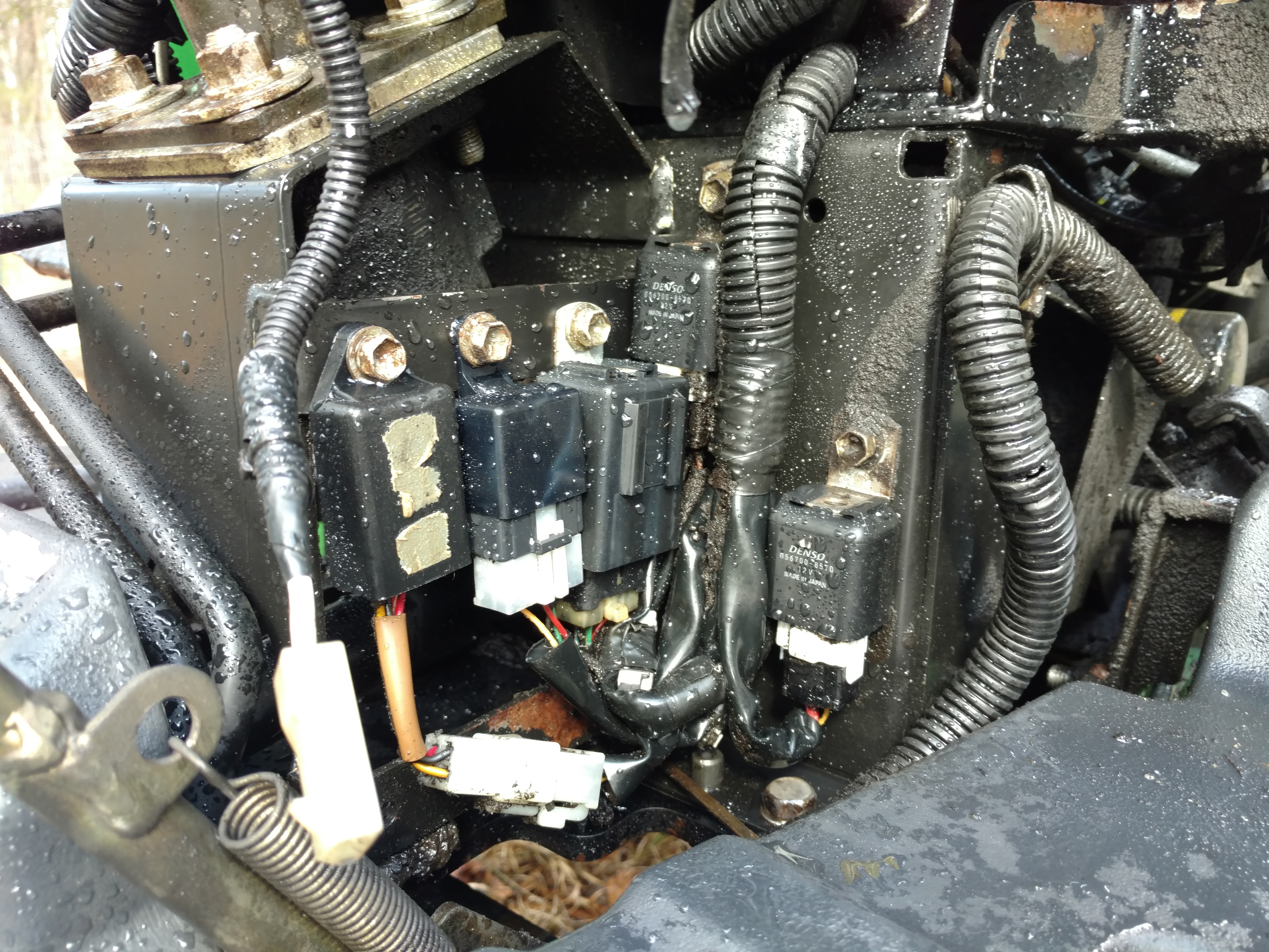

FOUND THE PROBLEM!!!!!
There is a relay right next to the voltage regulator ...I swapped it out with one just like it from the other side of the tractor (no idea what that one is for yet but its charging !!!!! no idea how to order a new one as there are no markings on it at all lol

Although you found the cause of your lack of charging, my friend just came up with a WSM.
For the future, here is the charging circuit.
The tractors wiring has about 8 diodes including V6
The safety relay K3 and its diode V6 is to protect the regulator from reverse battery polarity.
The WSM also comments:
Diodes usually fail in the open position but can fail shorted. If any problems in charging circuit check both V6 and V8 diodes.
I expect the relay would be the same as most automotive headlight relays.
I am surprised the relay was the issue as it is just a battery voltage sensing circuit carrying no real power that would burn the contacts.
