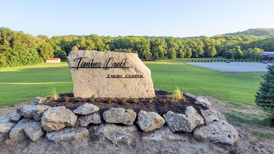

Pic for reference. I mow 6 acres for our wedding venue every Thursday. 72" Exmark Lazer Z X-series. It takes me 1 hour 45 minutes to mow everything, there's more not showing in the pic. It will throw grass evenly no clumps even in damp conditions. I have never had to clean out the underside of the deck. (one of the great things about exmark mowers) It has turf tires and will climb any slope when dry. You will raise the front tires before you run out of traction uphill but it will not climb worth a darn when wet. It will also not back up a slope in either condition and is worthless in muddy conditions. I was also amazed at the difference in time when switching from a 60" to 72" deck. When considering a zero I would highly recommend looking at the difference in speed between the homeowner and commercial versions if they have both. Dad had a 60" exmark pioneer (homeowners version) and it was painfully slow the time I had to borrow it.

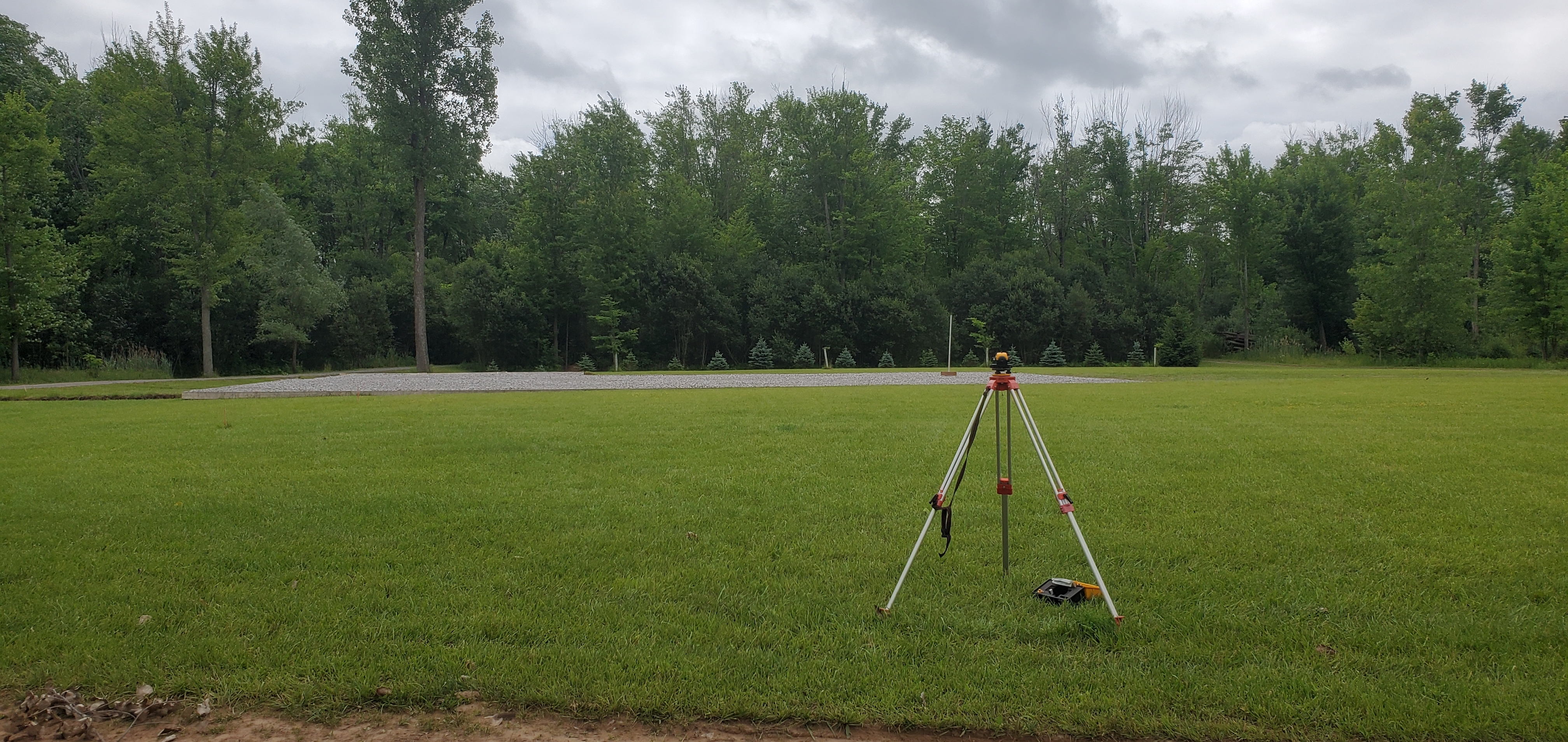

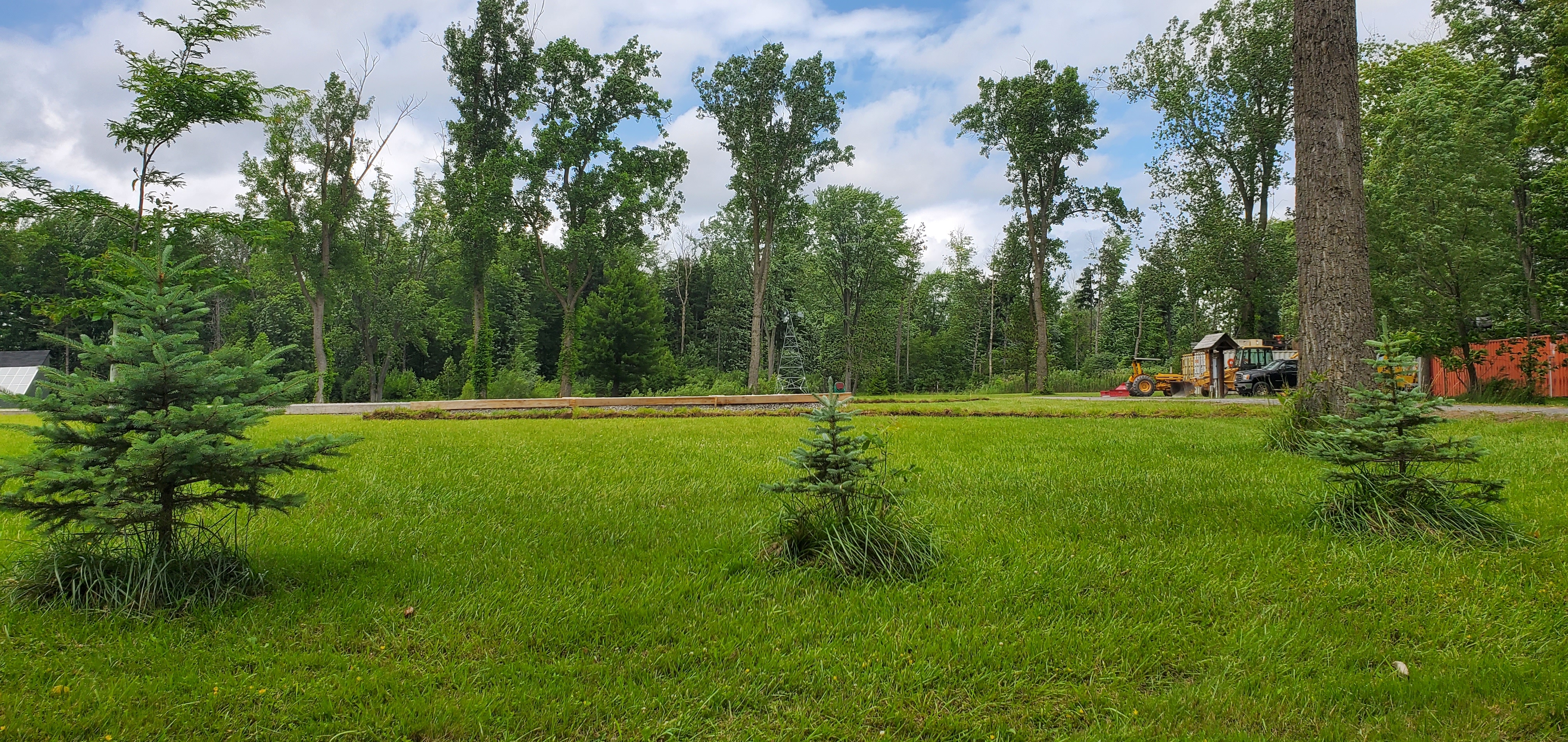

Lawn: (not all of it in these pics, but most of the 7 acres looks like this).
My building has decreased the mowing acreage a bit. And I am going to be digging one more pond. All said and done I'll still be mowing ~6 acres of lawn, not field. But a lot of mowing around ponds and in ditches.
I'm going to sit on the ZTR idea for a bit, not looking to make a rash decision.

Those pictures look like mostly flat areas with obstacles where a ZTR would do fine. What about the steep areas?
   / Zero turn vs. 4X4 tractor for mowing
#99
The worst slope is about 700ft of ditch at the road, maybe 25 degrees The pond banks slope is about 4:1, and another 1400ft of drainage swale that is wet all the way up until July.
