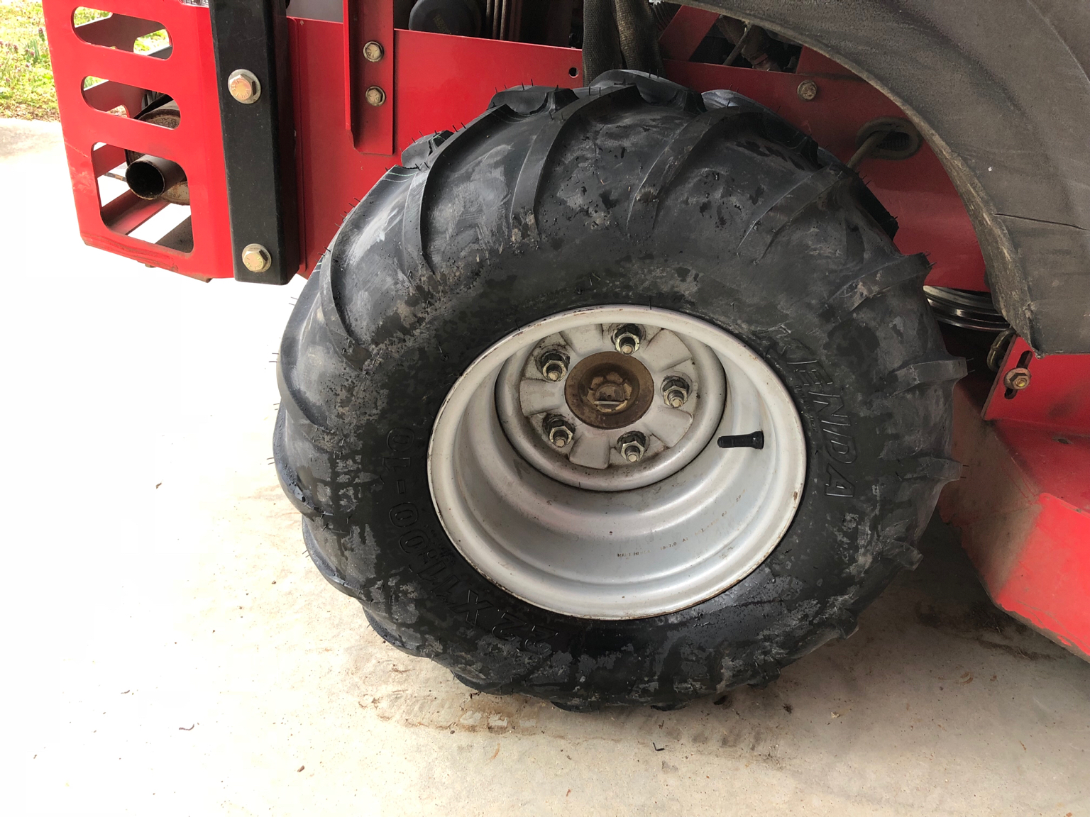

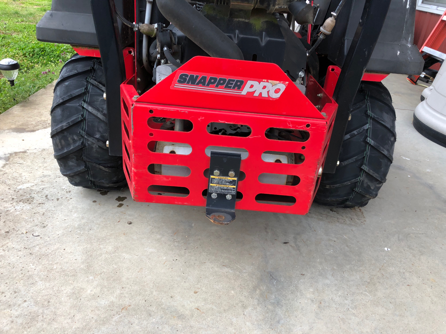

/ Zero Turn Rear Tire Suggestions #29
The turf tires on my zero turn were terrible on our hills.
I replaced them with Chevron AT 101 bar tires (I run 8 PSI in the zero turn tires)
Made a massive difference. The same hills that were always a problem (and dangerous) to mow with the turfs are no problem at all now
