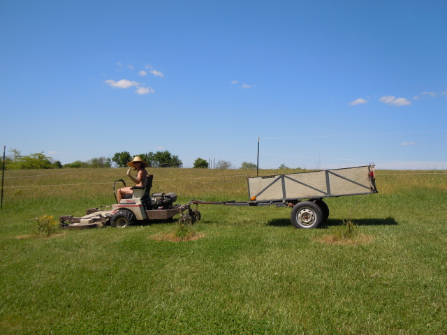

Not all ZT are created equal. We have front mounted Grasshopper that would run circles around a tractor on flat and especially on slopes. It can be run full speed on slopes where tractor can't operate at all. If you have to move around obstacles such as trees the advantage of ZT is even more pronounced. I put hitch ball on the back of the mower and can pull quite heavy trailer. So I am guessing it will pull a roller or an aerator too. We have high traction tires on ours.
