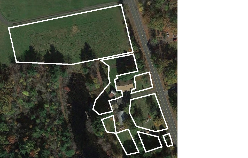

I currently mow 4 acres of lawn and field every week, and made the mistake of borrowing my father-in-law's Hustler Fastrack 54" zero turn mower. What normally takes 4.5 hours with my 46" Craftsman lawn tractor took 2 hours with the zero turn. So now I want one of my own. But which one? My budget is $3500-$4500, I know I want a ZTR with a 52"-61" deck , serviceable ZT2800 or ZT3100 transmissions, a nice cut and one that is reliable and will last 10-15 years based on 60 hours of mowing a year. I like the idea of a 60-61" mower, any issues with a larger deck? I had no issues with the Hustler 54" deck scalping etc. No gates and space between trees no issue either.
Based on the dealers near me and my budget of $3500-$4500, I have narrowed it down to the following models:
1. Hustler Raptor SD 54 - $3800 - ZT2800, 25 hp Kohler 7000 engine, 54" deck, 20" / 13" wheels, 3 year warranty, 650 lbs, 3 gal gas tank
2. Hustler Raptor SD 60 - $4300 - ZT2800, 26 hp Kohler 7000 engine, 60" deck, 20" / 13" wheels, 3 year warranty, 685 lbs, 3 gal gas tank
3. Husqvarna MZ52LE - $4400 - ZT3100, 23 hp Kawasaki FR engine, 52" deck, 22" / 13" wheels, 3 year warranty, 740 lbs, 5 gal gas tank
4. Husqvarna MZ61 - $4700 - ZT3100, 27 hp Briggs Endurance engine, 61" deck, 22" / 13" wheels, 3 year warranty, 770 lbs, 5 gal gas tank
5. Scag Liberty Z - $4400 - ZT2800, 24 hp Kohler 7000 engine, 52" deck, 20" / 11" wheels, 5 year warranty, 640 lbs, 5.5 gal gas tank
6. Simplicity Courier - $4000 - ZT2800, 25 hp Briggs engine, 52" deck, 20" / 11" wheels, 3 year warranty, ??? lbs, 3 gal gas tank, built in suspension and cargo bed
The lawn is one 2 acres field, and then 2 acres broken into small parcels due to driveway, trees, buildings etc. Mostly level, with some slight grades. Lawn is decently smooth, field is a bit rougher, but I plan to smooth out the field in the next year so I can mow at full speed. See below.
Looking for expert advice. All seem to be decent machines, but looking for something that would make one better than the others. Increasing the budget is not really an option, and I want a local servicing dealer, so that ruled out Bad Boy, Cub Cadet, Gravely, Ferris, Dixie Chopper, Grasshopper and others.
