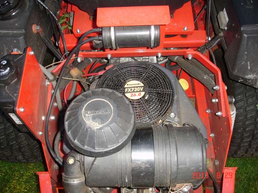

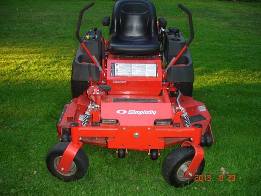

I saw Simplicity was mentioned along with Ferris. The current Citation in the Simplicity line is the same as the Ferris IS 700Z with the 52 deck but with the Kawasaki FX engine and headlights as standard (or for a little less a Briggs engine). I purchased this OTD for $6870. last year.
I also got the mulch kit (which I had on two other z turns and keeps me dust free) and some after market wave mulching blades. Yes, I did take off the ROPS, IMO it is more dangerous with it on overall with a z-turn. I am very happy with it and the ride. The Simplicity top of the line is the Cobalt which is like the Ferris 2100Z with a 60 deck and it is around 10k.
The older Simplicity Citations were like the current Ferris IS600Z (similar to the current Simplicity ZT3500 or the new Champion XT, both for less $), but I think they wanted to give the Simplicity dealers a couple more commercial models the same as Ferris for their sales. Hence the Kawasaki FX engine options etc. The dealer said they come off the same production line and if you compare them they are exactly the same except for paint, decals, lights and engine options on these two models. Check out the websites.
I think it was Simplicity that bought Ferris ( or visa versa) and in turn they both wound up bought by Briggs.
Ferris does offer many more models and commercial options beyond Simplicity. But the prices go up accordingly.
I had a Simplicity Champion (now they also have a Champion XT with fab deck) that I sold. I was happy with it, ran and cut great, but went from mowing a couple acres to 10-12 acres a week and that would have been to much for it.
Anyway, I just thought I would throw this in as part of the Ferris/Simplicity discussion that occasionally comes up.
