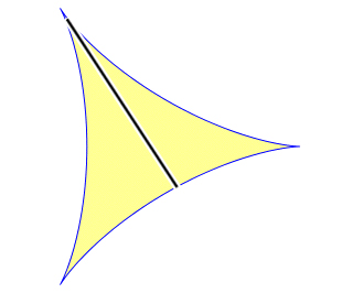

FWIW, when I mow, I generally try to mow long lines or rows, alternating directions - up in one direction, and then 180 degrees and back down in the other. For the most part, I try not to mow squares, circles, rectangles ... or any other geometric form ... other than just lines or rows. And I'm lucky because my yards are (mostly) suited to it.
My front yards (2, about 3 acres total) are mowed with a 72" MMM (Kubota B2910 with R4 tires, probably 1500 lbs or so) ... and my side and rear yards (1 acre total) are mowed with the Simplicity ZTR ....
Executing a tight, extended turn, at any kind of (decent) speed, with either unit, will rip up the grass - absolutely without fail.
Therefore I practice what might be called a 3-point turn: when coming to the end of a line or row, I turn to the left or right, stop, and turn (while backing up), stop again, and then turn (while proceeding forward) - executing a 180 degree turn.
The turn, if viewed from above, would look like a concave equilateral triangle (see attached image, and ignore black line thru center), where you were initially coming down into one of the points, and then once turned (after having backed up), exited out the same point, in the opposite direction.
With a hydrostatic transmission and a treadle pedal, it's a piece of cake.
This doesn't necessarily apply to your specific dilemma cutting around your ornamentals, but I include it for others as a workable technique to avoid tearing up the grass.
