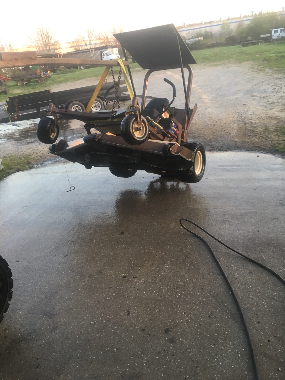

That is the one thing I would never use. I have seen too many of those things slip and fall. I will stick with my FEL, much less likely to have a mishap with a chain attachment.

The high lift jack should come with a coffin. Working under one of those things is insane. I agree that the forklift or FEL is safer by a long shot. I’d also say the forklift is safer than the little dinky mower jacks. I’m using a forklift rated very conservatively to lift 5,000 pounds and the front of my mower might weigh 500 pounds. The mower jack is pretty much working at its design limits.

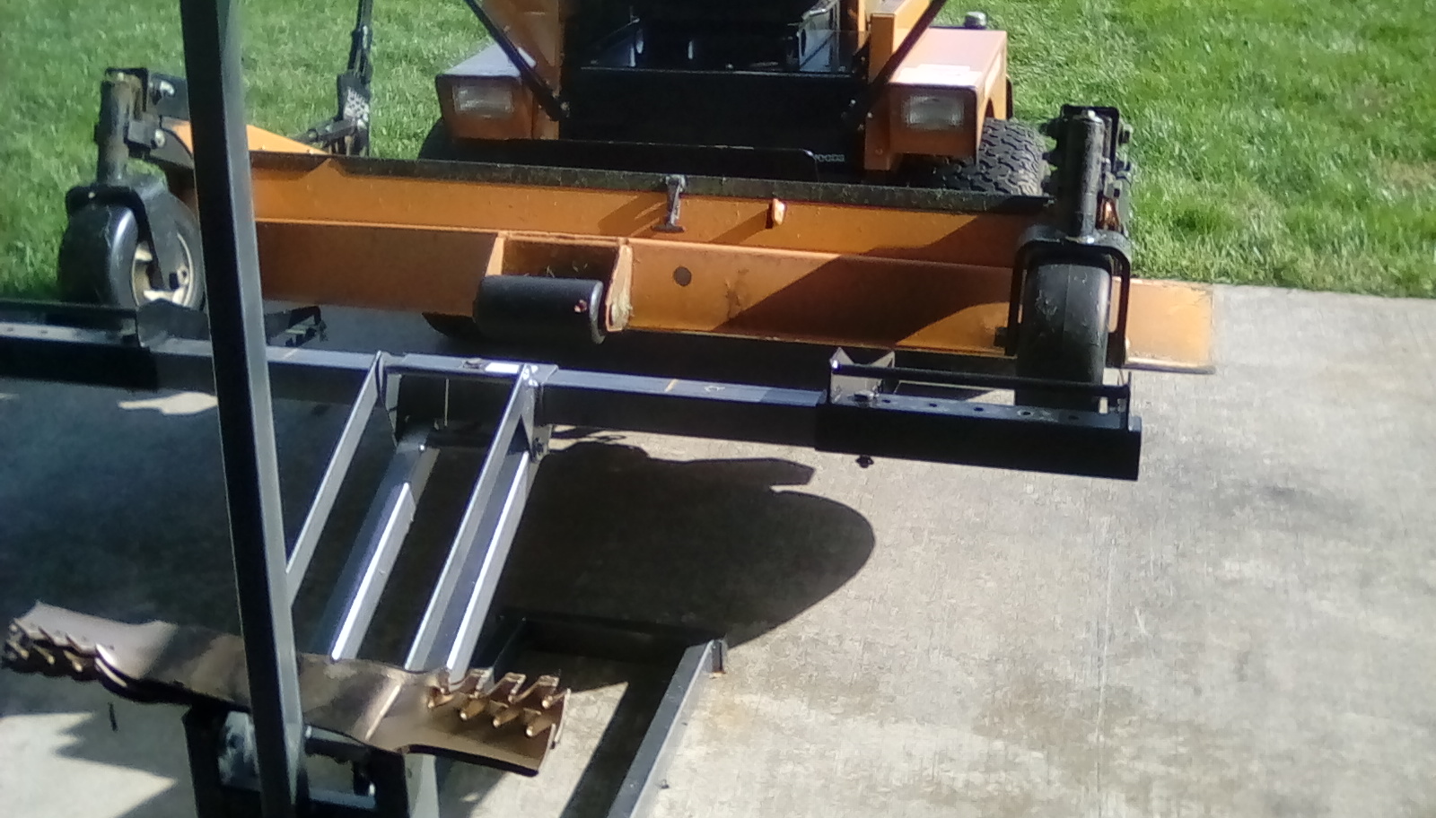

Here's what I use.
I started off with TSC bargain basement model but graduated to this model.
I find it much more stable and easier to lift with the foot operated bottle jack.
Plus Amazon dropped it off at my door.
Amazon.com: Pro-Lift T-5355A Lawn Mower Lift: Automotive
That looks like the one I use. I feel safe when I'm under the deck, love the locking bars to back up the hydraulic.
These things take up alot of space and I hate stuff cluttering the floor so I like to hang as much as possible on the walls. By the time I no longer want to wrestle this 90 lb. beast, I'll trade in for a unit with an electric lift deck.
