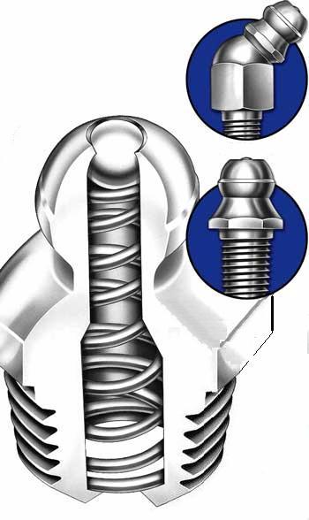

I have a flail mower -- three or four years old -- and one of the rotor grease fittings will not accept grease. After I pump the grease gun a few times and remove from the zerk, the grease comes shooting back out -- like from a can of cheese-whiz.
I removed the zerk and it seems okay. Any suggestions on what's going on? The rotor spins fine and the mower continues to cut nicely.
   / Zerk Spits Out Grease #3
Yes, put on a new zerk. Old one has been damaged and is not sealing properly. Like katoomed00 said.............
   / Zerk Spits Out Grease #4
Heres a cutaway drawing of a grease zerk ball check.
   / Zerk Spits Out Grease #5
Sometimes you can free it up. I hate replacing zerks- always stripping one, getting the wrong size - etc.
Confirming problem was the zerk. I couldn't locate a 6mm metric replacement so I traded zerk with another on the mower and greased the rotor bearing. I will order a replacement now. Thanks all!
