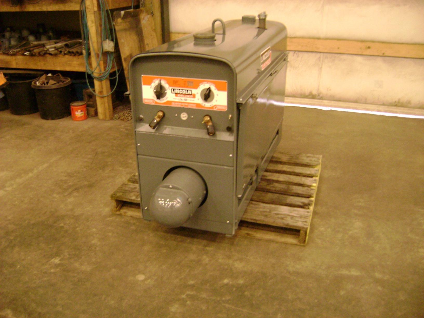

If he has got the cash, he could get a lincoln classic 300D. It uses the same style head as the SA-200, so I bet it has a real nice arc. I would rather have a redface SA-200 though.
/ ZENA welding system.
#14
You should have seen the look on his face when I told him I paid $200.00 for this old thing. :laughing:
Take three hunnerd for it? Just trying to help you out! :thumbsup:
He can check welding forums for examples of current pipeline rig trucks.
/ ZENA welding system. #17
Who pays shipping?
Location? Condition? That's mighty cheep and I LIKE mighty cheep.
I was joking but if it's near to "middle South Carolina" then I ain't joking. SAs are nice machines and worth more than that most anywhere. I'd keep it since I've always wanted one. I'm primarily a mechanic (and retired) but life is too short not to use professional equipment.
If it's too far for me (I'm a cheap ba$tid) to drive you could throw it up on Weldingweb etc and likely move it quickly for much more money.
If your bud wants to hit the oil patch he needs to hand you da money "yesterday" and get it set up to work. That's a "core price" for sure and he could have a nice machine for a modest investment (especially since he's got a lot more stuff to buy if he wants to rig weld!).
A Zena isn't remotely an alternative to an SA and he'd likely get laughed off the jobsite instantly.
