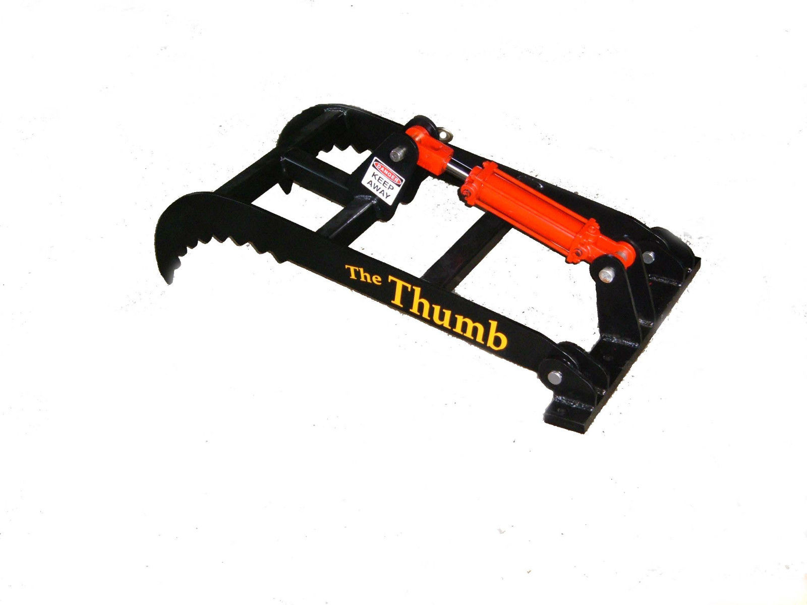

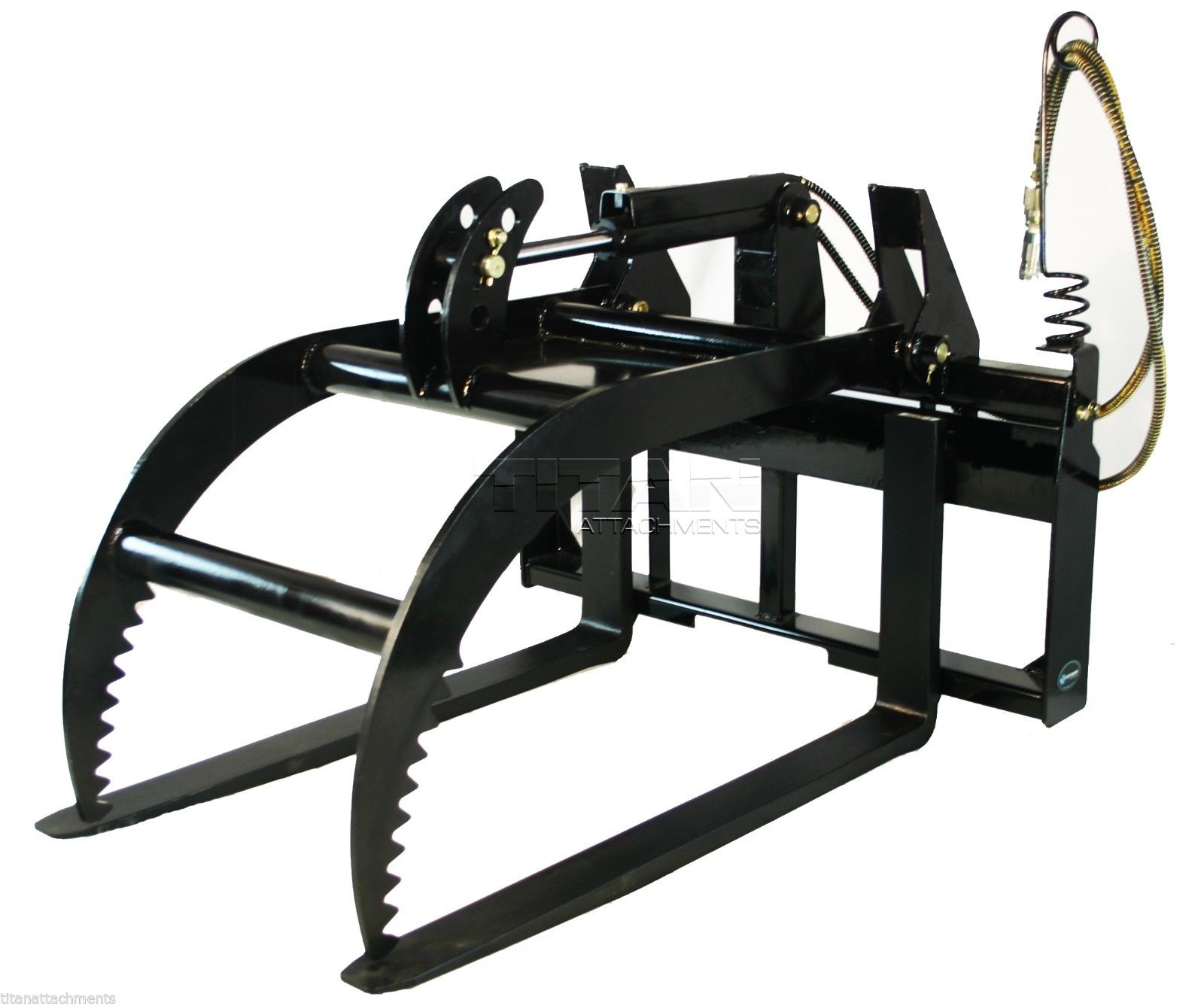

Here's what you need. A set of forks with grapple. Titan Attachments sells them as do other companies. About $1225. for 42" forks w/ grapple but serves 2 purposes. I just bought a set of regular QA skid steer style forks and think I'm going to buy a separate thumb (pictured) to attach to either my bucket or forks. Buying my forks and thumb separately costs less than the grapple forks.

George, I've been contemplating grapple forks a lot lately. I would buy a set of SSQA 48" forks for my tractor and then build a thumb (most likely) that attaches to them and comes off with ease for when I don't need the grapple function. I also thought about buying an extra set of fork blades for it and running with 3 or 4 fork blades on the pallet fork grapple setup so it's as close to a brush grapple as I can get without buying a completely separate attachment (that I will buy eventually). I need forks soon, so modifying them to grapple only make sense.
/ Yup, another pallet fork thread by a newb :-) #12
I couldn't justify the combo grapple / forks (even though I think it a great price) setup due to I don't have enough uses right now but I did buy the QA forks. For about $400 or so I can get the thumb when I need it and attach it to the forks. Then I could make a second mount plate and attach to the bucket. Once that's done I could switch the grapple between the forks and bucket as needed. Maybe this will give the OP some ideas. My total cost for forks and thumb would be under 1K by doing it myself. Others may not want to be bothered fabbing it themselves for the couple hundred difference. Just an FYI the 48" grapple forks are $1275. from Titan.
