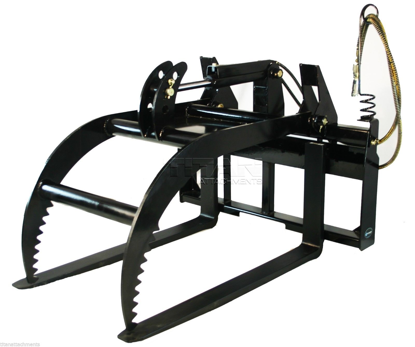

I hope the forks are adjustable so the grapple can bypass them, and the grapple will move down much farther, otherwise you can't grab a small brush load or single log.

Naw, I left your name out of the discussion. Realistically the grapple isn't going to happen, in fact I think I got laughed at when I mentioned it earlier today.
Very often us TBN'ers gradually force mission creep on posters. We are REAL good at spending other peoples money
LOL, I'm pretty good at mission creep by myself without any encouragement. In all honesty we have 10 acres and the 3 acres that are cleared were well cared for by the previous owners. While I'd like to be able to justify a grapple I really can't for the work I need to accomplish. Besides we're in the process of fencing about 1/2 acre (3 board, vinyl coated wire, 4x6 post) as kid and dog containment. Between that and the little golden retriever girl we have coming in a month or so we're kinda tapped on grand and above level expenditures.

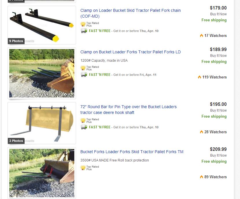

here is a link to some inexpensive ones.
bucket forks | eBay
Ive also seen a thread here somewhere with some home made ones and some from basic 2x4 s that would possibly work.
Thanks for the link. I'm not quite sure ebay is on the same page with what bucket forks are.... When I clicked on your link this is the first item that came up :confused3: :p
I'm guessing you were trying to point me towards the clamp on forks, that run around $170.00. I have seen the wood pallet forks you are talking about. I think the idea is really cool, and applaud the ingenuity but in truth if I am going to go through with getting forks I think I need something that will last in the long term.

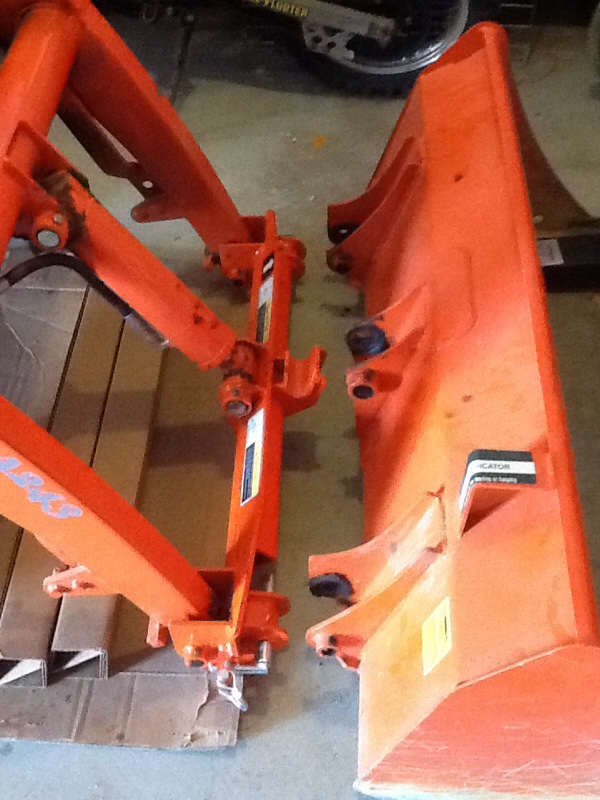

In truth I don't mind the 300.00 for Kubota's QA plate/bar. As far as I understand it attaches to the loader arms and works with the existing pin positions of Kubota buckets so no welding mods are necessary. And I believe there are aftermarket grapples that work with this configuration

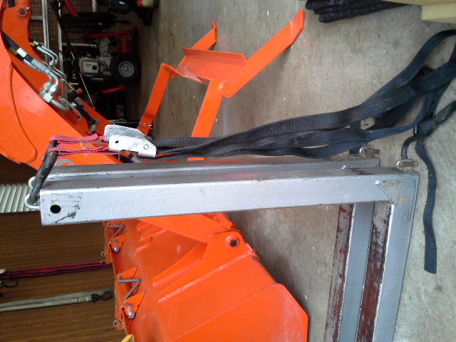

I welded one link of chain on the bottom of my bxpanded forks. I run a tie down from there around the bucket and to the one at the top that comes on them. They are sturdy, I have used them to hook a chain on to pull tractor out when stuck.

TJbeck93 - Thanks for the pictures, especially of the clamping mechanism. I like your idea of welding a link on the forks - I'm going to have to bribe my neighbor into a a wee bit of welding.

3) Would you be willing to provide a width measurement for the clamps? My reason for asking is that one of my bucket hooks is attached just to the inside of the level indicator and I would like to know how much that will offset my placement of the forks.
The clamps are approximately 7 wide. The outside edge of the fork would be about 3 from the hook. The bracket will fit outboard of the level indicator.
4) I know of one gentleman who had issues with Kubota having changed the bucket lip design on his bx25 and as a result you were gracious enough to work with him on providing a solution. Is there a way to determine in advance if this is going to be an issue? Or have you been able to make adjustments to your clamps so that Kubota's changes are not problematic?
The bucket aberrations have not shown up on any of the BXs except the BX25. It shouldn't be an issue on the BX2350.
