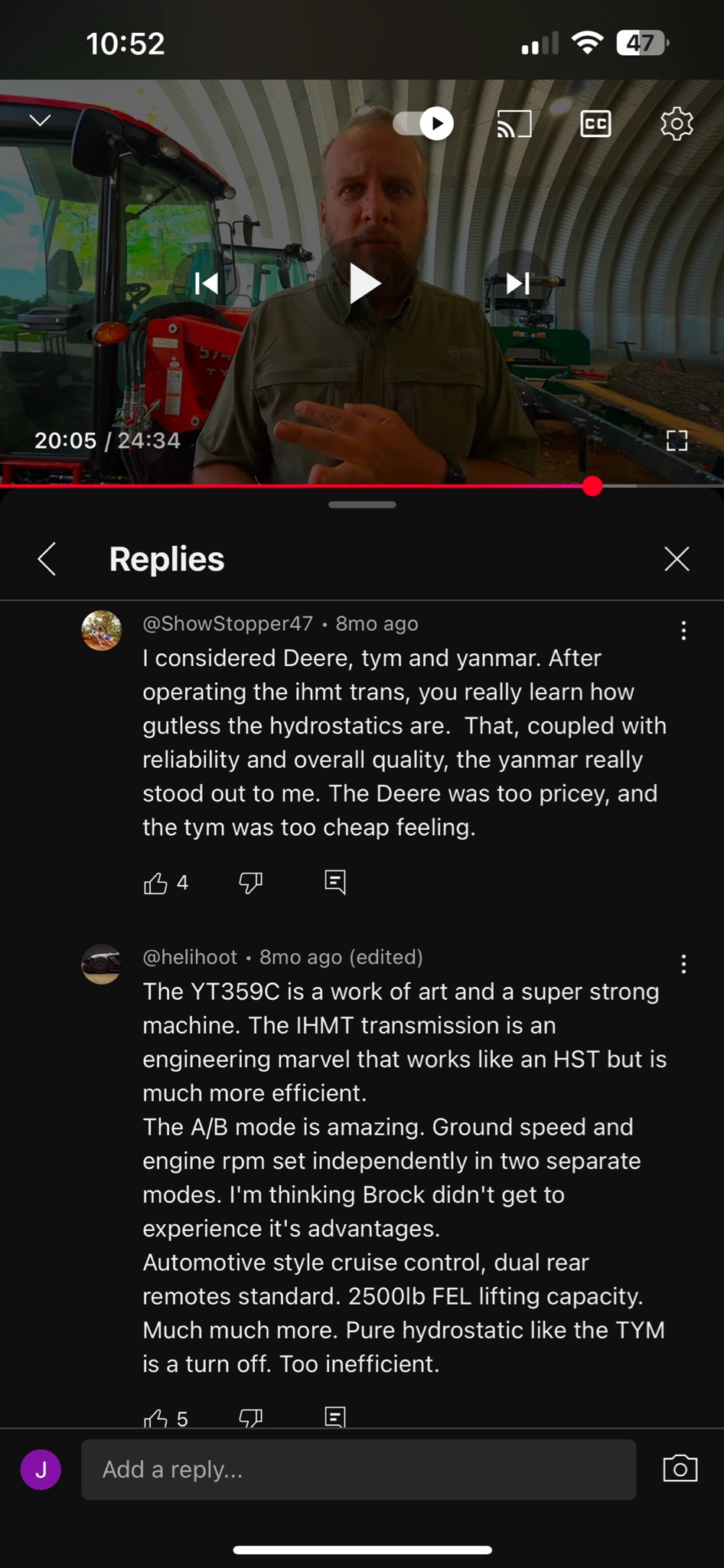

A couple screen shots of comments from the video link below:

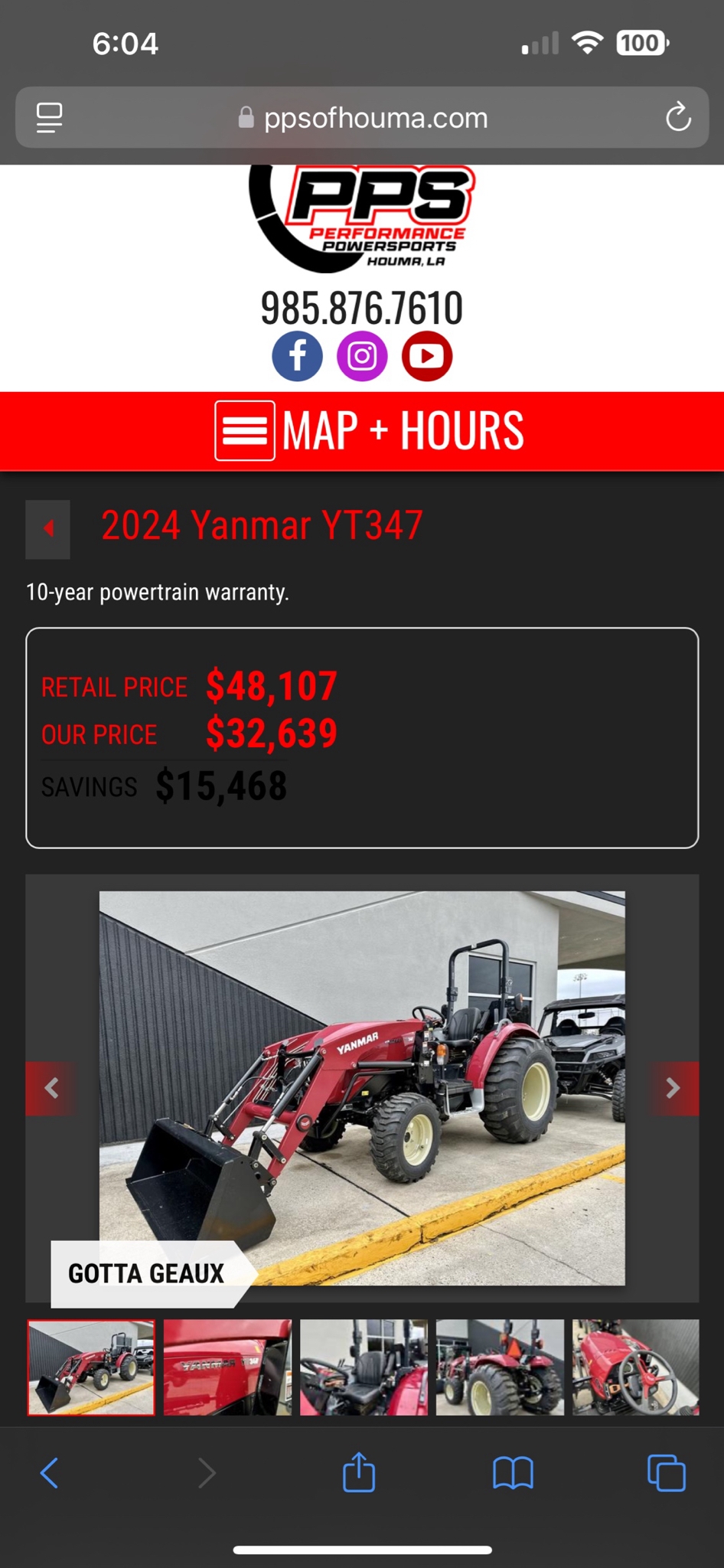

Here’s a YT[emoji[emoji6]] for sale in Louisiana for $K. Whoever quoted you $[emoji6]K is on crack.
