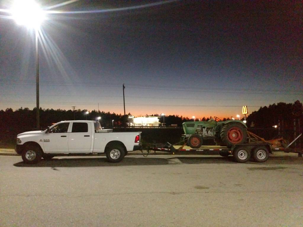

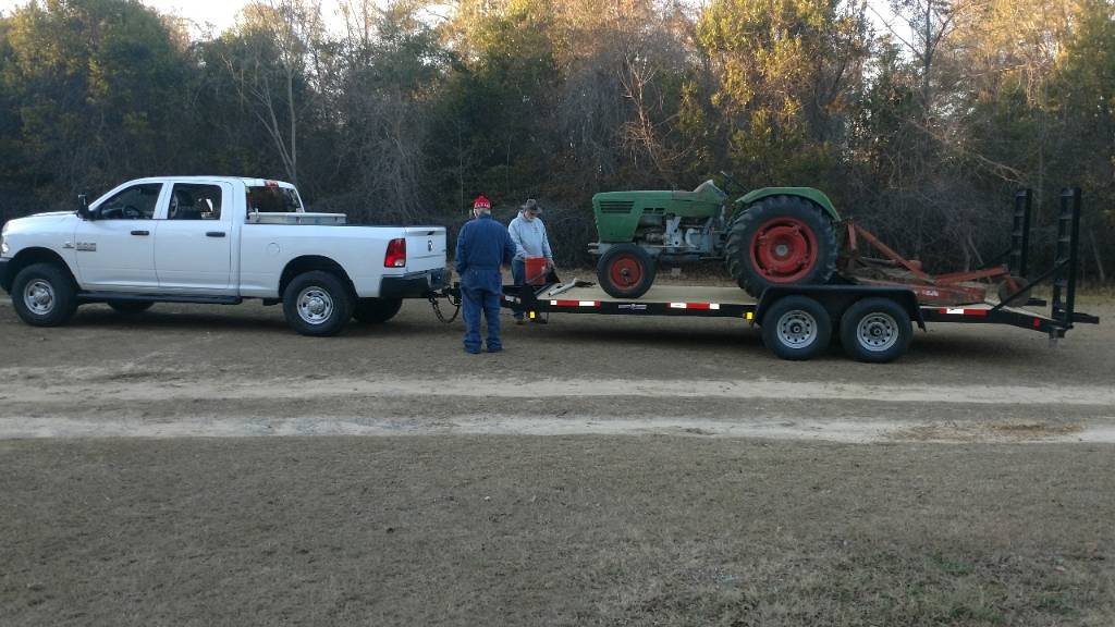

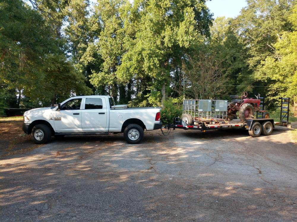

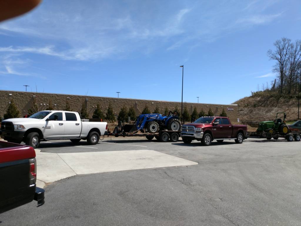

The truck is a 2016 Ram 2500 with a Cummins turbo diesel. I have about 40,000 miles on it running 34s. The trailer that I use most often is a 20-foot currahee utility trailer. The trailer being so long pulls terrible when empty however when it has a load on it and it has brakes on all wheels it tows like a dream. Also with that Cummins engine going up and down mountains in North Carolina and having that wonderful exhaust brake ain't no issue. IMG_20180331_123624627.jpegScreenshot_20180117-201130.jpegIMG_20180113_181849972_BURST001.jpegIMG_20180825_180538594_HDR.jpeg
