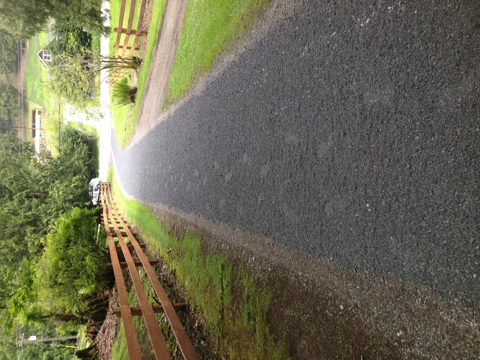

View attachment 529632One more photo. The trailer has a adjustable dump gate that can spread gravel amazingly even. I was giddy while pouring my driveway. Sorry the image is sideways. I don't know how to rotate it in the post.
It is topside up when opened in a new tab. :thumbsup:
Looks like a carpet...
Had a great Mom and Pop with dump truck company... I would call and he would tailgate spread to perfection... sadly, he passed away and never have found anyone near as good...
