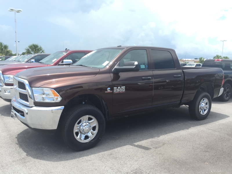

Here's my new truck that I picked up a few weeks ago. New 2015 Cummins 2500 Tradesman package. Took it on a road trip last week and averaged about 19 mpg so I'm very happy.

Very nice, I have been looking at the same truck. I would be very interested in a follow up a little later on.

Definitely will. So far I have been very impressed with it and have towed my tractor only a short distance to a friends house. Unloaded at 75ish I can get about 18.5 and if I'm down to 65 I'll be about 19-19.5.
